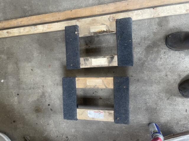

AHS 1,566 #10 Posted February 26, 2024 Ok. These should help. One at the bottom of each tire and a strap. They’re supposed to support 1k lbs… we shall see!! 2 Share this post Link to post Share on other sites
AHS 1,566 #11 Posted February 26, 2024 (At the sellers house) At the end of this week ill go and pick up the 518 and the 520. The 518 is 10’ from the driveway. The 520 is right at the edge of the driveway. I was thinking, IF the e brakes work, then we’ll just put the brake on and slide it across the snow? Easy, right!! 2 Share this post Link to post Share on other sites
