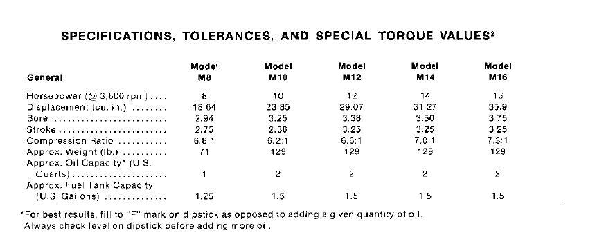

Brockport Bill 2,553 #3 Posted February 26, 2024 7 minutes ago, oliver2-44 said: I have previously lifted complete 12-16 hp Kohlers by myself. Not the best idea as they are really to heavy for one person. I like to pull the flywheel and that sure seems to make them a little more manageable. A ceiling lifting trolley is in my shops future. what's your guess ?? 75-100 lbs? Share this post Link to post Share on other sites
kpinnc 19,107 #4 Posted February 26, 2024 (edited) A big block kohler is well over 100lbs. Small blocks are over 70. K301 claimed weight is 118lbs. K341 claimed weight is 122lbs. Oil pan types, etc make quite a difference. If it has a starter/ generator, add about 30lbs... There was a time that I could throw one around with ease. Those days are long gone. Removing the flywheel definitely makes a difference. Edited February 26, 2024 by kpinnc 3 Share this post Link to post Share on other sites
Brockport Bill 2,553 #5 Posted February 26, 2024 1 hour ago, kpinnc said: A big block kohler is well over 100lbs. Small blocks are over 70. K301 claimed weight is 118lbs. K341 claimed weight is 122lbs. Oil pan types, etc make quite a difference. If it has a starter/ generator, add about 30lbs... There was a time that I could throw one around with ease. Those days are long gone. Removing the flywheel definitely makes a difference. UGH !! - perhaps in my college wrestling days that was typical weight room practice workout - but no longer - my lumbar wouldn't like that !! ------ -- ( by the way, it would be a Kohler 12 Magnum on my 312-8 ) ---- Thanks for info - Bill 1 Share this post Link to post Share on other sites
ebinmaine 81,282 #6 Posted February 26, 2024 2 hours ago, kpinnc said: K341 claimed weight is 122lbs. The one on my C160 Cinnamon Horse is 128 lbs with all sheet metal, carb, starter etc. Either Trina or I CAN lift one but we don't anymore. We either team up or use the chain falls. 1 Share this post Link to post Share on other sites

Racinbob 13,290 #9 Posted February 26, 2024 The big blocks are about 120# and the small blocks about 65#. I gave up on lifting a big one a long time ago. 3 Share this post Link to post Share on other sites
pfrederi 21,342 #10 Posted February 26, 2024 M12 approx 129lbs Or just pick up the whole tractor 6 2 Share this post Link to post Share on other sites
