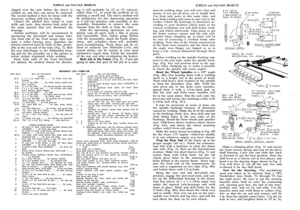

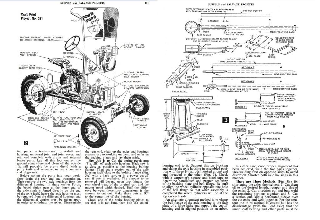

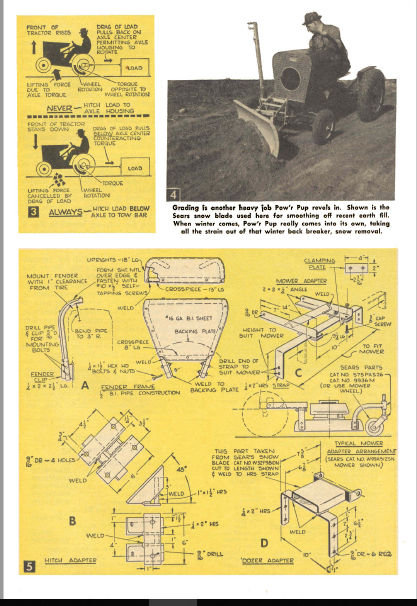

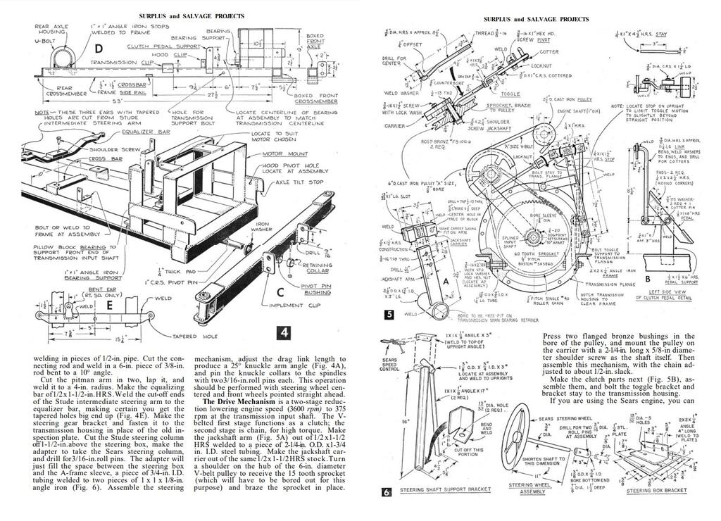

953 nut 70,662 #1 Posted February 25, 2024 Pow’R Pup My father subscribed to several magazines while I was growing up. Mechanix Illustrated, Popular Mechanics, and Science and Mechanics were my favorites. Their pages were full of wonderful projects and ideas that stimulated a young boys mind. I can recall several “You Can Build This” articles that were so intriguing that they have stuck with me for sixty years or longer. One of them was the “Pow’R Pup Suburban”, a small garden tractor that could be built from salvaged auto parts which were readily available at very low costs at the time. The article appeared in the August 1961 edition of Science & Mechanics and gave an overview of the project with a full set of detailed drawings available for $ 10.00. I didn’t buy the set of plans, wish I had, but the article stuck with me. It might cost a bit more than $ 175.00 to build the Pow’R Pup today. If you happen to have a 1932 to 1948 Ford transmission and rearend hanging around as well as a 1951 to 1953 Studebaker steering gear and related components you are off to a good start. The price of machining of various parts has probably gone up too. I doubt that an old Ford axle could be shortened, threaded and a keyway cut for $ 10.50 anymore. Nonetheless it is fun to look at these old magazine projects and remember what it was like to be a kid. Here are some pages from the article. 6 5 2 1 Share this post Link to post Share on other sites

ri702bill 13,398 #7 Posted February 25, 2024 8 hours ago, 953 nut said: The price of machining of various parts has probably gone up too. I doubt that an old Ford axle could be shortened, threaded and a keyway cut for $ 10.50 anymore. I could not buy even the fasteners for that price !! 1 Share this post Link to post Share on other sites
