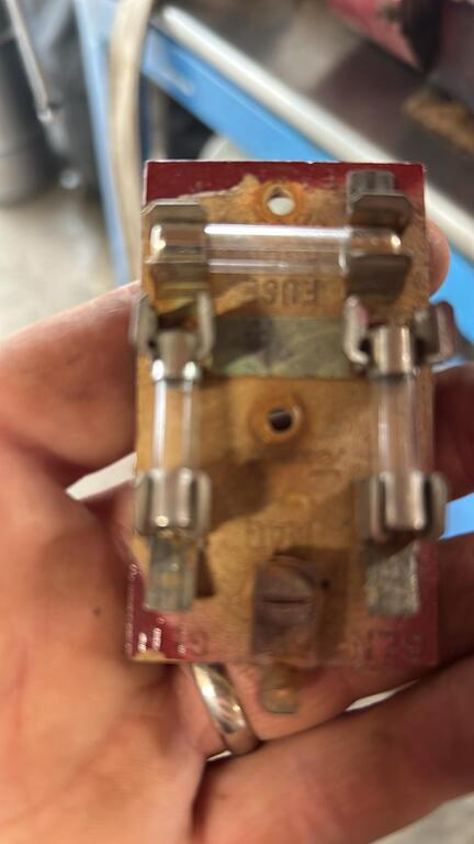

DPrice 24 #1 Posted February 24, 2024 Bought this cheap enough not sure what it's off of. The one I'm working on used part # 30841 this one is laid out the same but a little different Share this post Link to post Share on other sites
wallfish 20,382 #2 Posted February 24, 2024 Yes, it can be used for a Wheel Horse engine. The part is not necessarily WH it's Lauson/Tecumseh engine part. The 2 vertical fuses on that board should be diodes, not glass fuses. The diodes are used so it works as a rectifier to charge the battery. The fuses on it won't allow it to work the same as it should. It's a 3 amp unregulated charge system. Common on the early H55 and H60 engines. Probably others a s well 5 1 Share this post Link to post Share on other sites
