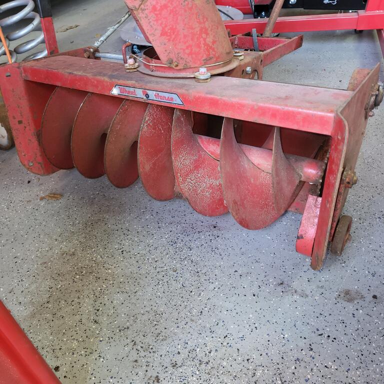

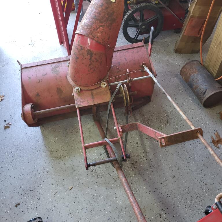

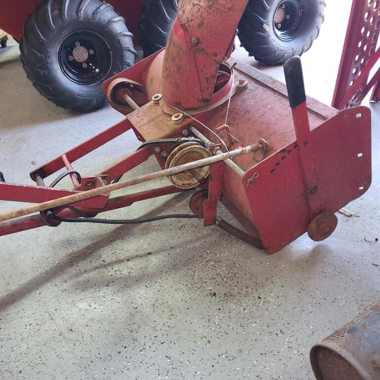

loudtractor 50 #5 Posted February 21, 2024 Thanks! Exactly what I was looking for. I have one here with no ID or stickers. It has , or is supposed to have, a control rod next to the chute control. Am I correct in thinking this is for an older short frame? It has wheels, and holes for side angle plates, 32" I think. I'll put a picture up later today Thanks Matt Share this post Link to post Share on other sites
loudtractor 50 #6 Posted February 21, 2024 Here's a picture, any help with id or which tractor it fits would be awesome. Thanks! Matt Share this post Link to post Share on other sites
gwest_ca-(File Mod) 12,557 #7 Posted February 21, 2024 Here is a list of the 32" models. The first 42" list is better suited to your tractor. 32" Snowthrower DNA - For tractors with horizontal shaft engines 1963 model ST-323 - Fits 701, 502, 552, 702, 603, 653, 753, 604 (Drive belt 1589 1/2" x 56.5") (Chute turned by belt 1590 3/8" x 43") 1964 model ST-324 - Fits 701, 502, 552, 702, 603, 633, 653, 753, 604, 654, 704, 854, 605, 655, 855 (Uses # 41 chain Pitch 1/2" and roller width 1/4") (Drive belt 1589 1/2" x 56.5") (First model to use cable on the chute) 1965 model ST-325 - Fits 701, 502, 552, 702, 603, 633, 653, 753, 604, 654, 704, 854, 605, 655, 855, 1045, 1055 (Uses # 41 chain Pitch 1/2" and roller width 1/4") (Drive belt 1589 1/2" x 56.5") 1966-1967 model ST-326 - Fits 701, 502, 552, 702, 603, 633, 653, 753, 604, 654, 704, 854, 605, 655, 855, 1045, 1055, 606, 656, 856, 876, 607, 657, 857, 867, 877 (Uses # 41 chain Pitch 1/2" and roller width 1/4") (Drive belt 1589 1/2" x 56.5") 1968-1969 model 6-2211 - Fits 500 Special, Commando 6, Commando 8, WorkHorse 700 (Formerly ST-326) (Uses # 41 chain Pitch 1/2" and roller width 1/4") (Drive belt 1589 1/2" x 56.5") 1971 model 6-0100 - Fits 800 Automatic, 800 Special, Bronco 14, Charger 12, Raider 10, Raider 12, WorkHorse 800 (No record of 6-0100 at Toro. Suspect it was same as 6-0200 plus 6-9112 in one package) (Uses # 40 chain Pitch 1/2" and roller width 5/16") (Uses #101460 lift tube and #9750 5/8" x 69" belt) 1972 model 6-0200 plus 6-9112 - Fits Commando 800 (Uses # 40 chain Pitch 1/2" and roller width 5/16") (Uses #102729 lift tube and #102743 5/8" x 65.95" belt) 1972 model 6-0200 plus 6-9112 - Fits 800 Automatic, Bronco 14, Charger 10, Charger 12, Raider 8, Raider 10, Raider 12, Raider 14 (Uses # 40 chain Pitch 1/2" and roller width 5/16") (Uses #101460 lift tube and #9750 5/8" x 69" belt) 1973 model 6-0200 plus 6-9131 - Fits 8hp 4-Speed (Uses # 40 chain Pitch 1/2" and roller width 5/16") (Use #102729 lift tube and #102743 5/8" x 65.95" belt) 1 Share this post Link to post Share on other sites
loudtractor 50 #8 Posted February 21, 2024 That's a great list! I do have a freshly restored 856. It looks like it might fit this one. I'm going to keep looking for one to fit the C120, now that I have a better idea what to look for.. Thanks! Matt Share this post Link to post Share on other sites
Pullstart 71,564 #9 Posted February 21, 2024 I see a beach ball @WHX??. Is that a 6x6 in the background? 1 Share this post Link to post Share on other sites
loudtractor 50 #10 Posted February 21, 2024 Yes sir. 1968 Amphicat. Restoration almost complete. Share this post Link to post Share on other sites
