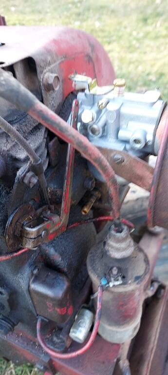

Jason Miller 24 #27 Posted February 28, 2024 Not clear but connects the throttle and the idle.on top of carburetor Share this post Link to post Share on other sites
pfrederi 21,344 #28 Posted February 28, 2024 I always wind up taking the carb off. or you can remove the governor arm but then you have to check the adjustment per the manual. 1 Share this post Link to post Share on other sites
Jason Miller 24 #29 Posted February 28, 2024 Thanks so much. Share this post Link to post Share on other sites
RED-Z06 2,720 #30 Posted February 28, 2024 I usually pop the governor arm off, ive reset them so many times it nothing, but you slip it on, hold the carb to wide open, then turn the little shaft in the center counter clockwise til it stops, then while still holding the carb wide open, tighten the pinch nut down. 1 Share this post Link to post Share on other sites

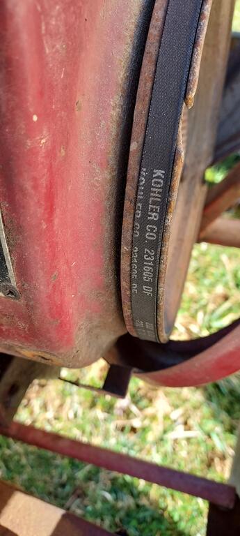

Jason Miller 24 #31 Posted February 29, 2024 Hey guys got it on amd it works great!! Question i need a belt. Here it is tried to look it up and can't find replacement. Looks like belt small on side. I need to replace drive belt as well but it has no numbers. For.my 856 Share this post Link to post Share on other sites
953 nut 70,661 #32 Posted February 29, 2024 The drive belt for your 856 is Wheel Horse # 8005 which is a 4L-720, a 72" long by 1/2" wide fabric covered belt. A Tractor Supply 1/2 X 72 will work fine. Your Starter/Generator belt should ba a cogger rubber edged 3/8" by 32" belt. NAPA 25-7320 should be the one. Share this post Link to post Share on other sites
