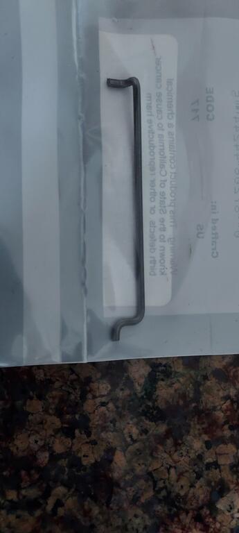

Jason Miller 24 #8 Posted February 20, 2024 Another thing when I took old carb off I lost the piece that connects throttle to carb. Little z wire connector so had to order one if these. Not a good day Share this post Link to post Share on other sites

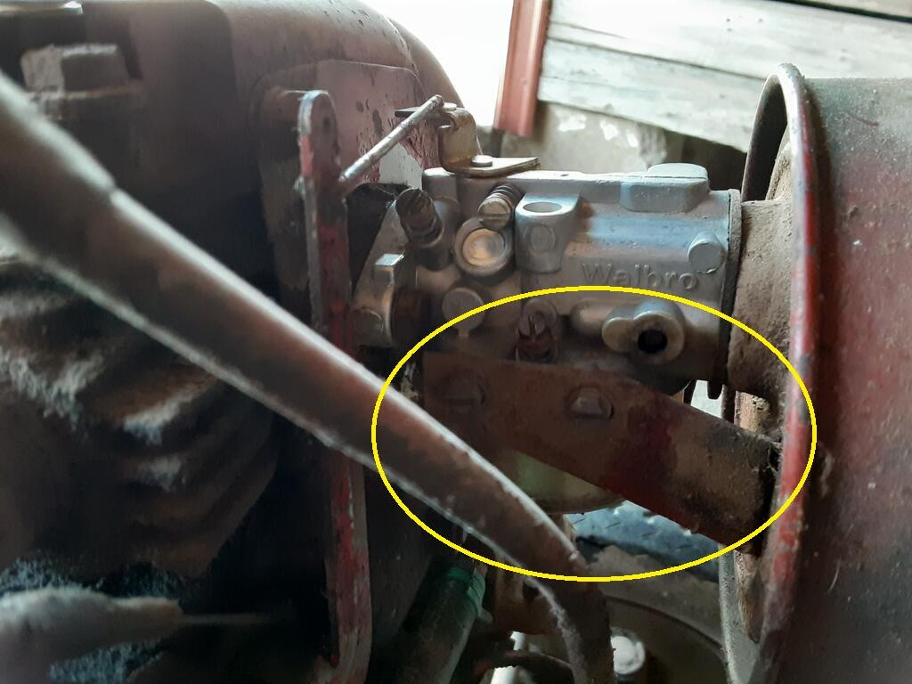

RED-Z06 2,718 #15 Posted February 20, 2024 That filter housing to carb mount seems kinda funky Share this post Link to post Share on other sites
wallfish 20,031 #16 Posted February 21, 2024 2 hours ago, RED-Z06 said: That filter housing to carb mount seems kinda funky Are you referring to this bracket? Share this post Link to post Share on other sites
RED-Z06 2,718 #17 Posted February 21, 2024 Just now, wallfish said: Are you referring to this bracket? No, the weird placement of the housing at the throat, looks like its pitched down and sitting low. Share this post Link to post Share on other sites
Jason Miller 24 #18 Posted February 21, 2024 That’s the old carb same bracket Share this post Link to post Share on other sites

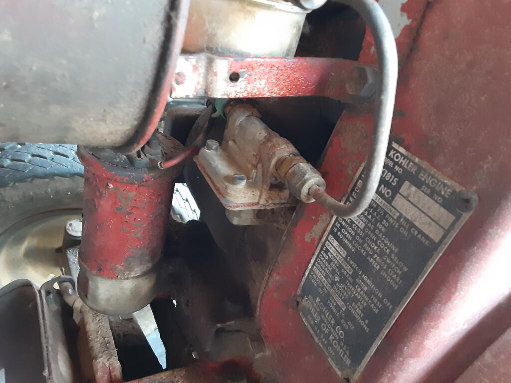

Jason Miller 24 #19 Posted February 22, 2024 Hey guys I drained the oil, put a spring on the carb like you said and put the new plug in. It fired right up! Waiting on the carb link that connects the idle to the throttle cable. 2 questions can I replace the metal gas line and 2 connectors? Looks like from the pump to the carb its a metal gas line about 6 inches? Also when is the wheelhorse show in Ardentsville PA? Can I buy a tractor there? Share this post Link to post Share on other sites

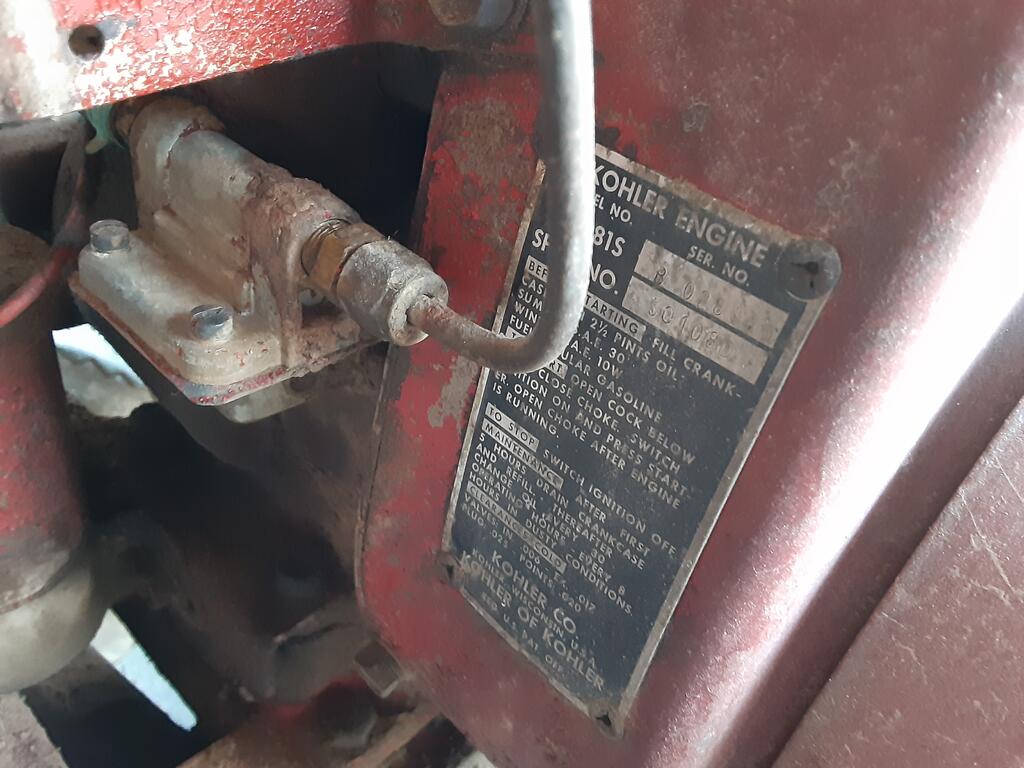

Jason Miller 24 #20 Posted February 22, 2024 This is the fuel line that needs replaced also the 2 nuts that connect it Share this post Link to post Share on other sites
RED-Z06 2,718 #22 Posted February 22, 2024 You would have to get something like steel brake line, a flairing tool, bender, ferrules and nuts. Id ne inclined to try and thread in barbed fittings and use rubber hose and clamps 1 Share this post Link to post Share on other sites

Jason Miller 24 #25 Posted February 28, 2024 What is the easiest way to put this linkage on? Share this post Link to post Share on other sites
