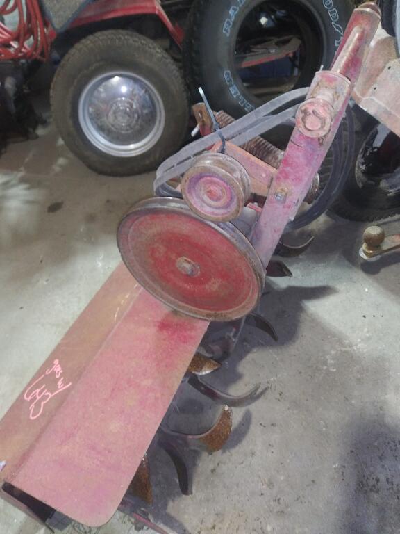

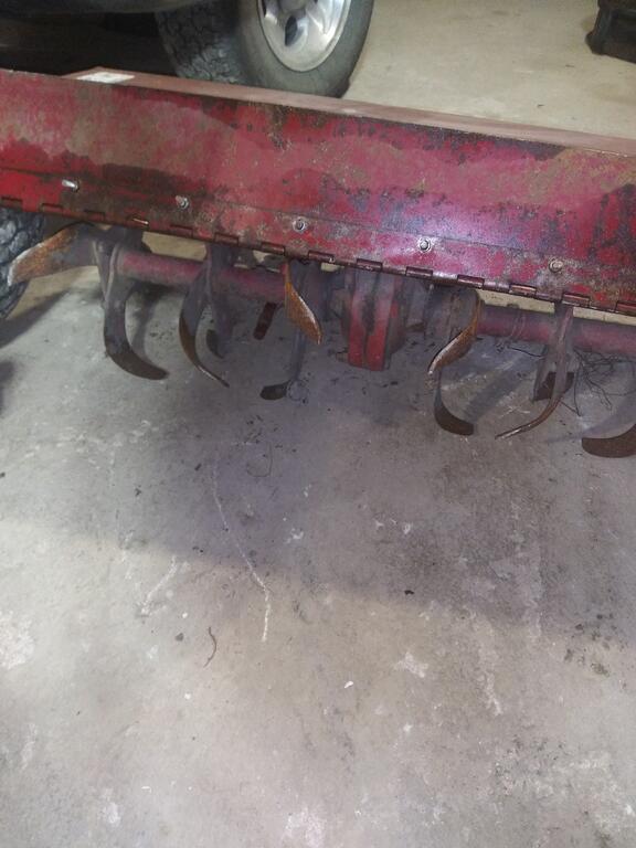

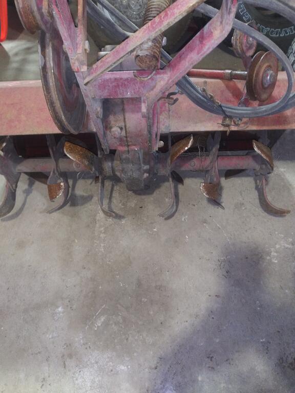

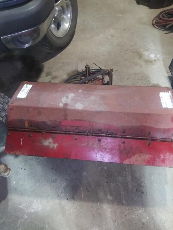

6wheeler 586 #1 Posted February 15 Hi all. I am trying to figure out which tiller I have on the Electro 12 that I picked up. I cannot find a model number on it. Is it hidden somewhere? It is a single belt system tiller and is a 36" tiller. As was stated in the WH tractors section, The tractor has the tach a matic on it so it is pretty easy to intstall the tiller. After I removed the wire that was tangled up in the tiller, it turns nice and free. I want to change oil in the gearbox. Does anyone know what weight I should use? The knives are a bit worn but I believe they will work. TIA Pat Share this post Link to post Share on other sites
c-series don 7,858 #2 Posted February 15 If you can post a picture of it we may be able to help you with a model number. Regardless of the model number it should take 80-90W Gear Oil. Probably could even use 90-120W I don’t think it would make a difference. If it leaks you may want the heavier thicker 90-120W. Share this post Link to post Share on other sites

6wheeler 586 #4 Posted February 17 Thanks for the manual. I looked at the file. But, mine has a single belt drive. I wonder if it is a newer tiller on an older tractor. I cannot find a model number on it. Here are some pictures of it. Share this post Link to post Share on other sites
6wheeler 586 #5 Posted February 17 Some more pictures. Share this post Link to post Share on other sites
