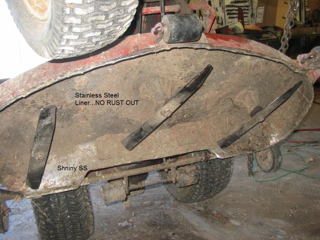

daveoman1966 3,884 #16 Posted February 14, 2024 (edited) In the mid-90s, I fashioned a Stainless Steel liner for my 48" deck. To this day...30+years hence...NO RUST. The deck shell was weakened from rust, similar to the 42" shown herein, but the STAINLESS STEEL liner I made took care of that problem. Take the spindles out and remove ALL the lift hardware---strip it to the bare shell. Make a cardboard template of the deck shell bottom side...transfer that template to cut out a SS sheet. Cut out the three spindle holes, 4 bolt mounting holes---and ALL the other bolt holes. Make a 5" wide apron for the front. Perfect solution...less than a 'C' note. ps..remount everything using SS bolts/nuts. Edited February 14, 2024 by daveoman1966 1 Share this post Link to post Share on other sites

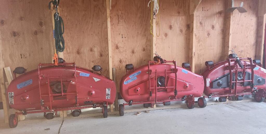

Brockport Bill 2,470 #19 Posted February 14, 2024 41 minutes ago, peter lena said: @ RED - Z06 , never dealt with Florida sandy soil , but something I regularly do , IS BREAK THE GRUNGE CYCLE , decks are easy to drop and have a look see , the irony here , is you have the heat / dry , to absorb some lubrication into that metal . when I spray mine down , they are propped up to the sun , clean , and oil soaked , decks actually get hot and bake in the lubricant , leaving a black stained cover finish , my decks are also propped up now to wall studs , with screw in eye bolts and heavy spring to stay in place , till spring . all are soaked with heavy gear oil , zero rust / rot , done this for years . no sarcasm or insults , just what I do to solve the issue , pete took your advice Pete - very efficient use of space - - previously I tripped too many times climbing over them -- all serviced ready for next use 3 Share this post Link to post Share on other sites
peter lena 10,047 #20 Posted February 14, 2024 @Brockport Bill thats what i,m talking about ! good job on that .! like the screw in eye hook , then make up a heavy wire hook to attach to spring , like 1/8 / 3/16 hard wire , open hook easily attaches to many deck areas . down to 3 decks , pete Share this post Link to post Share on other sites
Brockport Bill 2,470 #21 Posted February 14, 2024 8 minutes ago, peter lena said: @Brockport Bill thats what i,m talking about ! good job on that .! like the screw in eye hook , then make up a heavy wire hook to attach to spring , like 1/8 / 3/16 hard wire , open hook easily attaches to many deck areas . down to 3 decks , pete i've used a couple of the velcro type straps with eye hook on end - as well as used those heavy duty twisty ties - - had not tried the spring idea - i like to use something i can easily apply while i'm holding up the deck while it wants to roll away on axle wheels - also use something that won't scar the paint on the deck where i attach to lift carriage cross bars Share this post Link to post Share on other sites

peter lena 10,047 #24 Posted February 15, 2024 @Brockport Bill just a collection of various spring mounts , made up for issues , prefer the long hooks , with a spring mount for mower deck wall storage , wide open end , easily grabes a hold spot on a deck , note the smooth / fine double ended spring , those on that perforated stainless , is what I use on my choke/ throttle cables , dash levers moves with total ease , its always pulling it closed , so its always spring assisted , also super lube , the thin wire is s/s tig wire, pete Share this post Link to post Share on other sites
