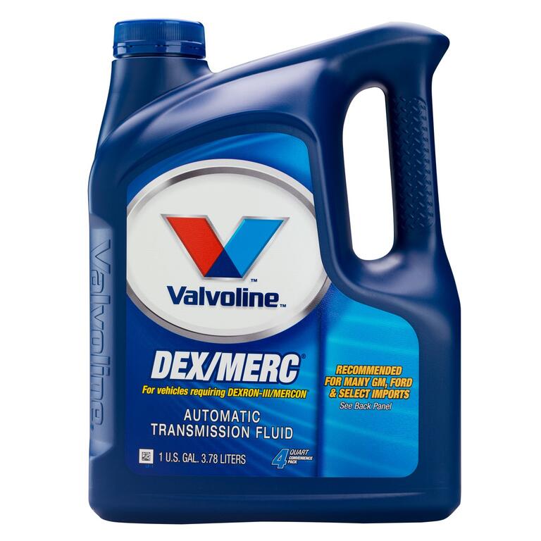

Chris-laf 3 #1 Posted February 13, 2024 I am working on a wheel horse GT 14 I drained the motor oil it was motor oil I took off the rear filter it was transmission fluid am I good to replace with 10w 30 so long as I don't harshly mix the 2 fluids together also how much fluid does it require for both transmission and engine Share this post Link to post Share on other sites
Sparky-(Admin) 26,788 #2 Posted February 13, 2024 I dont think you want to mix motor oil with ATF…someone here will chime in with what type of ATF is correct for your Sunstrand Hydro pump Share this post Link to post Share on other sites
kpinnc 19,073 #3 Posted February 13, 2024 ATF is far better in a Sundstrand. 3 Share this post Link to post Share on other sites
squonk 48,386 #4 Posted February 13, 2024 Older Sunstrands used ATF. Around 73 WH changed to motor oil. Put in what type oil you took out. 2 Share this post Link to post Share on other sites
pfrederi 21,324 #5 Posted February 13, 2024 Changing requires multiple fills and flushes, wastes a lot of product, time, and money. ATF works great in older sunstrands. Share this post Link to post Share on other sites
