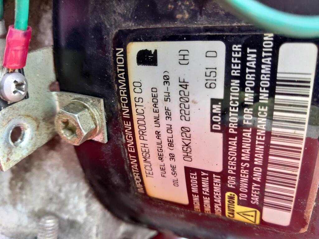

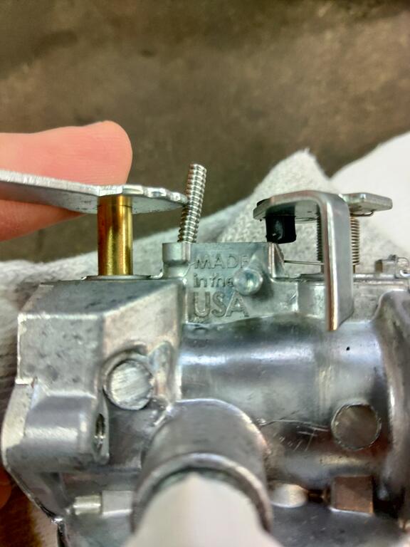

Bill D 3,099 #1 Posted February 12, 2024 I have a Tecumseh OHSK120 on my neighbors snowblower that I cannot get to run correctly. I've changed the carb ( new OEM, Made in USA!) with some improvement, but it still surges and backfires. All indications are that it's running lean. I'm going to change the intake manifold gasket next. Thoughts? I'm running out of ideas on this and it's driving me crazy. Share this post Link to post Share on other sites

Bill D 3,099 #8 Posted February 13, 2024 I put a new carb on it. Old one was adjustable, new one is not. Starts better with the new carb but still runs lousy. I'm thinking the intake gasket could be leaking though I can't see any evidence. The engine sat for awhile before I got it. Gasket is probably dried out. Restarts fine when hot with one shot of primer. That make me think it isn't valves. Share this post Link to post Share on other sites
