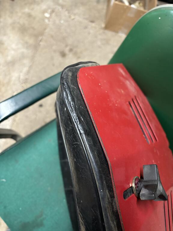

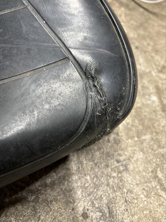

fourwheelhorseman 362 #1 Posted February 11, 2024 I have a three piece seat that I just purchased, the vinyl has been repaired a time or two over the years. The repairs look pretty solid. I would like to replicate this repair on a different seat. However I’m unsure of what they used, it looks like a plastic, flexible rubber that was black. Any idea what it could be? Another way of saying this.. what is the best stuff on the market to glue vinyl, fill in cracks and hold together for years down the road? It’s also black, I’ve seen it before on other seats, but have never been able to identify it. Share this post Link to post Share on other sites

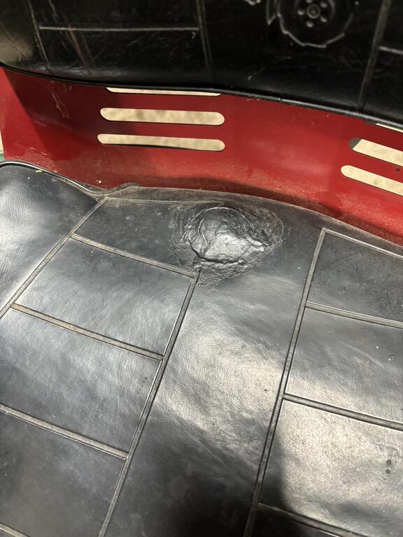

fourwheelhorseman 362 #9 Posted February 17, 2024 On 2/13/2024 at 12:38 PM, wallfish said: Without pics it didn't happen! LOL Here ya go! It seems pretty solid. Hoping it holds up until I can get new cushion and back. 2 Share this post Link to post Share on other sites
wallfish 20,744 #10 Posted February 17, 2024 1 hour ago, fourwheelhorseman said: Here ya go! It seems pretty solid. It is, it smells exactly like the Plasi Dip stuff for doing tool handles. Think it's the same compound 1 Share this post Link to post Share on other sites
