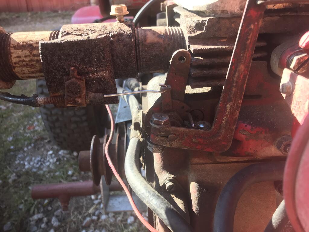

horseman with no horse 22 #6 Posted February 13 heres what my setup looks like Share this post Link to post Share on other sites
wallfish 15,940 #7 Posted February 13 (edited) 29 minutes ago, horseman with no horse said: heres what my setup looks like That set up looks correct. (except for the cable is typically connected to that throttle arm instead of a bracket made on the exhaust) That shouldn't affect performance of the governor. Remove the governor arm from the shaft and try to spin the shaft. There's supposed to be a tab on the shaft that would stop it from spinning. If it spins all the way around that tab has broken off. If you can not spin it all the way around that's good. Put the arm back on and set the governor. With the cinch bolt loose use pliers to turn the shaft all the way counter clockwise, then move the governor to the left so the carb is all the way open. Lock the arm bolt. Try starting it up in idle position and push on the governor arm with your fingers to increase RPM. You should feel it push back to try and close the carb. It won't be a guess either, it pushes pretty hard. Sometimes when the governor has been worked on a lot, that shaft still spins in the arm's hole when you think it's tight so watch for that too. Edited February 13 by wallfish 3 Share this post Link to post Share on other sites
Handy Don 10,656 #8 Posted February 13 2 hours ago, horseman with no horse said: You can see that the sheathing on the throttle cable is being melted by the heat of the exhaust. Finding a way to re-mount it will help it live longer! Share this post Link to post Share on other sites
wallfish 15,940 #9 Posted February 13 2 hours ago, horseman with no horse said: heres what my setup looks like It does look like the spring is missing too and the screw head that holds it is broken off. Click through the pics in that thread I posted earlier. On pg2 there's a clear view of the governor spring 1 Share this post Link to post Share on other sites

horseman with no horse 22 #18 Posted February 17 On 2/13/2024 at 4:52 PM, wallfish said: It does look like the spring is missing too and the screw head that holds it is broken off. i think the screw head is there but the spring is gone for sure Share this post Link to post Share on other sites
horseman with no horse 22 #19 Posted February 17 unless im looking at the wrong screw head? it looks like its sitting to the right of the tab on the rotating control disk thing. or is that not the right screw head? Share this post Link to post Share on other sites
