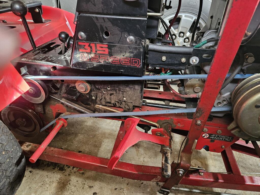

Chris Mullen 0 #1 Posted February 10, 2024 (edited) My father and I are replacing a broken clutch belt on our Toro/Wheelhorse 315-8 tractor. We are struggling to determine if the belt routes under or over the red bar in this picture. I think it should go under so it doesn't rub but then the belt is pretty loose. If it goes over it will certainly rub. All the pictures and diagrams I see are for other models or don't how this particular view. So my question is over or under? Or do we have this all wrong. Edited February 11, 2024 by Chris Mullen Corrected title Share this post Link to post Share on other sites
pfrederi 21,345 #2 Posted February 10, 2024 Under the rod 2 1 Share this post Link to post Share on other sites
peter lena 10,125 #3 Posted February 10, 2024 @Chris Mullen another detail how smoothly does the to idler pulley move ? frequent bearing failure , rough movement , also get after all related clutch / linkage with penetrant oil also get after the lift lever related linkage , make the rust run out , spray into the top of lift lever , at push button . make the rust run out , you are right there , Pete 1 Share this post Link to post Share on other sites
Ed Kennell 47,952 #5 Posted February 11, 2024 Under the rod. If the belt is too loose, get a shorter belt. 2 Share this post Link to post Share on other sites
