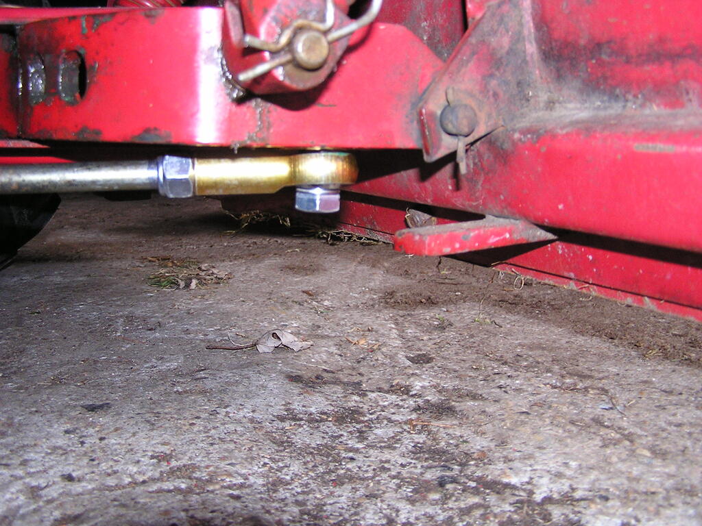

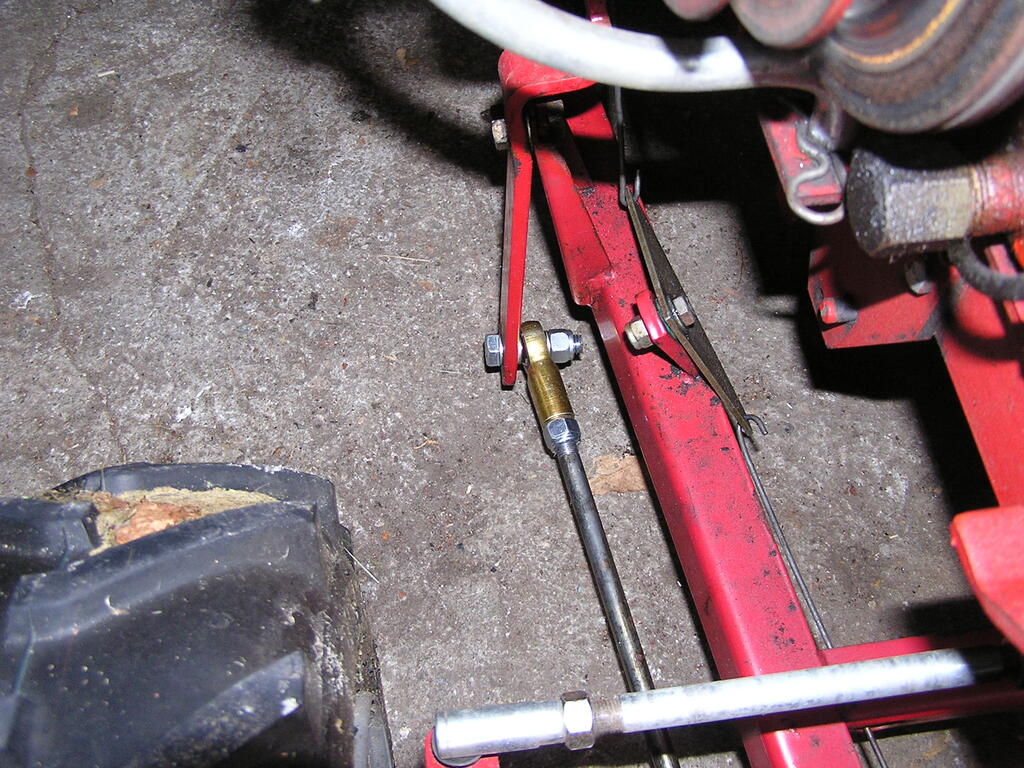

ri702bill 13,189 #4 Posted February 10, 2024 (edited) One good upgrade is to replace the bent ends of the angling rod with a pair of spherical Heim joints. Smooooth action. Edited February 10, 2024 by ri702bill 2 Share this post Link to post Share on other sites

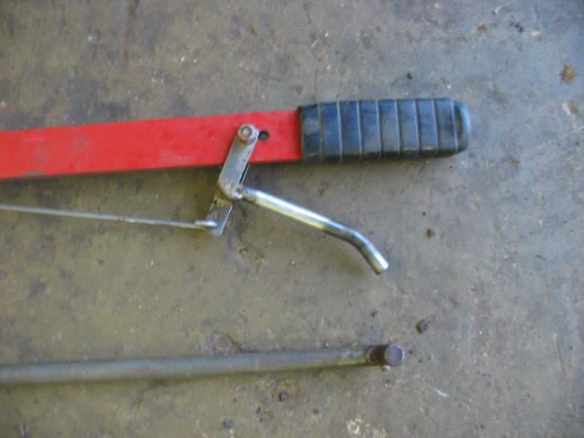

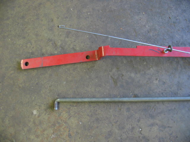

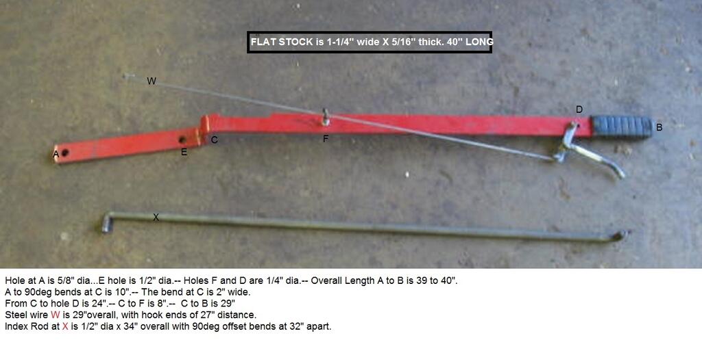

daveoman1966 3,884 #9 Posted February 10, 2024 (edited) This is the Index Lever you want... Make one from flat stock...easy to do (if you have the right tools). Edited February 11, 2024 by daveoman1966 2 Share this post Link to post Share on other sites
