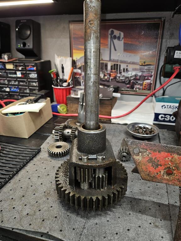

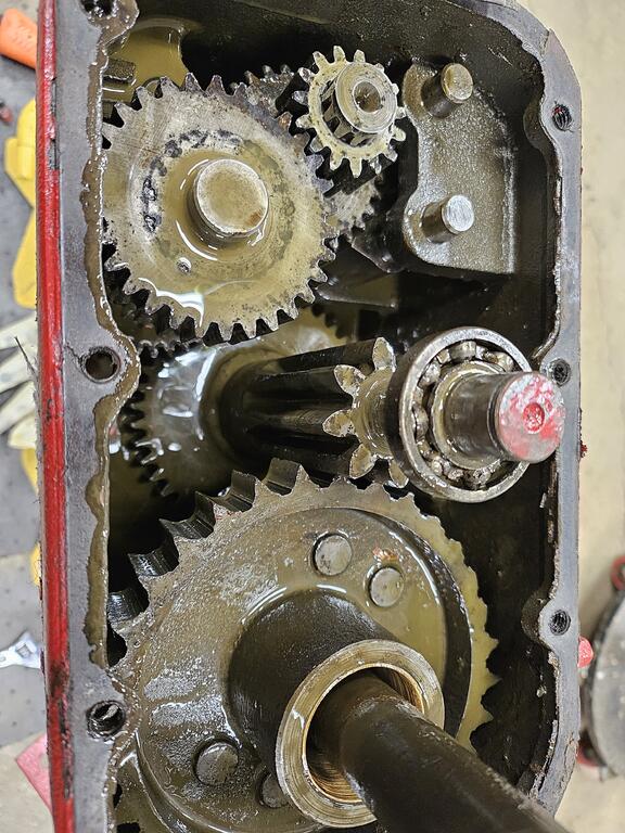

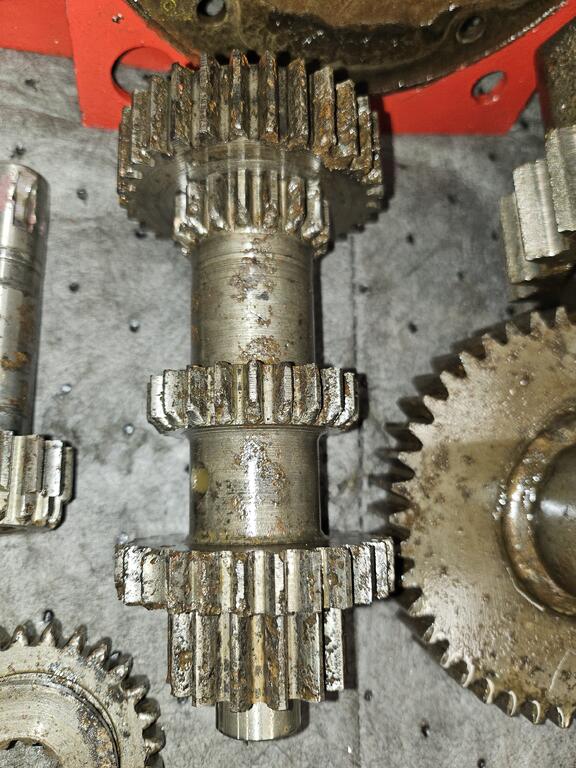

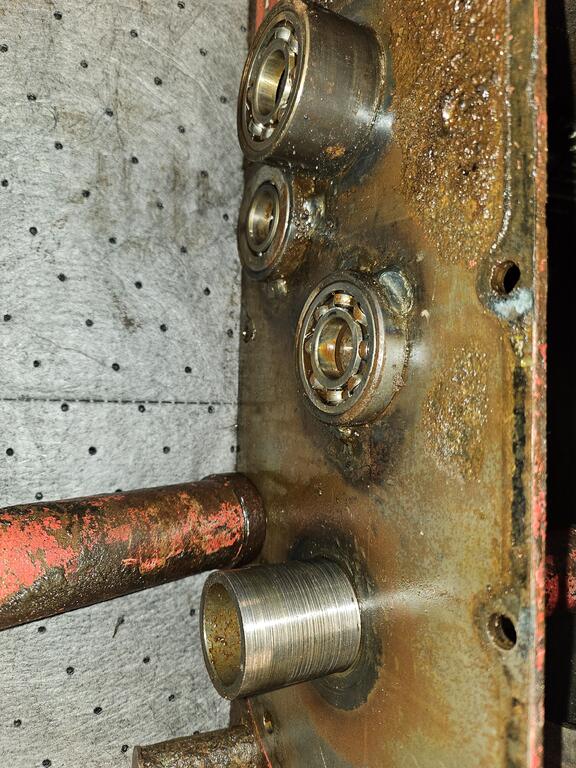

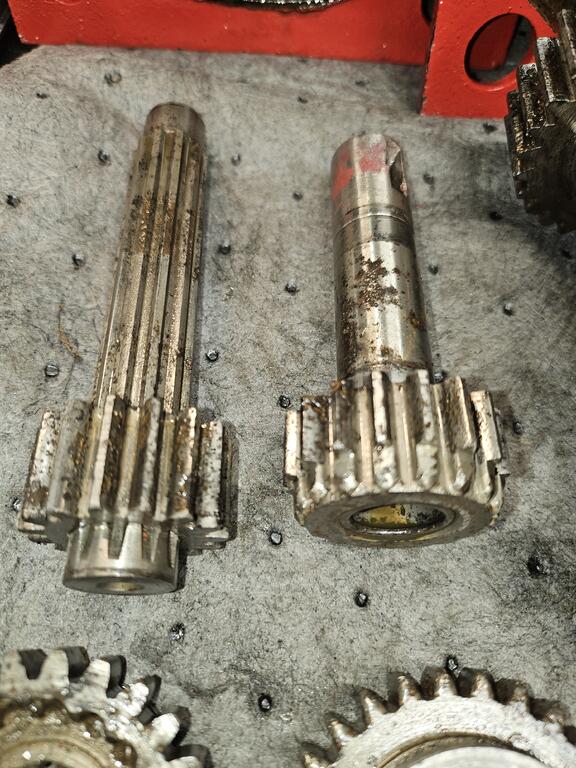

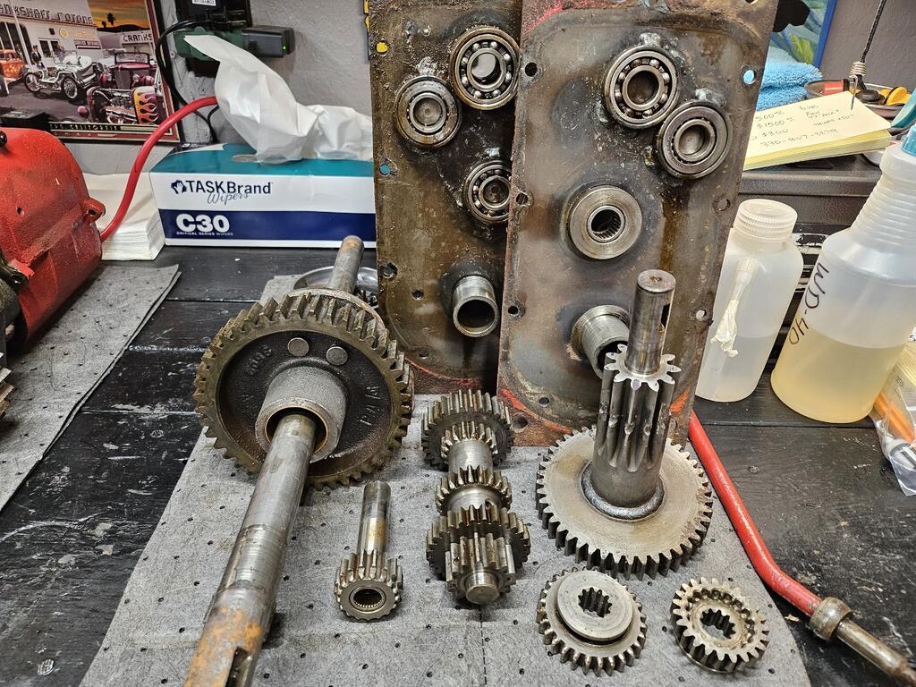

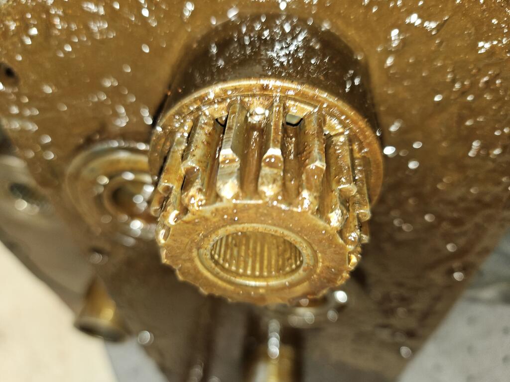

ML3 863 #1 Posted February 10 Starting to dig into my Suburban transmission. Decided to start taking apart the original one that was in tractor. Here's the results...... Not much that's good. Most the bearings seized. Surprisingly the diff assembly looks good. I still got a lot of cleaning to do. Next I'll take apart the transmission that's in the Suburban now. I bought at big show last year that was supposed to be good. Turns out...it's not. Was hoping that between the 2 transmissions I could make 1 good or at least get most the way there🤞 Trying to get the other transmission apart this weekend. Hate working on transmissions! 2 Share this post Link to post Share on other sites

ebinmaine 63,269 #3 Posted February 10 6 minutes ago, WHX?? said: Think to fail and you will ... think to succeed and you will. ❤️ 1 hour ago, ML3 said: Suburban transmission Bearings are easy to obtain. Not an issue. The gears are available. You're really not in bad shape. Looks ugly as a stump fence ... but so do I. 2 Share this post Link to post Share on other sites

ri702bill 7,360 #5 Posted February 10 Always best to flush the transmission first before disassembling it...... Share this post Link to post Share on other sites

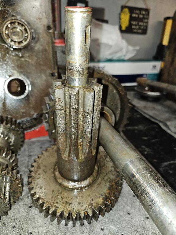

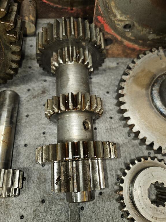

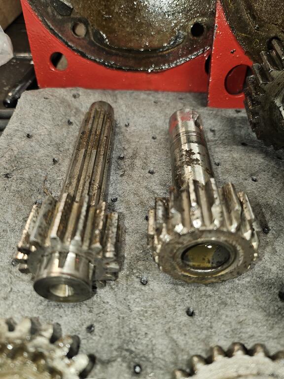

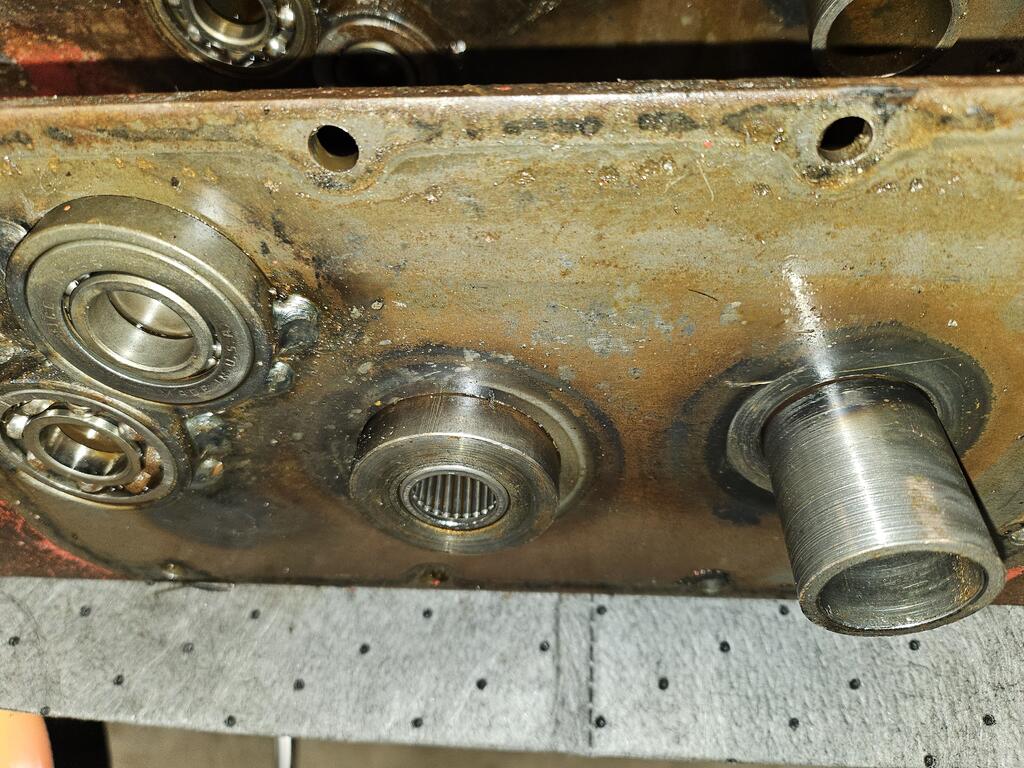

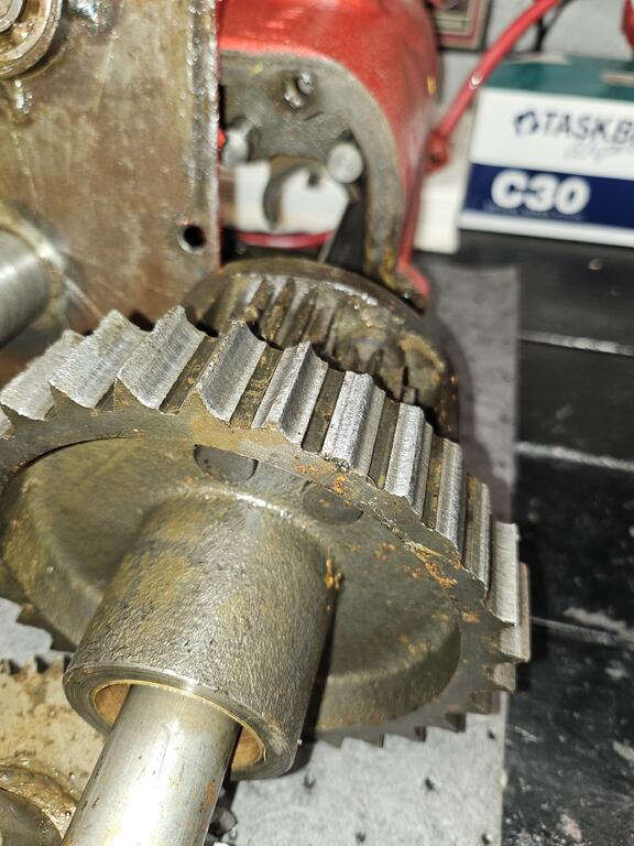

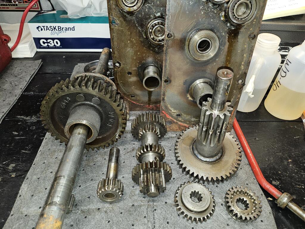

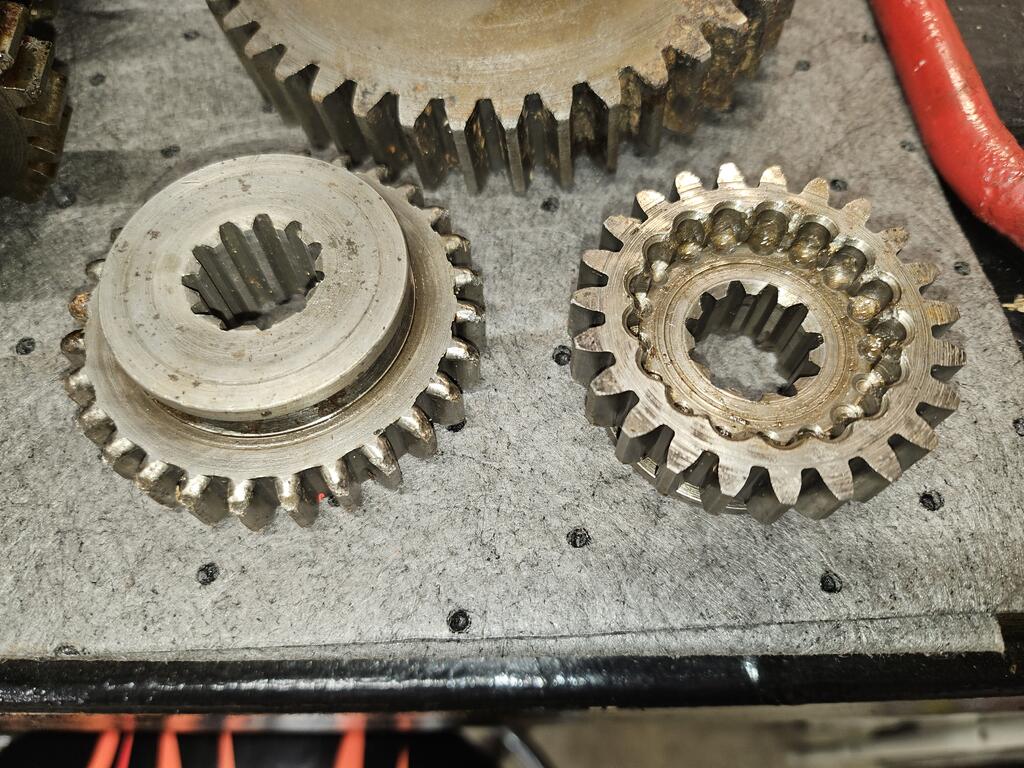

ML3 863 #8 Posted February 10 (edited) Got parts from original transmission cleaned up. Pretty much every bearing is seized or binding. Not too much to salvage gear wise. Definitely scoring on axle shafts where bushings first diff ride. However, it still seems like diff is good. Now I gotta get other transmission off Suburban & apart. My garage reeks like gear lube! 🤮 Glad it's a detached garage. And of course the pump decides to go out on my solvent wash tank..... Edited February 10 by ML3 1 Share this post Link to post Share on other sites

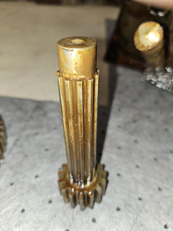

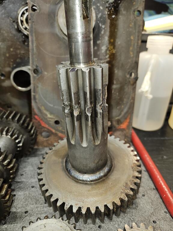

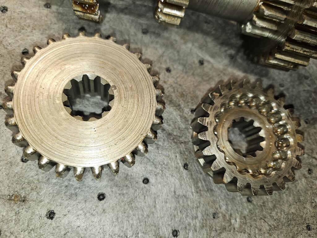

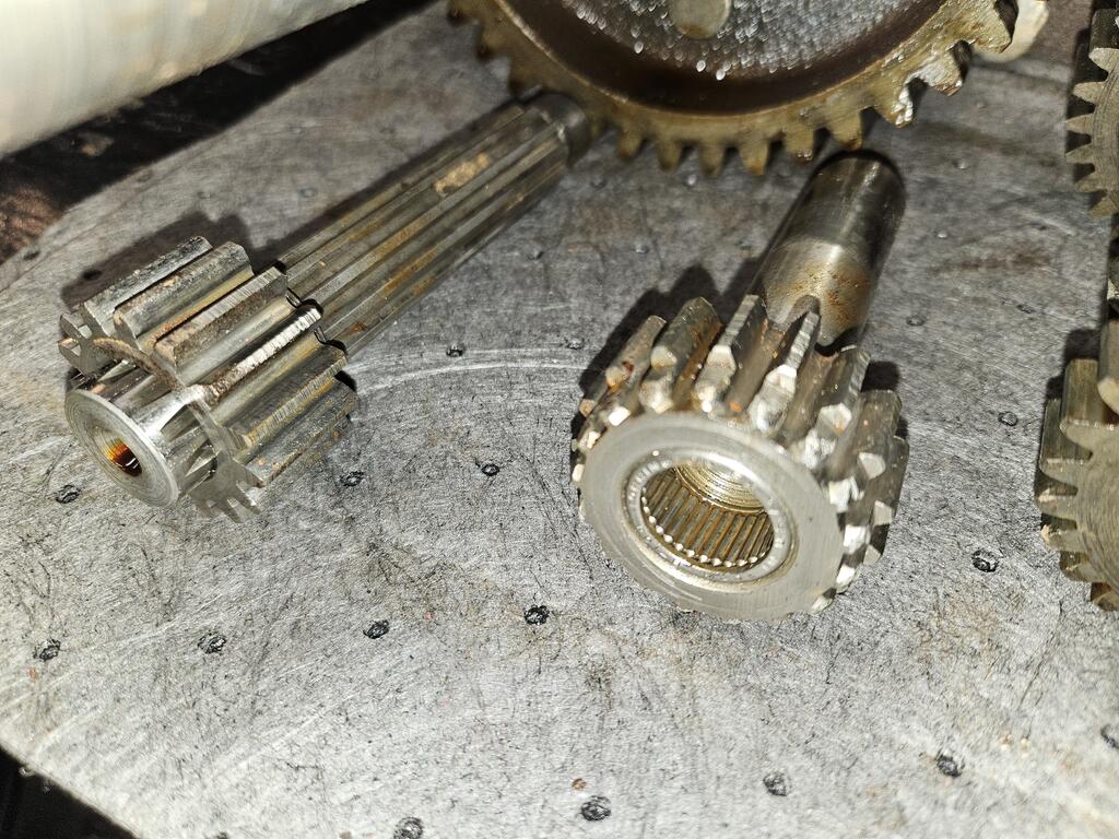

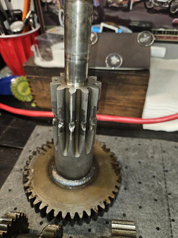

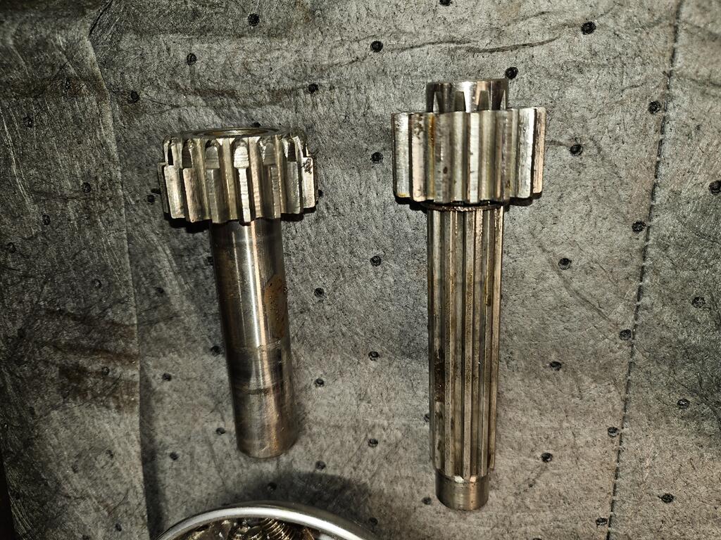

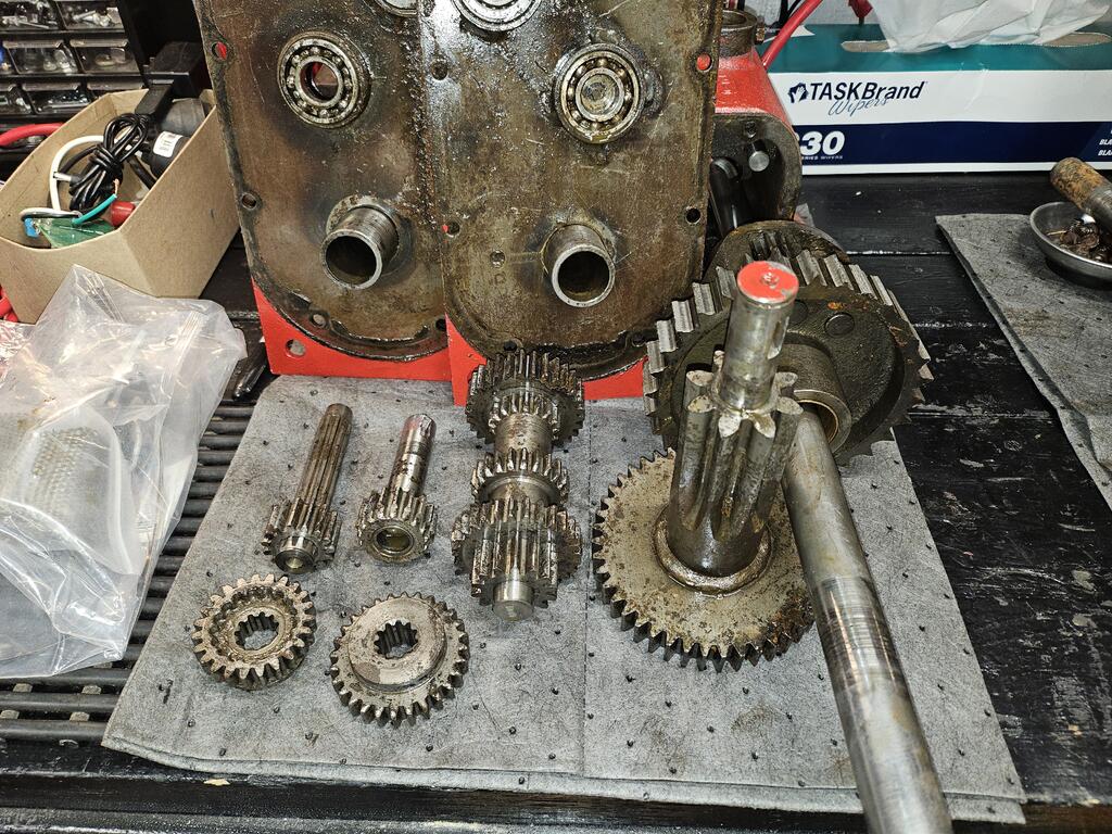

ML3 863 #14 Posted February 11 Here's the original Suburban transmission apart & damage..... Share this post Link to post Share on other sites
wallfish 15,940 #15 Posted February 11 23 hours ago, ML3 said: It's got a slightly built Predator that's probably close to 8hp. It's a rat rod so I'm sure I'll ride it like an idiot & do wheelies etc. Lol. If that's the case then why not just add an 8 speed trans to it? Those little transmissions won't take as much abuse as evidenced by the damage you have now. Welding a plate on the back of the frame or better yet, weld one up that can just bolt on to the frame so it can always be switched back to original and it's a fairly simple deal to do too. Save those old trans! LOL Share this post Link to post Share on other sites

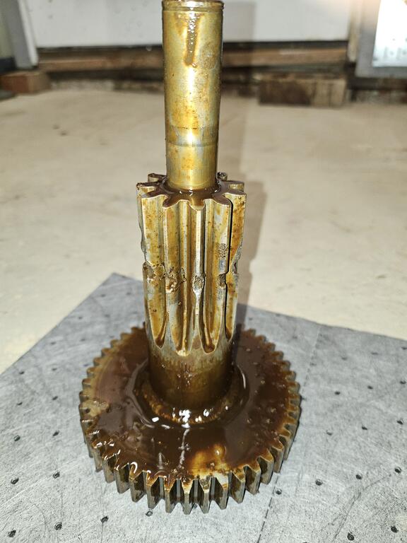

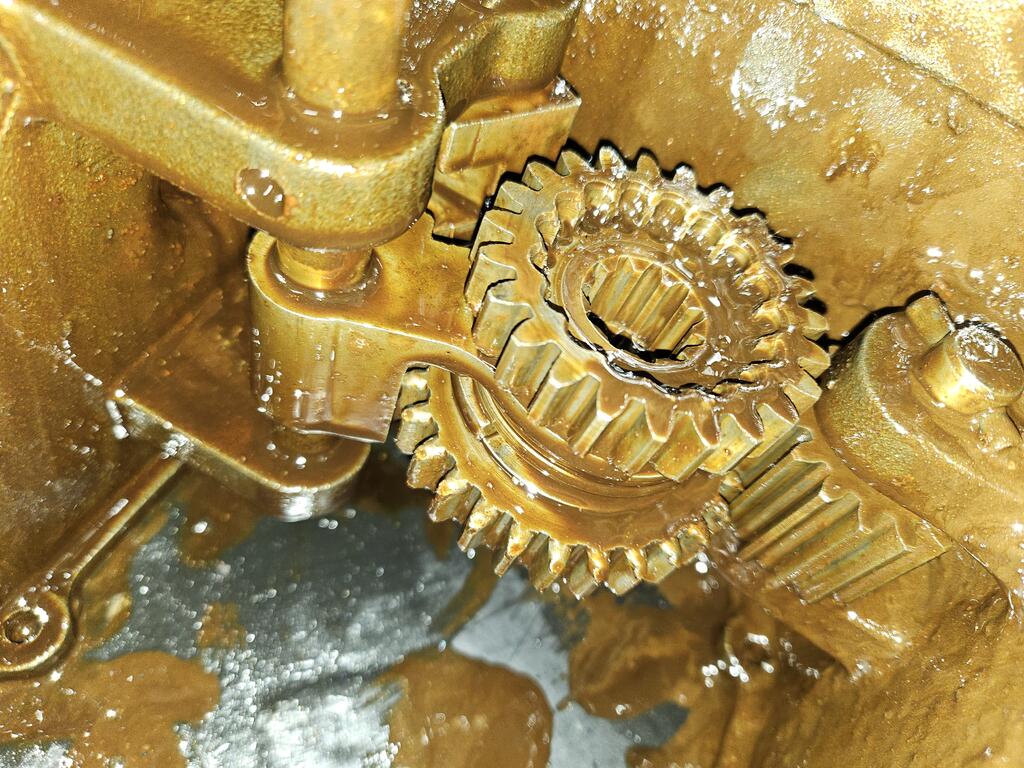

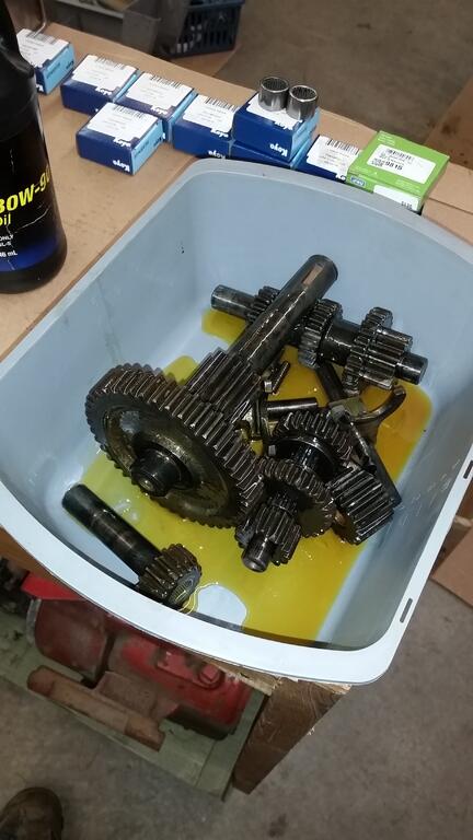

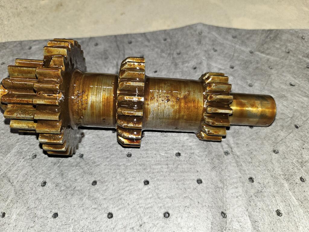

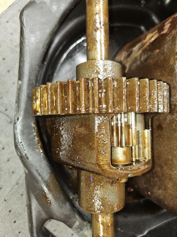

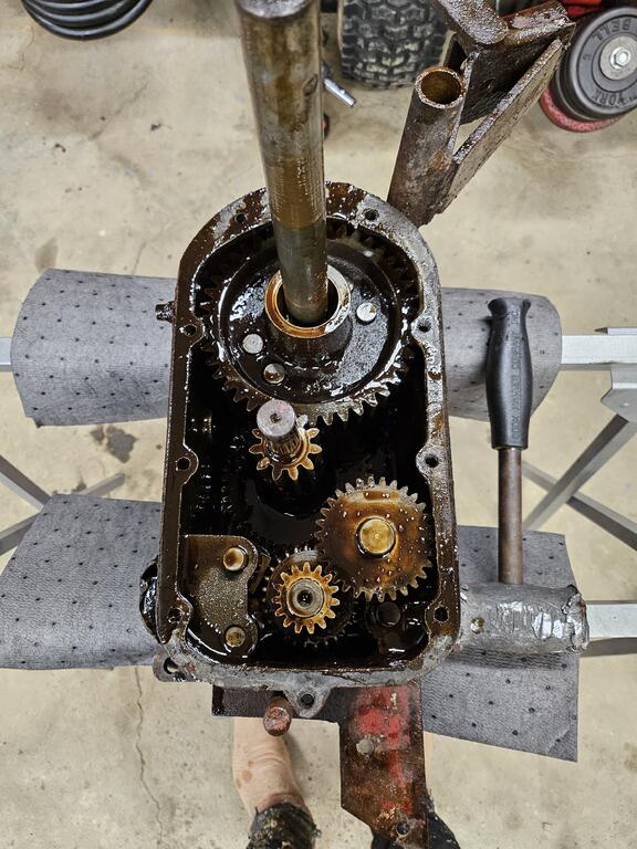

ML3 863 #16 Posted February 11 Here's the transmission I purchased last year. Share this post Link to post Share on other sites
