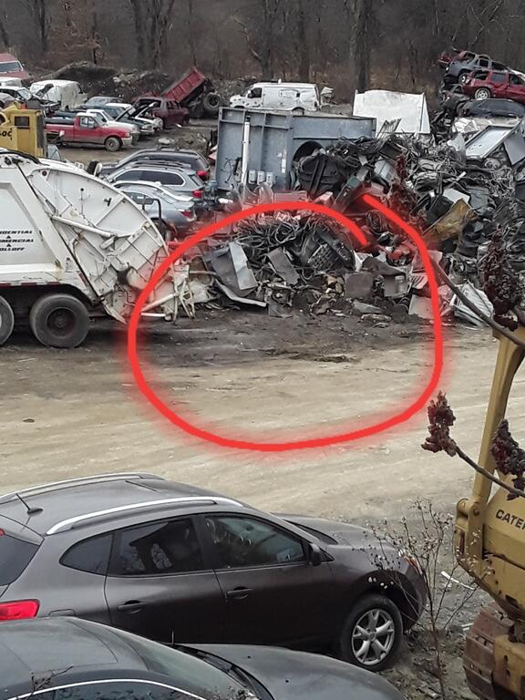

76c12091520h 4,284 #1 Posted February 9, 2024 As I've said before, our collision center overlooks our corporation's scrap yard......first thing this morning out my back window it was sitting in the red circle. It's somewhere safer now. 5 16 Share this post Link to post Share on other sites

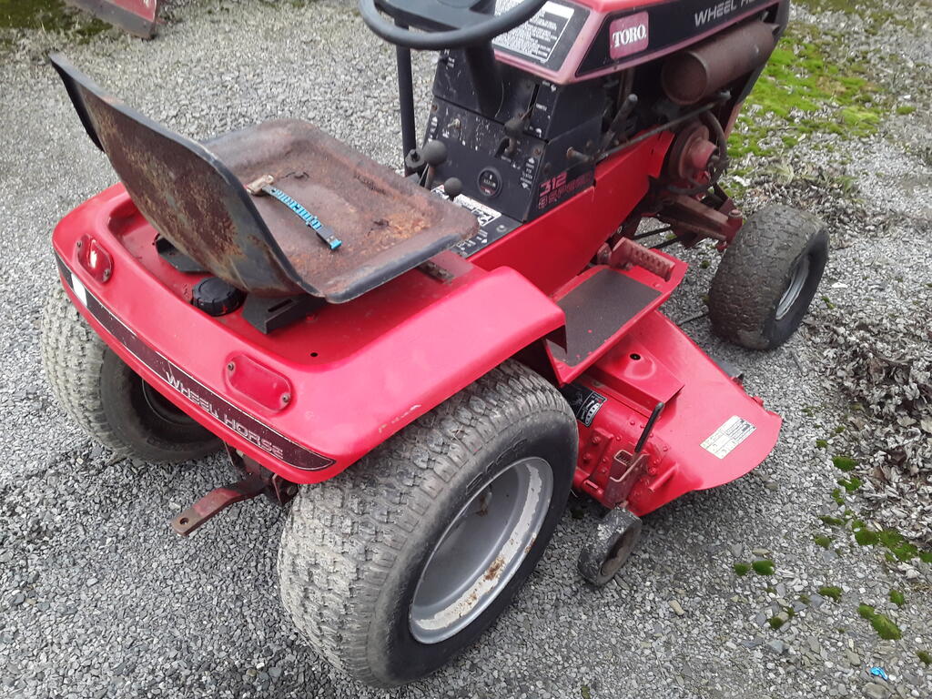

ebinmaine 80,656 #2 Posted February 9, 2024 Excellent save. The top of that mowing deck looks fantastic. 6 Share this post Link to post Share on other sites
peter lena 10,047 #3 Posted February 9, 2024 @76c12091520h yes in todays world , even the most basic form of maintenance is non existent , to me looks like a thorough functional check , and related service , oils / electrical , maybe even a penetrating oil wipe down , could easily turn that into , dollars , seat would be very easy , Pete 2 Share this post Link to post Share on other sites

grinchsr 674 #9 Posted February 10, 2024 I love how someone kept the seat safety switch in the correct position. 2 Share this post Link to post Share on other sites
ebinmaine 80,656 #10 Posted February 10, 2024 2 minutes ago, grinchsr said: I love how someone kept the seat safety switch in the correct position. So that's what it is! I wondered... we have one here from a parts pile. I hadn't taken the time to run the nu.bers yet. Thanks Ray. 1 Share this post Link to post Share on other sites

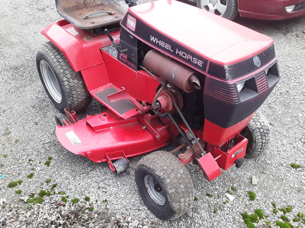

76c12091520h 4,284 #12 Posted February 10, 2024 Update: I can only guess why someone scrapped it, however , both the PTO belt and the drive belt were seized fast to the pulleys ( PTO belt was in the wrong groove too ) and would not let the engine turn over. Cut the belts, checked the oil, rigged up a can of gas, put a jump pack on it.....purrs like a kitten. 20240210_154051[1].mp4 8 Share this post Link to post Share on other sites
