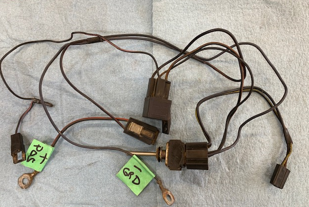

JoeM 10,070 #2 Posted February 8, 2024 (edited) I looked at a harness I have and did not see a breaker just a fuse holder. That relay might be the problem?? Here is the instructions incase you don't have them. ElectricLift.pdf Edited February 8, 2024 by JoeM Share this post Link to post Share on other sites

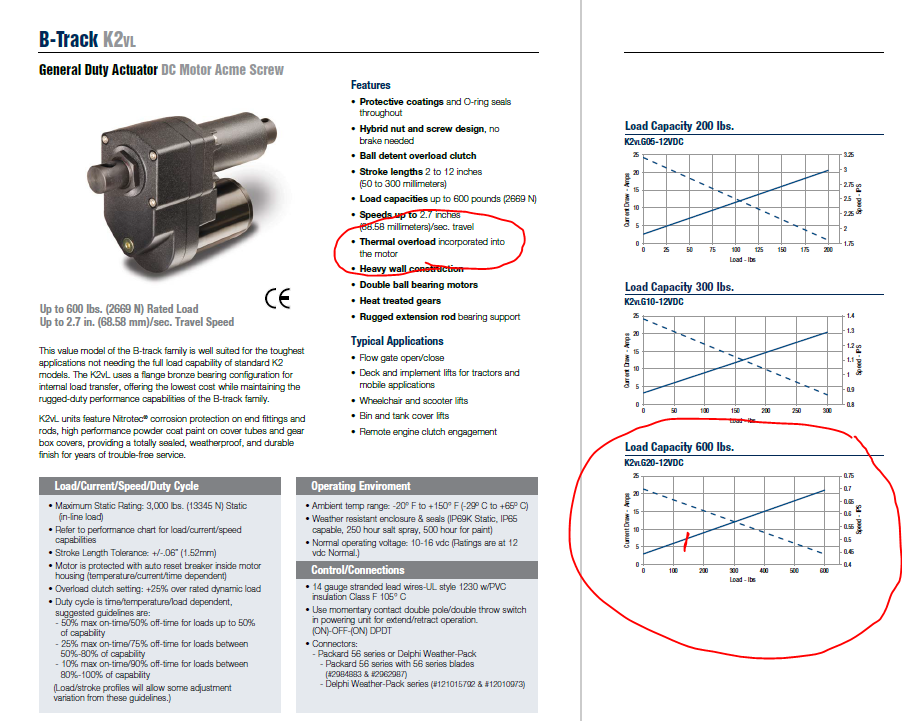

JoeM 10,070 #3 Posted February 8, 2024 I also found this in my files and I am not sure if your actuator has the built in overload or not but you may find out in the literature. ElectricActuator.pdf Share this post Link to post Share on other sites

RED-Z06 2,718 #5 Posted February 8, 2024 2 hours ago, JoeM said: I looked at a harness I have and did not see a breaker just a fuse holder. That relay might be the problem?? Here is the instructions incase you don't have them. ElectricLift.pdf 1.3 MB · 0 downloads This setup has no relays, its powered directly through the contacts in the switch ss far as i can trace it. Share this post Link to post Share on other sites

JoeM 10,070 #8 Posted February 8, 2024 3 hours ago, RED-Z06 said: Its pulling about 2amps lifting then spikes 7amp at the stop which kills power about 15 seconds. I am thinking that is a B Track Actuator and 7 amp is on the low end. It shows an internal OL Might be bad. That's all folks. Share this post Link to post Share on other sites
RED-Z06 2,718 #9 Posted February 9, 2024 1 hour ago, JoeM said: I am thinking that is a B Track Actuator and 7 amp is on the low end. It shows an internal OL Might be bad. That's all folks. Thats what i expected to find in the motor, i had it completely apart last year because the 2 long bolts were pulling the threads out the base, i had to remove the bolts, the end cap, then pull the housing and armature out. I took the time to clean the comm, and bushing cups, dab of grease there...but i didnt see anything on the end cap with the brushes or in the stator housing, that looked like a disconnect or out of the ordinary. Maybe i missed it and its just small, but stuff 50 years ago wasnt usually subtle. I can lift and lower the deck repeatedly for 2 minutes without any problems, but if it sits on the stop for just a moment...it stops. Share this post Link to post Share on other sites
