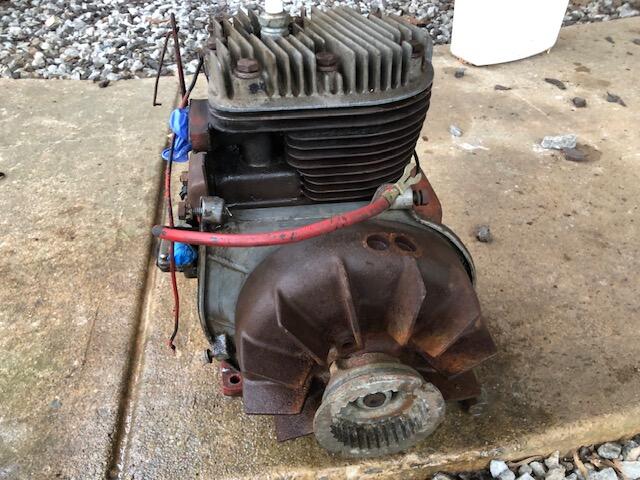

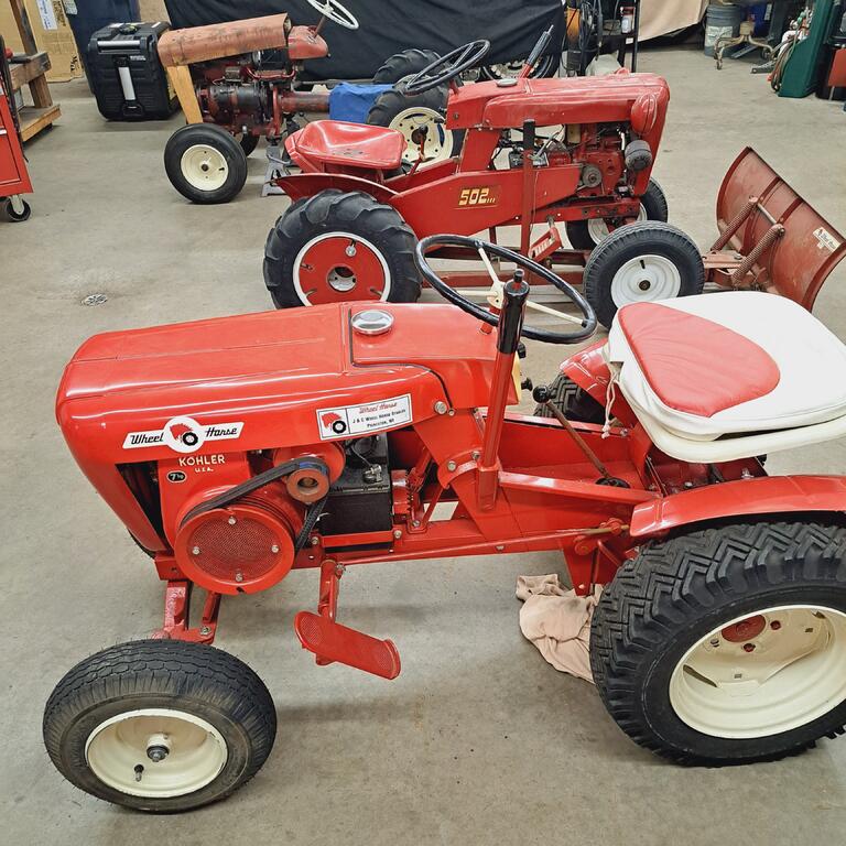

WHX?? 57,804 #27 Posted February 7, 2024 (edited) Wow that 701 is in great shape! Sure not what I started out with! 23 minutes ago, Sailman said: .the small engine guy I mentioned stated that he was told by the EPA to punch a hole in any worn out Kohler K engine.....reason being they were so "dirty" the EPA did not want them rebuilt... Stay away from him. Edited February 7, 2024 by WHX?? Pic 2 Share this post Link to post Share on other sites

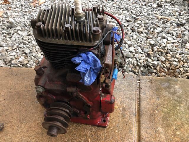

Sailman 1,307 #31 Posted February 9, 2024 (edited) I am going to deviate from the original thread. Still dealing with a K-161 but this one is from my 704. I was tinkering with this one as a prelude to tackling the 701. K-161 has similar issue, turn over by hand but no movement on the piston...soooo I have stripped the engine and removed it from tractor and cleaned it. Question is, can I remove the oil pan and head as is and see what I have to deal with or do I have to remove flywheel first? If it needs bore and rebuild it will have to be stripped all the way but just wondering if I can investigate as is with oil pan and head removed. Guess I will have to lay it on its side to access both ends. What say you re-builders? Edited February 9, 2024 by Sailman 1 Share this post Link to post Share on other sites
RED-Z06 2,720 #32 Posted February 9, 2024 16 minutes ago, Sailman said: I am going to deviate from the original thread. Still dealing with a K-161 but this one is from my 704. I was tinkering with this one as a prelude to tackling the 701. K-161 has similar issue, turn over by hand but no movement on the piston...soooo I have stripped the engine and removed it from tractor and cleaned it. Question is, can I remove the oil pan and head as is and see what I have to deal with or do I have to remove flywheel first? If it needs bore and rebuild it will have to be stripped all the way but just wondering if I can investigate as is with oil pan and head removed. Guess I will have to lay it on its side to access both ends. What say you re-builders? I normally leave the oil pan on the frame and just lift the half stripped engine off the pan. So yes, you can, the flywheel can stay in place until you have to pull the bearing plate. 1 1 Share this post Link to post Share on other sites
