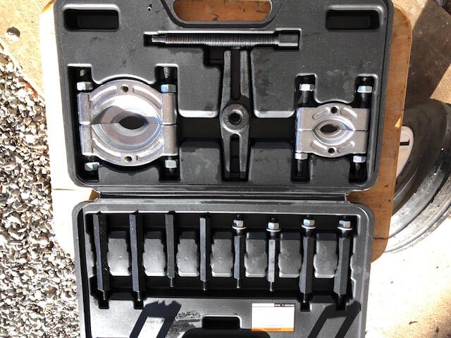

Sailman 1,307 #1 Posted February 4, 2024 I am preparing to work on the 704 I salvaged a while back. Very rusted but seems complete with motor that turns over freely and functioning transmission. Wanted to pull the steering wheel to not have to cut the hood for removal. Used Kroil often over a couple of weeks and then used this handy tool from Harbor Freight ($54). I used the larger bearing puller and inverted it under the overlapping wheel shaft. Worked smooth as silk. Only issue was not watching it closely and adjusting it. Ended skimming a bit of metal off the shaft but easily filed it smooth. Just an FYI for one of those dreaded hard jobs. Hopefully it will also be a good hub puller. 4 Share this post Link to post Share on other sites

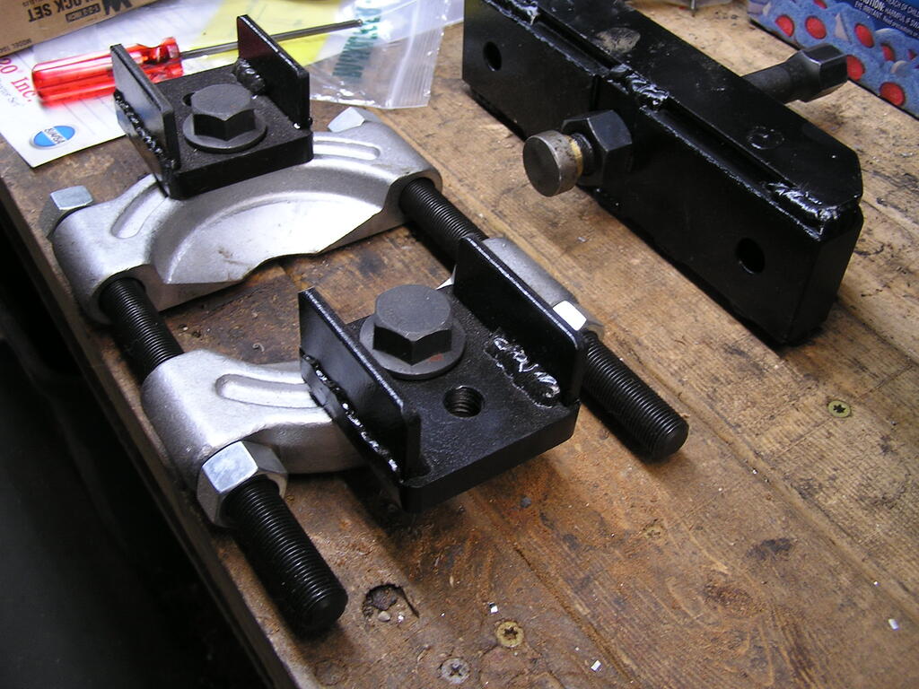

ri702bill 12,990 #2 Posted February 4, 2024 Nice! My adaptation of the Large HF Bearing Separator for pulling hubs.... 2 2 Share this post Link to post Share on other sites
squonk 48,079 #3 Posted February 4, 2024 I have the same kit. I have bent those studs a few times. I had to remove the steering wheel on my 1267. Roll pin was not coming out. A small bearing separator at the wheel followed by a large separator over the top. A 12" 2 jaw gear puller and a 24" crescent wrench sheared the pin and removed the wheel 2 Share this post Link to post Share on other sites
