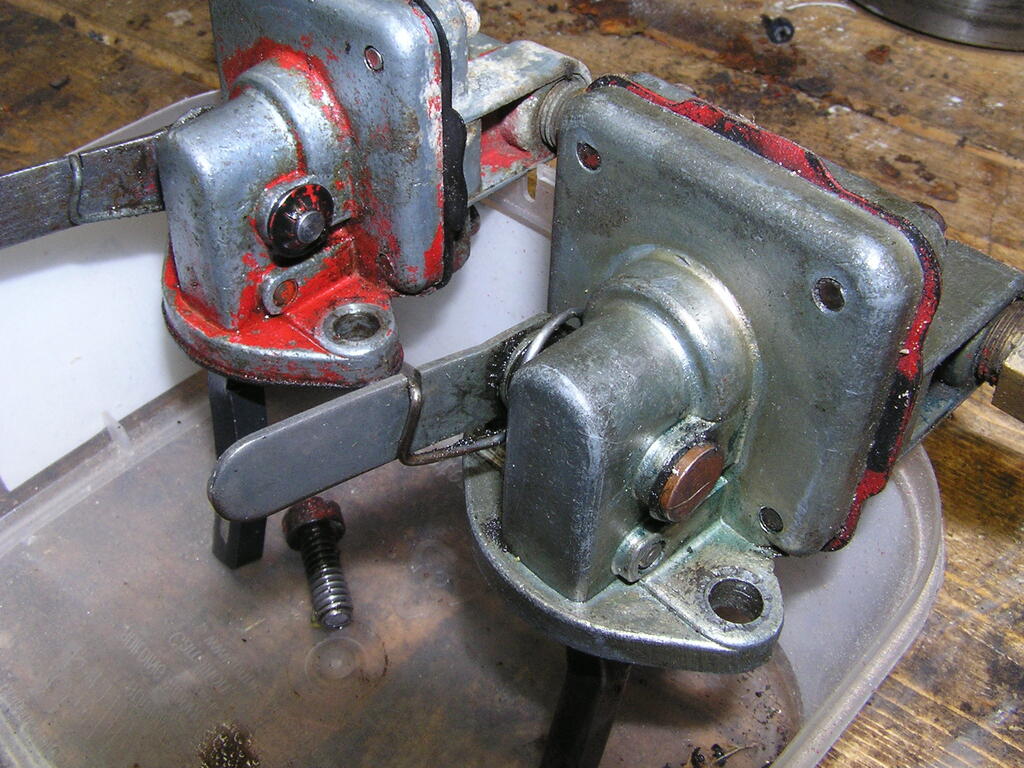

RED-Z06 2,720 #1 Posted February 4, 2024 Mine has a blockoff plate on the engine, its just gravity feeding from the tank/sediment bowl...it seems to work but its occurred to me, that may not be correct, and if its supposed to have one, which one? The engine is a K181S-30536d, off a Charger 8 i think. Share this post Link to post Share on other sites
ri702bill 12,816 #2 Posted February 4, 2024 Yes, the K161 on the 702 does use a lever style fuel pump. The "correct" one is rather difficult to find - is has the external primer lever hanging down. Works fine... Share this post Link to post Share on other sites
RED-Z06 2,720 #3 Posted February 4, 2024 2 minutes ago, ri702bill said: Yes, the K161 on the 702 does use a lever style fuel pump. The "correct" one is rather difficult to find - is has the external primer lever hanging down. Works fine... Do these have the straight or offset drive lever? Share this post Link to post Share on other sites
squonk 47,887 #4 Posted February 4, 2024 Small block pumps have the offset lever. 1 1 Share this post Link to post Share on other sites
