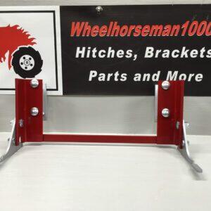

Racinbob 13,213 #10 Posted February 4, 2024 Here's a couple of the style bracket you need. Here's the older style that Ed was referring to. Share this post Link to post Share on other sites

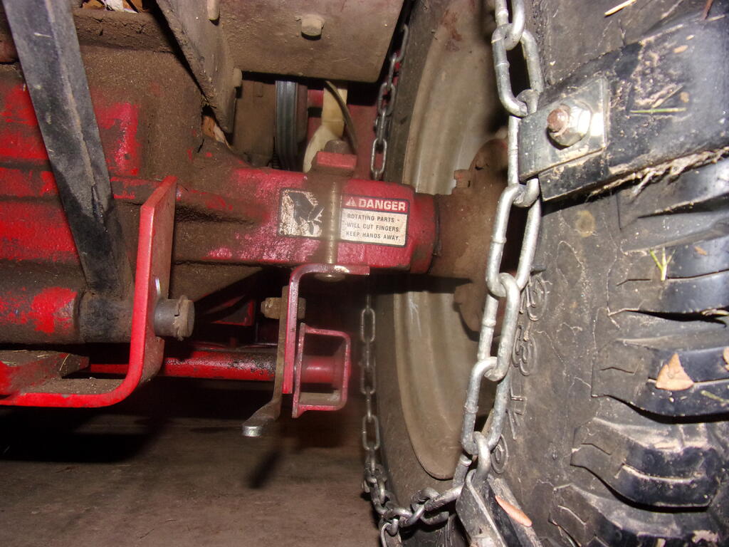

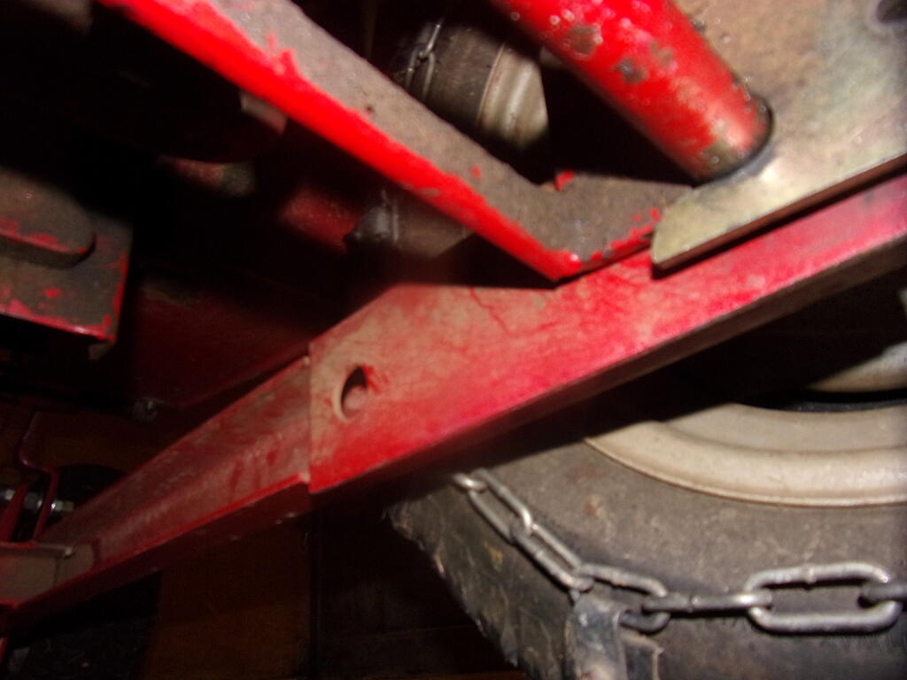

Ed Kennell 47,594 #11 Posted February 4, 2024 Thanks Bob. Here are a couple pics of a long plow frame on a long frame tractor. With this axle bracket on a short frame tractor, the plow frame could be moved back and use the forward holes in the plow frame. 1 Share this post Link to post Share on other sites
