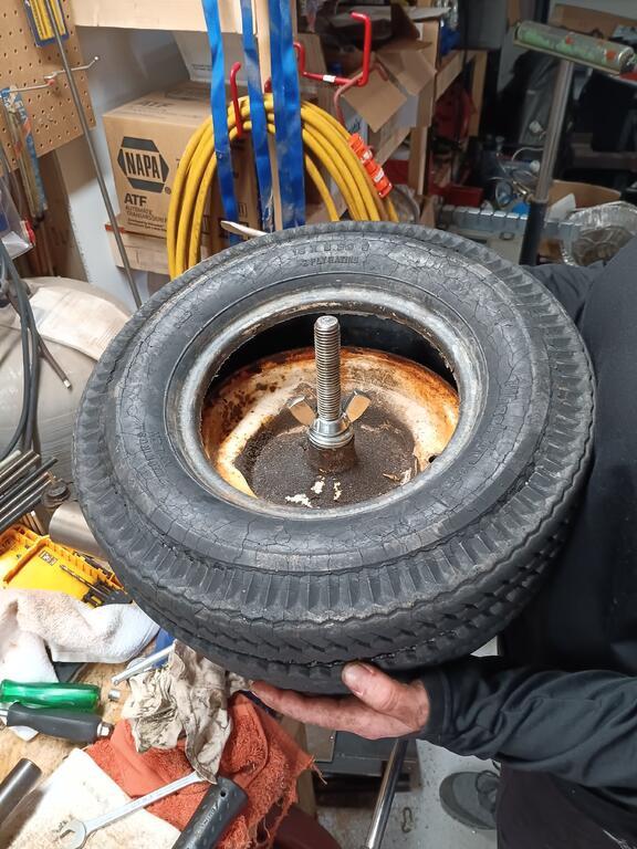

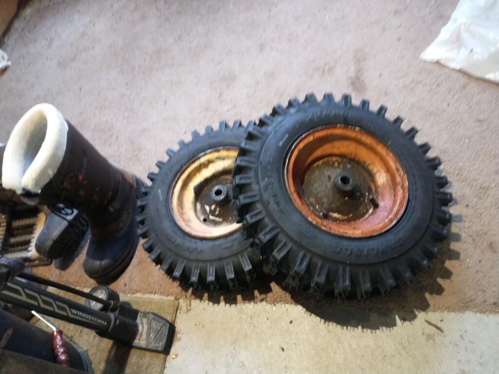

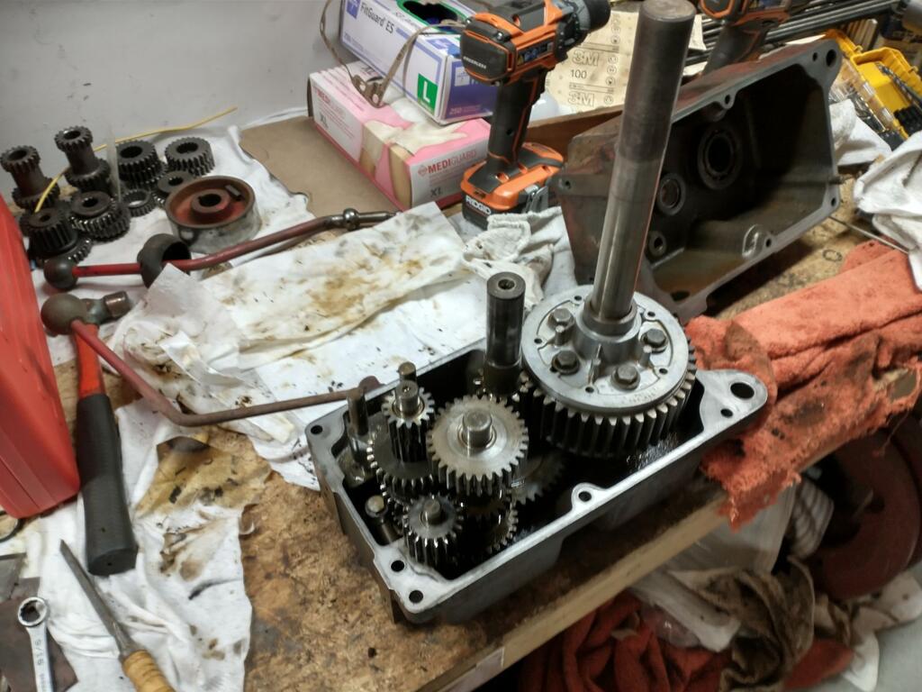

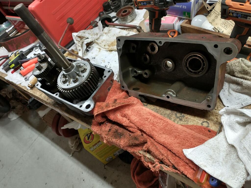

ebinmaine 80,709 #57 Posted February 18, 2024 Spent a few hours in the basement workshop today working on several projects. The BBT's 867 Pigpen was the main focus. Trina the tire changer was busy this afternoon. One rear is swapped and ready to be fluid filled with Rimguard. The other rear tire is refusing to budge using every tool trick and tip we know. We're trying to reuse the tire but it's stuck hard. She's going to call our local auto mechanic tomorrow to see if they do 12" rims. She swapped the two fronts and installed tubes. They will also be fluid filled. I got the differential torqued down with Trina's help holding it. Also got the transmission case all cleaned up, ready for reinstallation. 4 1 Share this post Link to post Share on other sites

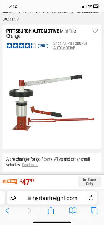

Sparky-(Admin) 26,360 #58 Posted February 19, 2024 22 hours ago, ebinmaine said: Trina the tire changer was busy this afternoon. One rear is swapped and ready to be fluid filled with Rimguard. The other rear tire is refusing to budge using every tool trick and tip we know. We're trying to reuse the tire but it's stuck hard. She's going to call our local auto mechanic tomorrow to see if they do 12" rims. She swapped the two fronts and installed tubes. They will also be fluid filled. What do you guys use for the dismounting and mounting of tires? I had the manual tire changer from Harbor Freight for like 20 years now and it’s been great! 2 Share this post Link to post Share on other sites
ebinmaine 80,709 #59 Posted February 19, 2024 2 minutes ago, Sparky said: What do you guys use for the dismounting and mounting of tires? I had the manual tire changer from Harbor Freight for like 20 years now and it’s been great! We have the larger HF Manual Tire Changer. Another of the great recommendations by fellow Redsquare crazy tractor folk. An EXCELLENT investment that payed for itself within the first few uses. For the fronts we only use it to break the beads, then use home made dulled screwdriver 🪛 tire "spoons" as levers. For the rears we use all the capability of the HF machine. One of the rears on this project is still stuck HARD at the bead. Looks like we'll have to cut it off with a Sawzall and use another set. Share this post Link to post Share on other sites

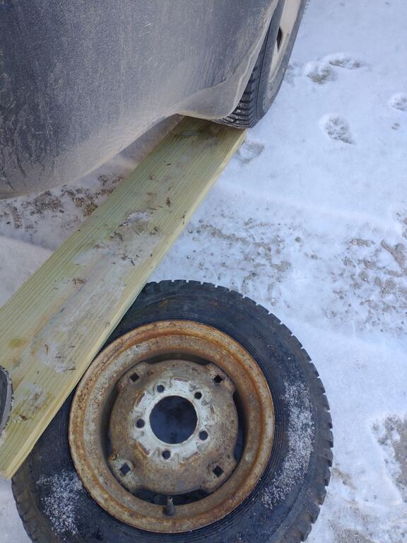

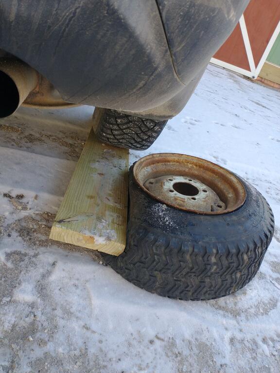

rjg854 13,359 #60 Posted February 19, 2024 (edited) @ebinmaine Put a board on the tire perpendicular to the rim and drive your truck up on the board. Has worked well for me. Edited February 19, 2024 by rjg854 Add 2 Share this post Link to post Share on other sites
ebinmaine 80,709 #61 Posted February 19, 2024 33 minutes ago, rjg854 said: @ebinmaine Put a board on the tire perpendicular to the rim and drive your truck up on the board. Has worked well for me. Problem we're having with this tire is that it has a VERY flexible sidewall along with the stuck bead. I believe the bead has been glued/cemented. These tires are a little old and did leak. They're not worth trying as hard as we already have to save them. I just was hoping to keep them usable. We've decided to switch gears a bit and upgrade to a set of Carlisle Turf Master. We have one new one here and are ordering another. 1 Share this post Link to post Share on other sites
rjg854 13,359 #62 Posted February 19, 2024 22 minutes ago, ebinmaine said: They're not worth trying as hard as we already have to save them. I just was hoping to keep them usable. I've done this a few times with stubborn tires like yours and was able to reuse them. But... New tires are always better. 2 Share this post Link to post Share on other sites
Sailman 1,307 #63 Posted February 19, 2024 If you want to save the tire to use with a tube just take it to a local indy tire shop. They can pop that thing off so easy with the power changers they use. Had to do that with one of my GT 14 rears. I have both HF tire tools and use them both but sometimes it just makes sense to let the pro's make quick easy work of it. 4 Share this post Link to post Share on other sites
Sparky-(Admin) 26,360 #64 Posted February 20, 2024 2 hours ago, ebinmaine said: We have the larger HF Manual Tire Changer. Another of the great recommendations by fellow Redsquare crazy tractor folk. An EXCELLENT investment that payed for itself within the first few uses. For the fronts we only use it to break the beads, then use home made dulled screwdriver 🪛 tire "spoons" as levers. For the rears we use all the capability of the HF machine. I have the mini…claims it does 4” to 12” wheels. I haven’t done any smaller than 6”. Ya still gotta put in some grunt to get it done but I have swapped out 100’s of tires over the years with this one. Pretty sure I paid $24.99 for it brand new 2 3 Share this post Link to post Share on other sites
ebinmaine 80,709 #65 Posted February 20, 2024 1 hour ago, Sailman said: If you want to save the tire to use with a tube just take it to a local indy tire shop. They can pop that thing off so easy with the power changers they use. Had to do that with one of my GT 14 rears. I have both HF tire tools and use them both but sometimes it just makes sense to let the pro's make quick easy work of it. We thought about it. Given the weather cracking on this existing tire it wouldn't be worth the $20 to have it done. I've had the pros do a few sets but only when the value of the tire is good. 2 Share this post Link to post Share on other sites
ebinmaine 80,709 #66 Posted February 20, 2024 56 minutes ago, Sparky said: I have the mini…claims it does 4” to 12” wheels. I haven’t done any smaller than 6”. Ya still gotta put in some grunt to get it done but I have swapped out 100’s of tires over the years with this one. Pretty sure I paid $24.99 for it brand new That may be another tool purchase for us. 4 Share this post Link to post Share on other sites
kpinnc 18,965 #68 Posted February 20, 2024 2 hours ago, Sparky said: I have the mini…claims it does 4” to 12” wheels. I haven’t done any smaller than 6”. Ya still gotta put in some grunt to get it done but I have swapped out 100’s of tires over the years with this one. I have one. There is a trick to using it, but it's worth far more than I paid for it. Smaller tires can still be a pain, and I still have to use a tire tool sometimes to help- but it does work and makes changing tires far easier. 1 Share this post Link to post Share on other sites

ebinmaine 80,709 #72 Posted February 21, 2024 26 minutes ago, SylvanLakeWH said: Tire removal with the appropriately sized tool: Front end loader Edge of bucket down on tire Lift front end off ground Tire go boom Nope. We tried every tool we have and we tried them Seven Ways to Sunday and we tried the board on the tire trick. I even got out the big framing crowbar and 8 lb sledge. No movement. This one is stuck. You folks with good access to local available tire removal sources should thank your lucky stars. I've made a few phone calls and everybody that used to do it no longer has the machinery for small wheels or, charges by the hour to do the work by hand and does not have hydraulic machines anymore. At this particular point in time our bare minimum travel would be 1/2 hour each way and somewhere between $45 and who knows how much, to get that tire off that rim. Sawzall will do it. 2 Share this post Link to post Share on other sites
