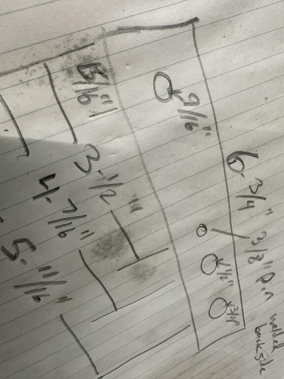

Pullstart 71,362 #1 Posted January 31, 2024 Here are measurements for making a pivot piece for the slot hitch attachments. 1 2 Share this post Link to post Share on other sites
Mike'sHorseBarn 3,703 #2 Posted January 31, 2024 Thank you so much!! 1 Share this post Link to post Share on other sites
Pullstart 71,362 #3 Posted January 31, 2024 29 minutes ago, Mike'sHorseBarn said: Thank you so much!! If you make one and it doesn’t work out, just send it here. No real reason, but I guess I’ll dispose of it for ya! 3 Share this post Link to post Share on other sites

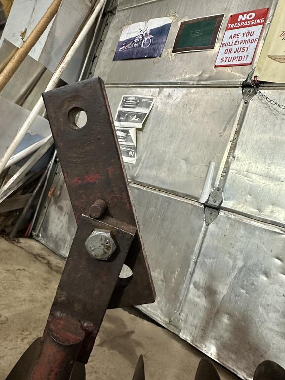

Handy Don 17,558 #4 Posted January 31, 2024 (edited) 2 minutes ago, Pullstart said: If you make one and it doesn’t work out, just send it here. No real reason, but I guess I’ll dispose of it for ya! Actually, I’ve been scouting around for some 1-¾" x ⅝" bar stock to make an adaptor for a slot hitch. I have the WH slot-to-sleeve adaptor but I want to make one with a trailer ball. Edited January 31, 2024 by Handy Don 4 Share this post Link to post Share on other sites
953 nut 69,802 #5 Posted February 1, 2024 3 hours ago, Handy Don said: Actually, I’ve been scouting around for some 1-¾" x ⅝" bar stock to make an adaptor for a slot hitch. I have the WH slot-to-sleeve adaptor but I want to make one with a trailer ball. I couldn't find any 1 3/4" X 5/8" so i bought some 2" X 3/4" and used a portaband to 1/8" slabs from three sides to make it fit. 2 Share this post Link to post Share on other sites
Achto 32,842 #6 Posted February 1, 2024 I have made some Brinly adaptors using 1 3/4 x 1/2. @WHX?? managed to bend one of my adaptors some how, We straitened it out and moved the pin hole to get the adaptor close to the slot hitch. After he had this issue I shortened my hitch up right away too. Been holding up now for the last few years. 3 Share this post Link to post Share on other sites
Handy Don 17,558 #7 Posted February 1, 2024 38 minutes ago, 953 nut said: I couldn't find any 1 3/4" X 5/8" so i bought some 2" X 3/4" and used a portaband to 1/8" slabs from three sides to make it fit. Online, the right stuff is about $1 an inch from Walmart, of all places. Minimum order is 24” but with free shipping. I only need about six or seven inches. 1 Share this post Link to post Share on other sites
WHX?? 58,302 #8 Posted February 1, 2024 8 minutes ago, Achto said: I have made some Brinly adaptors using 1 3/4 x 1/2. @WHX?? managed to bend one of my adaptors some how, We straitened it out and moved the pin hole to get the adaptor close to the slot hitch. After he had this issue I shortened my hitch up right away too. Been holding up now for the last few years. True but I was abusing it too. Since then throw in in reverse for a foot or two to get the suck point out of the furrow. World of difference on lifting it by hand or HY. 1 Share this post Link to post Share on other sites
