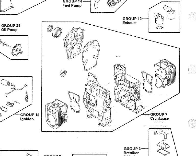

pfrederi 20,874 #12 Posted February 2, 2024 (edited) Hello KT-17s do not have an oil pan and that port leads into the oil distribution system Edited February 2, 2024 by pfrederi 2 Share this post Link to post Share on other sites
RED-Z06 2,718 #13 Posted February 2, 2024 (edited) The joy of the Kohler twin...pull cylinders, split block in half. I guess you could just replace that block half with another one Edited February 2, 2024 by RED-Z06 2 Share this post Link to post Share on other sites
pfrederi 20,874 #14 Posted February 2, 2024 (edited) I have several KT17s and one Mag 18. I did an overhaul on the Magnum 18. I like the KT17s but after that M18 I will not be rebuilding them...especially if it was a Series 1 I think I would put a cork in it and seal it up with JB weld. Not all spec KT17s had oil pressure gauges/lights.. Edited February 2, 2024 by pfrederi 2 Share this post Link to post Share on other sites
