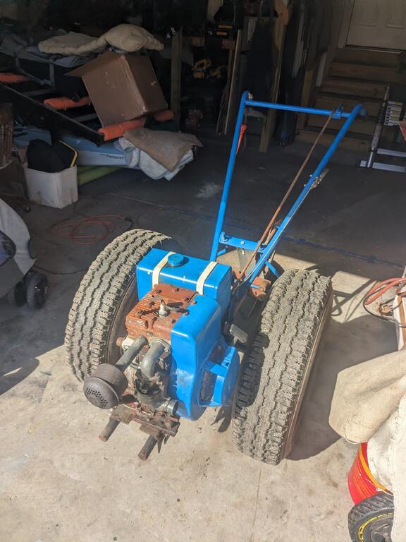

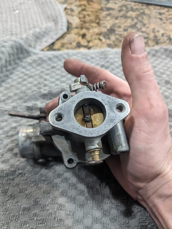

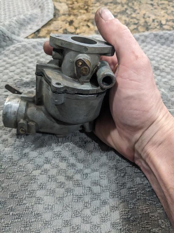

Treepep 1,151 #1 Posted January 29, 2024 Long story but last year was a bust. Unfortunately some of my equipment suffered. I am curious if anyone has any insight into separating this simple carb. A kit is ten bucks shipped. A carb is 185.00 plus shipping. Probably my favorite piece of equipment. Any help would be greatly appreciated. 1958 DB super 300 Share this post Link to post Share on other sites

lynnmor 9,058 #3 Posted January 29, 2024 Looks like you have the screws out so just pry it apart. 1 Share this post Link to post Share on other sites
WHX?? 58,310 #4 Posted January 29, 2024 I'm not a gambling man but rolled the dice on another off shore carb and now have two decent running techies. That said I wouldn't be afraid to try that Flo jet for that kinda money. Dan and I got a buddy that runs them on his Simplecity Briggs with some luck. 1 Share this post Link to post Share on other sites
gwest_ca-(File Mod) 12,518 #5 Posted January 29, 2024 Above the high speed mixture screw is a long jet that reaches the top of the carb. That jet must be removed before separating the carb halves. Can give you a tip when putting it back together so the nozzle does not leak. Make sure you have a screwdriver that fits the nozzle correctly as they are easily damaged. If this is not the correct manual let us know. 1 3 Share this post Link to post Share on other sites
Treepep 1,151 #6 Posted January 29, 2024 6 hours ago, gwest_ca said: Above the high speed mixture screw is a long jet that reaches the top of the carb. That jet must be removed before separating the carb halves. Can give you a tip when putting it back together so the nozzle does not leak. Make sure you have a screwdriver that fits the nozzle correctly as they are easily damaged. If this is not the correct manual let us know. Yes sir, that is the one. I need to remove the emulsion tube first. Many thanks Share this post Link to post Share on other sites
