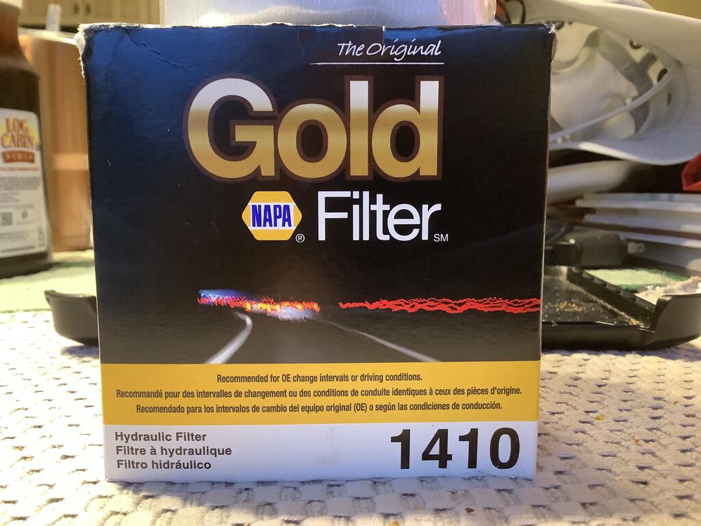

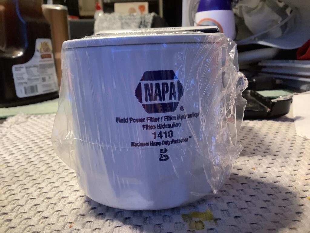

TonyToro Jr. 2,412 #1 Posted January 28, 2024 I have my C-145 with an Eaton 1100 transmission. It has the original oil and hydro filter on and I’m just now realizing that it is probably time to service the Rear end. Today I did a little research and found that a NAPA GOLD 1410 hydraulic filter would work. So I got it. But now I’m not sure what oil to put in it. It has hydraulic lift and a hydro trans so I was thinking just to put regular Hydraulic fluid in? Thoughts? Correct me if I’m wrong but the Eaton trans have the filter to the rear left and Sunstrand have them on the side right? So if I’m correct the filter is the rear left of the trans so that would make it a Eaton 1100? Share this post Link to post Share on other sites
