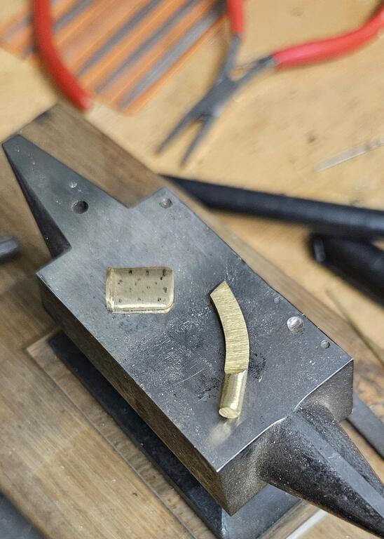

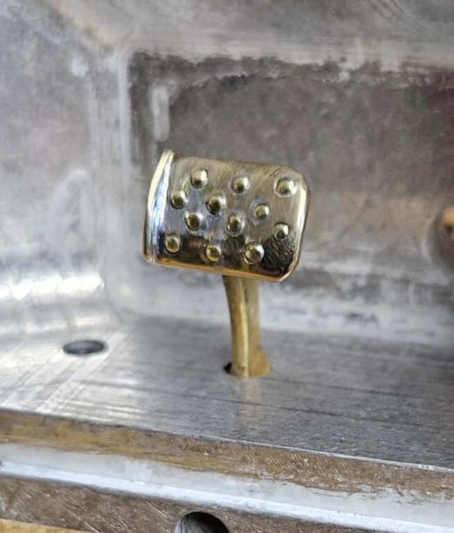

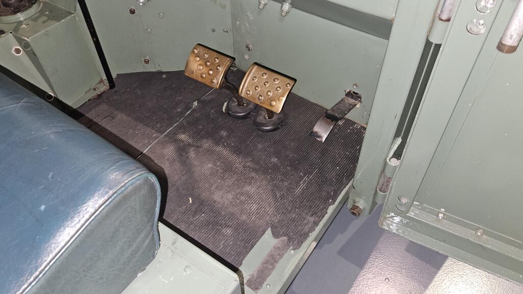

Mickwhitt 5,259 #79 Posted July 16, 2024 Phew, been a hectic few weeks away from the build bench. Garden projects and holidays took far too much of my hobby time lol. Why is the rum gone? Why is the rum always gone? Lol And my favourite, courtesy of young Frankenstein..... WHAT KNOCKERS! Anyway, back to the build... I've done some primer spraying on the chassis dear readers, but that's about as interesting as watching it dry. So today I started to Nankle (technical term in Yorkshire) with the brake and clutch pedals. The original pre-production models had cast bronze pedal heads. But as it was just after the Second World War II, bronze was in short supply so they changed them to steel. I am copying a pre-production variant so brass it has to be.... The studs cast into the face were a puzzle for me to replicate. So I drilled holes 1mm diameter and soldered brass pins in, which I then filed and polished. This is a pic of the original pedal box... 3 3 Share this post Link to post Share on other sites

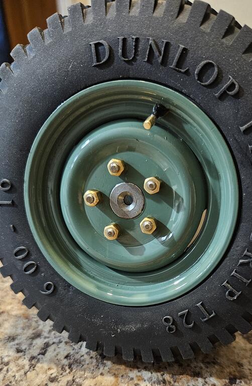

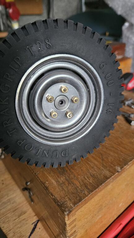

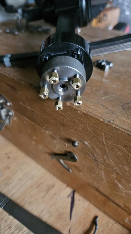

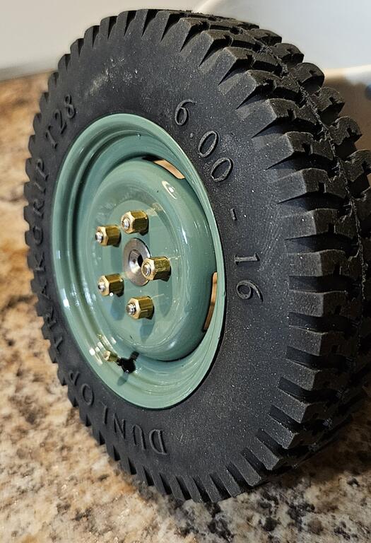

Mickwhitt 5,259 #83 Posted September 22, 2024 After yet more obstructions to my building of the model I made a start on the wheel hubs . The kit hubs were drilled at M2.5 to take plain bolts, clearly nothing like the studs and lug nuts that the full size vehicle has. I decided to enlarge the thread to M3 and make wheel studs. Not a huge job but repetitive with 5 studs per wheel. Then came the lug nuts, I used hexagon brass bar to make them. Turning a taper, drilling and tapping them M3 to suit the wheel, then parting off to length. I'm quite happy with the look and when painted up they will be just fine. 5 2 1 Share this post Link to post Share on other sites

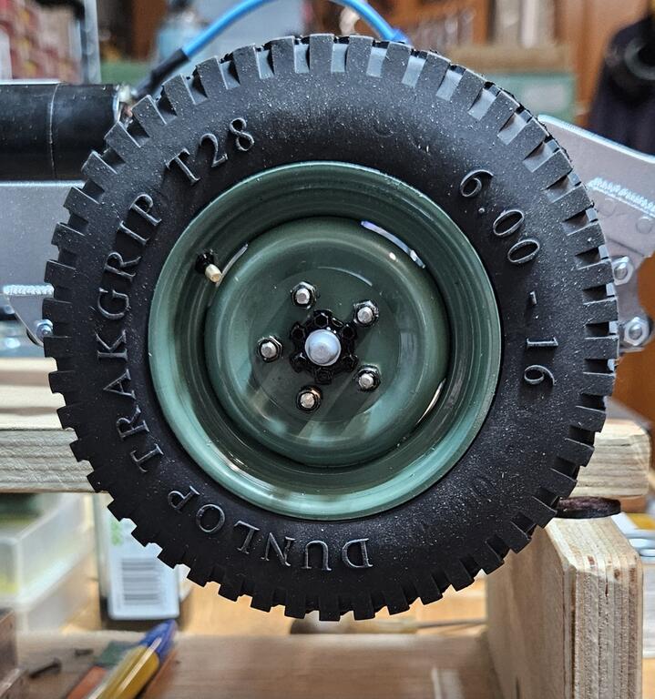

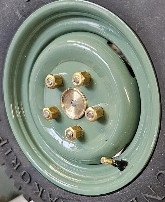

Mickwhitt 5,259 #84 Posted November 16, 2024 Wheels finally done, valve stems and dust caps made from M2.5mm bolts. Just got to make a suitable centre for the hubs now. The mode is designed to have a csk screw fitted as an extra way for retaining the hub. But it looks wrong so I'll make something to fit that looks the part. 1 5 Share this post Link to post Share on other sites
Mickwhitt 5,259 #85 Posted November 17, 2024 The centre of the rear hub now has a turned cap screw as mentioned above. Looks just like the original when painted up. 3 2 1 Share this post Link to post Share on other sites

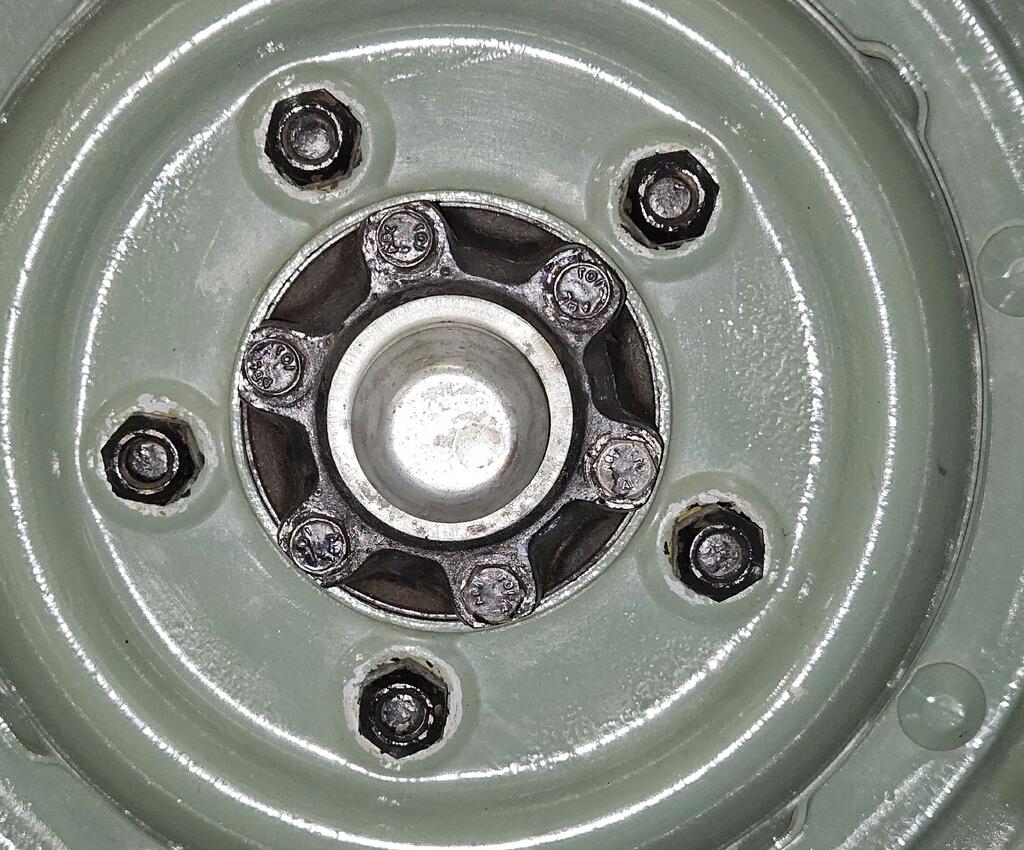

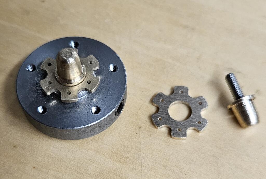

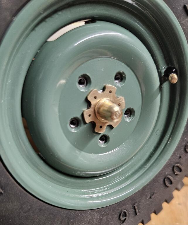

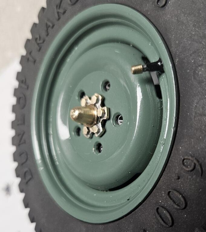

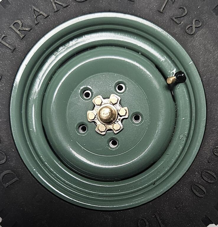

Mickwhitt 5,259 #86 Posted November 22, 2024 Made a start on the front hubs. They have a distinctive star shaped flange in the centre which is not accurately copied on the model. I decided to try and replicate this in scale and had to think about how I could do this. I decided on machining a brass plate with false bolt heads on it and a brass grease cap with a stud set in it to screw into the stub axle. With the wheel in place it looks good, just have to make 2mm headed bolts to sit in the holes in the flange. 3 2 1 Share this post Link to post Share on other sites

Mickwhitt 5,259 #88 Posted November 26, 2024 Made the 12 little bolt heads to fit on the hub spider. Fiddly little job but worth it to make things look better than the base kit. Paint next then move on to the next job. Waiting for the phone to ring with my test results is pretty trying, keeping busy makes it a lot more bearable. 1 1 Share this post Link to post Share on other sites

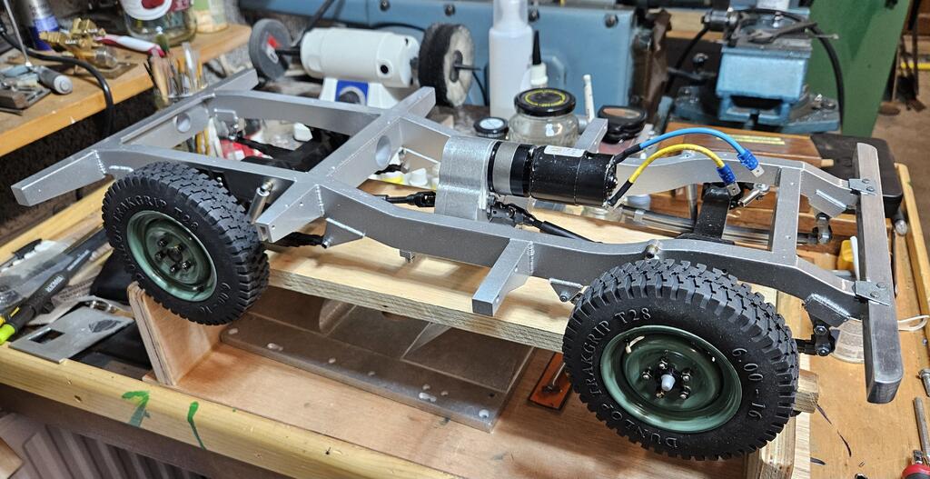

Mickwhitt 5,259 #89 Posted December 4, 2024 Just a little more progress on the wheels and hubs. The false bearing cover looks pretty tidy I think. The front axle is now mounted and the steering set up. It's starting to look a little like a motor vehicle now rather than just a chassis. I will focus on checking the electric drive train is all working before I start building up the body work. I'm really enjoying the build and there is so much more I can do to detail it. Maybe a tool box and tools. Mick 3 5 Share this post Link to post Share on other sites

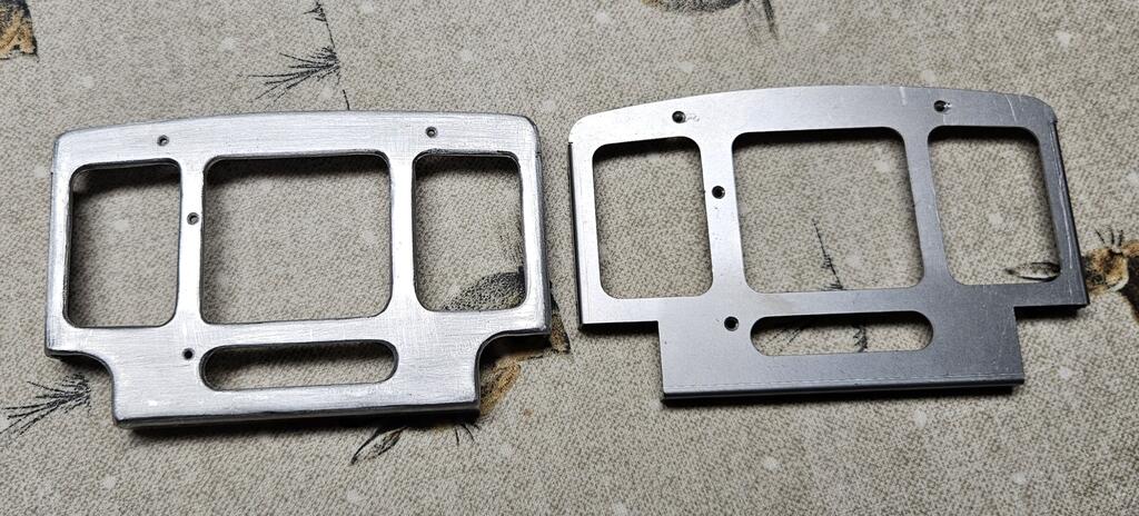

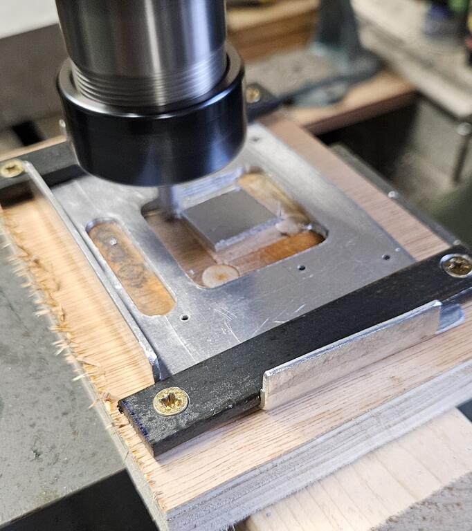

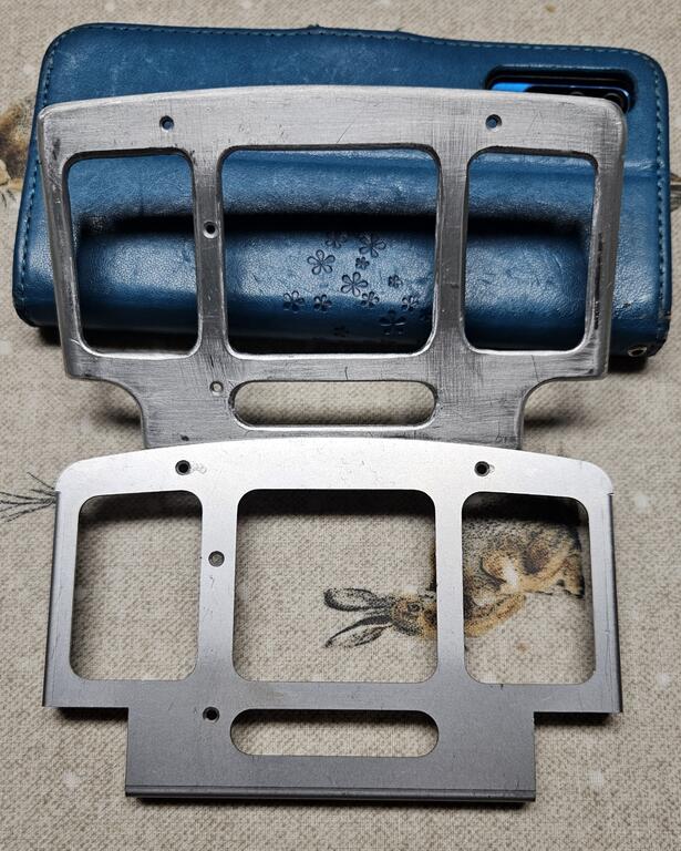

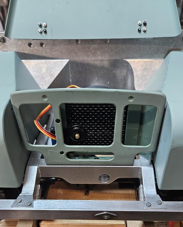

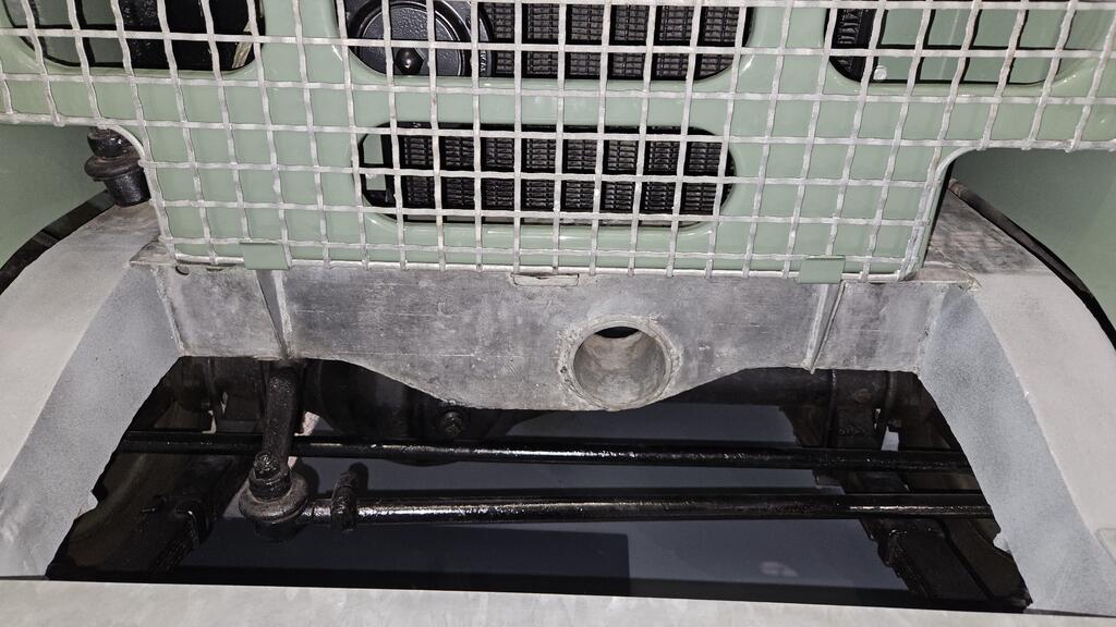

Mickwhitt 5,259 #93 Posted December 14, 2024 Started on the bodywork now, plenty of challenges on the tin work to make the kit look a bit more realistic. The bulkhead is first to be fitted, but there are issues as regards fixings for the bonnet etc that need filling to hide them. So I have to fit the bonnet and to do that I have to fit the front radiator grille panel. To do that I have to make a completely new grille panel. The kit panel is fine but there are a couple of issues. It's very thin steel and needs to look like the cut edges of the panel have been pressed with a curve to give it strength. It also has a pair of cut outs on the lower corners, these should have a radiused corner but they have been cut square. So an afternoon at the bench and a sheet of 2.5mm thick aluminium resulted in a new panel. Milling the openings in the sheet of the panel, easier than chain drilling and filing. Hopefully you can see the difference in the laser cut steel kit part and the aluminium part I handmade. The metal just wasn't thick enough to profile on the cut edges, so had to be replaced if it was to look right. 3 2 Share this post Link to post Share on other sites
ebinmaine 81,210 #94 Posted December 15, 2024 14 hours ago, Mickwhitt said: Hopefully you can see the difference in the laser cut steel kit part and the aluminium part I handmade Once one knows what to look for it's absolute night n day between the two. Very nice work here. Another excellent demonstration that having the correct tool for the job and skill to use it/them is invaluable. 1 Share this post Link to post Share on other sites

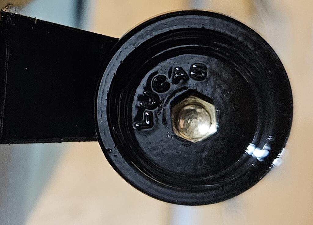

Mickwhitt 5,259 #95 Posted December 19, 2024 Carrying on with the front grille I noticed the horn unit tucked away behind there. I thought it might be nice to make a tiny copy of the unit and so i spent an hour on the lathe making a neat little facsimile of the Lucas electric horn. it's only 15mm across so it was a stretch to make the domed brass nut at M2.5 1 Share this post Link to post Share on other sites

8ntruck 9,420 #97 Posted December 20, 2024 Nice work on the horn. How did you do the lettering? Share this post Link to post Share on other sites
Mickwhitt 5,259 #98 Posted December 20, 2024 12 minutes ago, 8ntruck said: Nice work on the horn. How did you do the lettering? I have a set of letter and number stamps I had made many years ago when I was making miniature knives. The characters are only 1mm tall so they work really well in this sort of scale. 1 Share this post Link to post Share on other sites

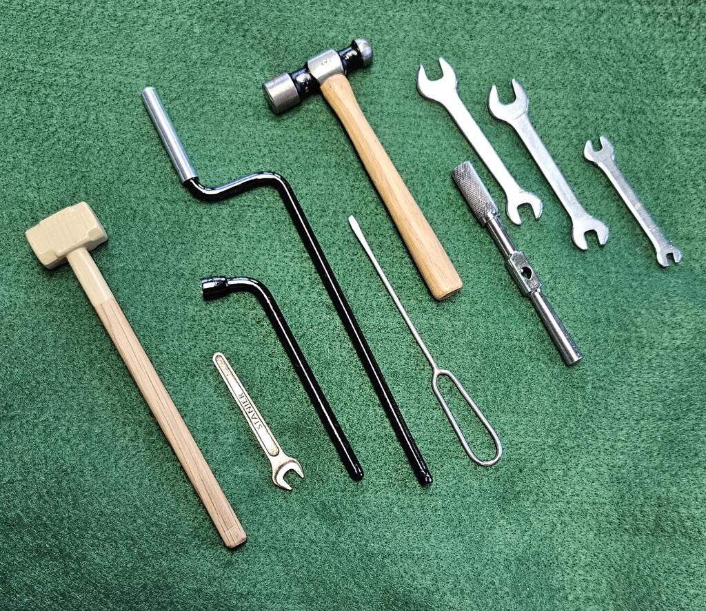

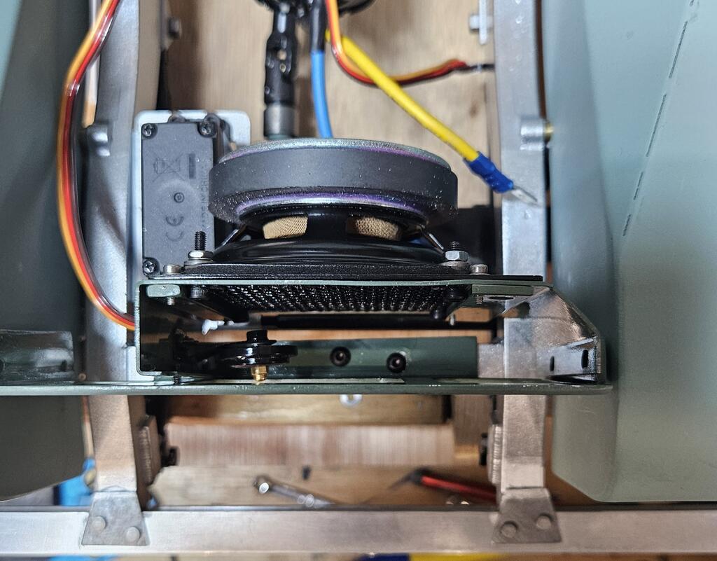

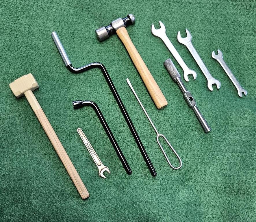

Mickwhitt 5,259 #99 Posted December 22, 2024 Few bits of progress to report... I thought a nice set of tools would look good for the Landy. Just a movable wrench to make. The front panel is coming along, I bought a smaller loudspeaker to fit onto the rear of the grille and it fits well. 1 2 Share this post Link to post Share on other sites
ebinmaine 81,210 #100 Posted December 22, 2024 Like those tools. Share this post Link to post Share on other sites
