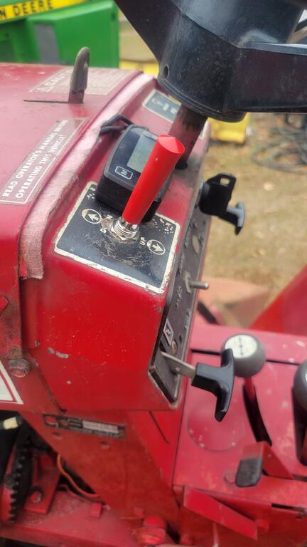

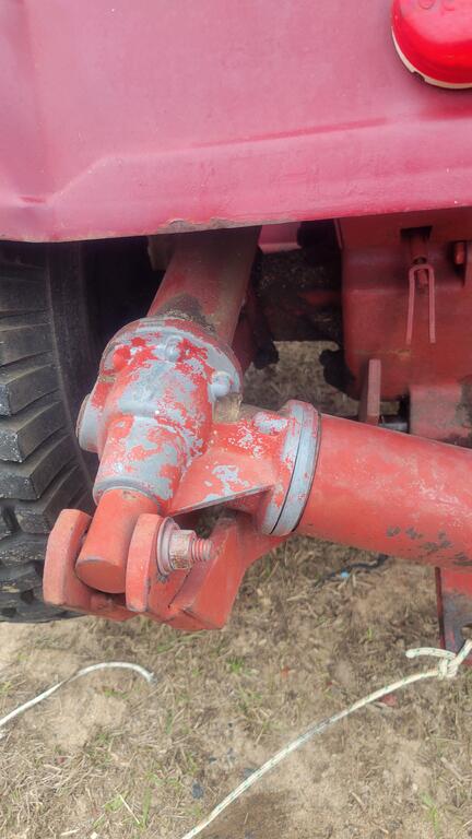

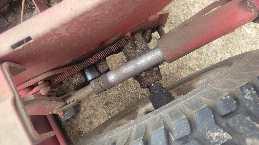

RED-Z06 2,718 #1 Posted January 24, 2024 Im not overwhelmed by the C series factory lift...its quick and relatively strong; but i worry one day the linear motor will die and im royally screwed. Ive already had to pull the motor apart, drill the case and helicoil it, had to pull the gearbox apart to lube it and set gear lash...but last week the switch broke internally. I figured out its a double pole double throw momentary on/off/on switch. I couldn't find one that was momentary that I could get in a few days so its not momentary...but i added a Allstar extender so now I can operate the lift with my hands on the wheel. 2 Share this post Link to post Share on other sites

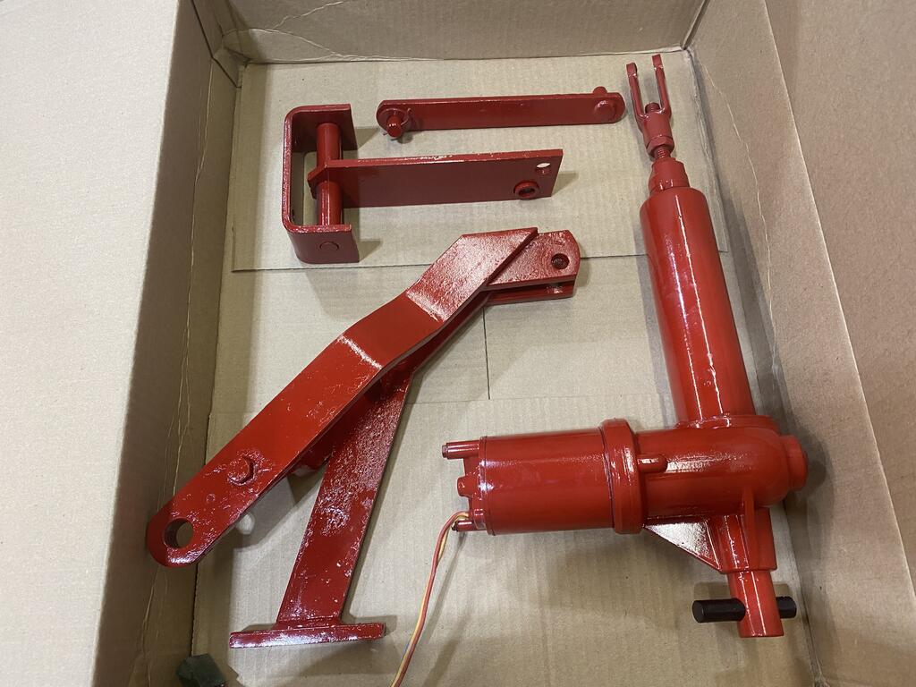

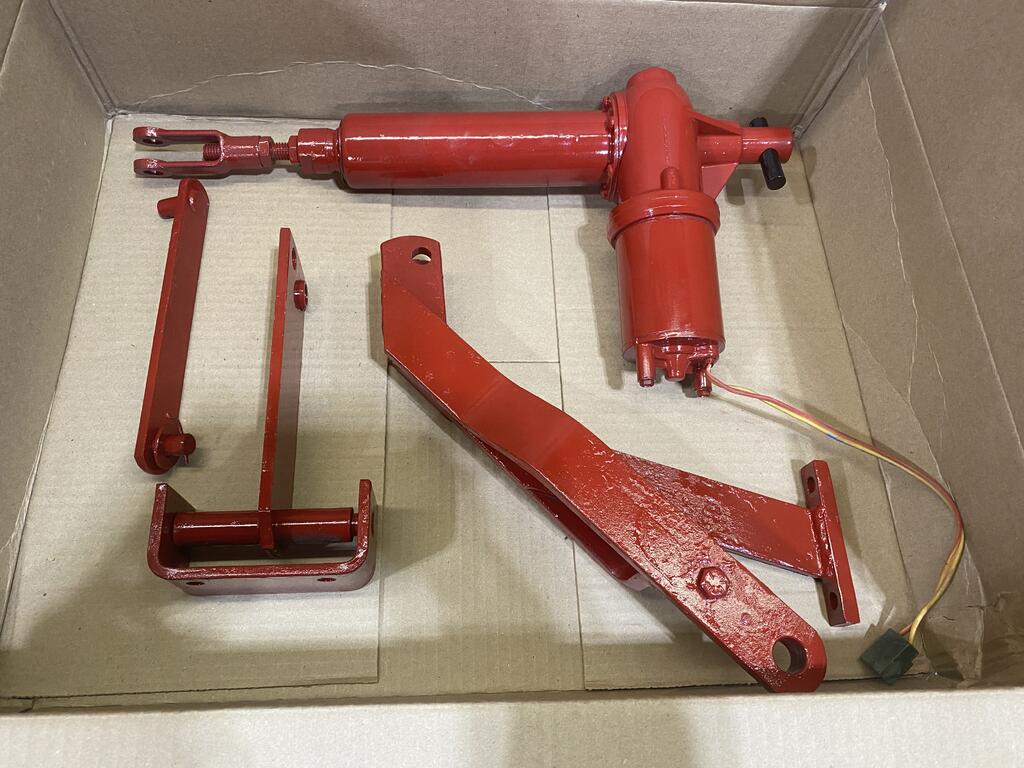

c-series don 12,114 #4 Posted January 24, 2024 @RED-Z06 What if I happened to have one? 1 Share this post Link to post Share on other sites

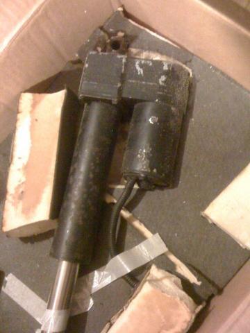

midpack 1,147 #5 Posted January 24, 2024 Ok, mine's a bit different shaped 1 Share this post Link to post Share on other sites
RED-Z06 2,718 #6 Posted January 24, 2024 3 minutes ago, c-series don said: @RED-Z06 What if I happened to have one? Man where'd you dig that up from? 1 Share this post Link to post Share on other sites
midpack 1,147 #7 Posted January 24, 2024 Like this 1 Share this post Link to post Share on other sites
c-series don 12,114 #8 Posted January 25, 2024 3 hours ago, RED-Z06 said: Man where'd you dig that up from? My basement! 2 1 Share this post Link to post Share on other sites
