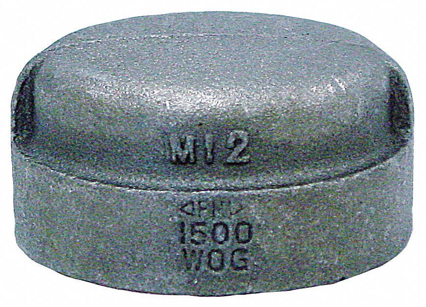

wallfish 20,658 #3 Posted January 23, 2024 What about welding a 2 1/2" pipe cap to a 3/4 rod? cap can be ground to give it some more curve 4 Share this post Link to post Share on other sites

pfrederi 21,218 #7 Posted January 24, 2024 1 hour ago, wallfish said: What about welding a 2 1/2" pipe cap to a 3/4 rod? cap can be ground to give it some more curve I made a few skids like that with pipe caps a few years ago. The wore out pretty fast on 48' plows. may have to resort to that again with a shorter life expectanccy with the heavier 56" blade. Share this post Link to post Share on other sites

wallfish 20,658 #9 Posted January 24, 2024 1 hour ago, pfrederi said: I made a few skids like that with pipe caps a few years ago. The wore out pretty fast on 48' plows. may have to resort to that again with a shorter life expectanccy with the heavier 56" blade. Maybe heat treat and quench to harden them A layer of weld bead is very hard too. Did that for the hoe teeth edges 1 Share this post Link to post Share on other sites
8ntruck 9,336 #10 Posted January 24, 2024 45 minutes ago, wallfish said: Maybe heat treat and quench to harden them A layer of weld bead is very hard too. Did that for the hoe teeth edges Heat treating an iron pipe cap won't get much. Not enough carbon in it. I've been looking for skids for my 48" plow. That pipe cap trick looks like a good idea. Most of my plow work will be over grass or gravel. Don't think wear will be that big of an issue. Share this post Link to post Share on other sites

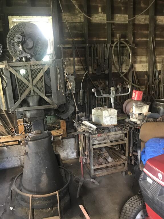

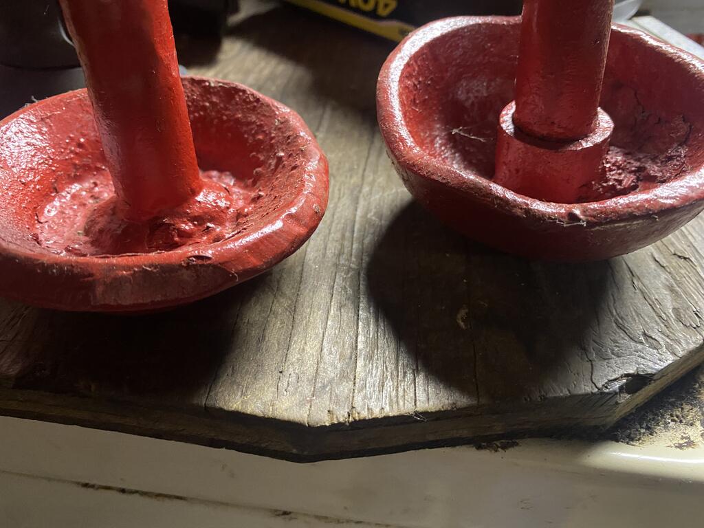

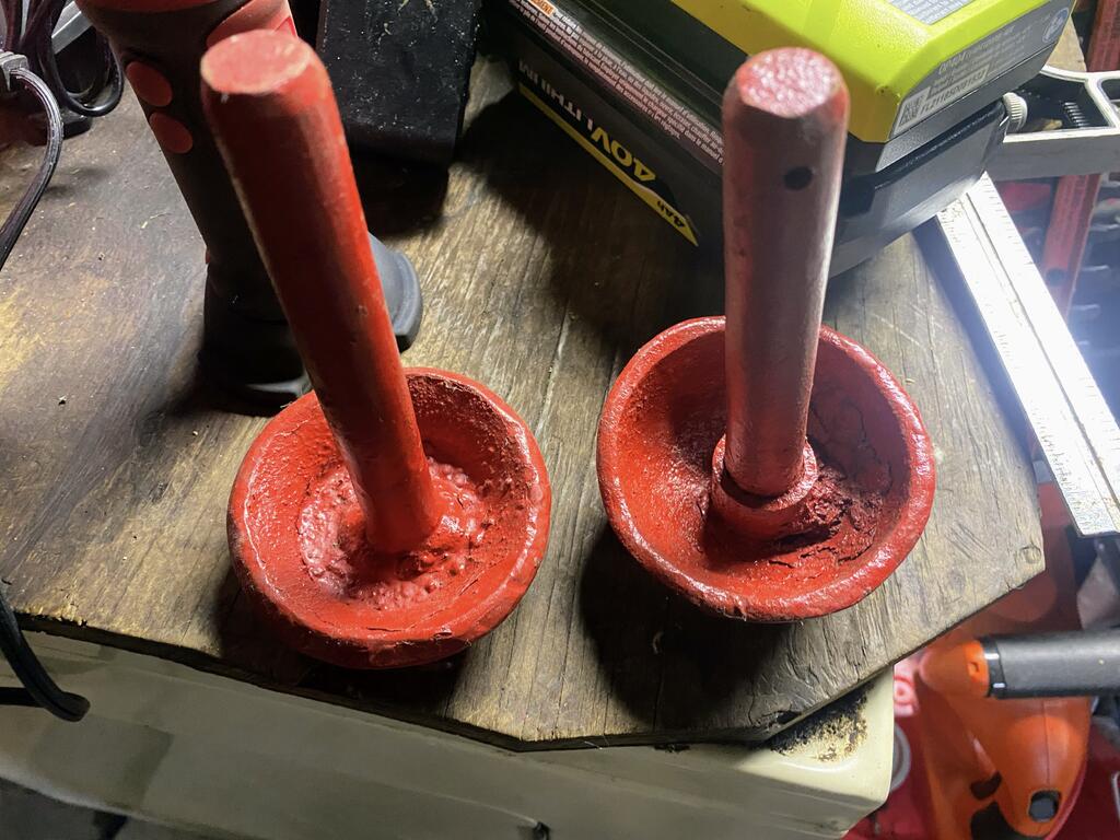

Lane Ranger 12,133 #12 Posted January 25, 2024 This snow plow skid discussion is an appropriate one! The wear and tear on the Wheel Horse/Toro skids is real! About ten years ago I told my dad that the early skids were too thin on the cup used at the end of the 3/4 inch rod on the snowplow. My dad was a blacksmith that excelled at his forging using a 100 pond power hammer. Dad did his usual math formula for metal volume first. Figured what we need to do to make a heavier cup on the end of the skid. Took about an hour and half to contemplate the volume and then 45 minutes to make two sets of new snowplow blade skids. The skids we made are in the photos below. They actually could be made with a solid cup and a 3/4 hole to weld the 3/4 rod. The snowblower skids are also in need of more meat on the bottom. This is why I liked the original cast steel wheels in the original wheel horse snowblower s over the flat skids used on later models! ********** My advice is find a local blacksmith in you area who can configure a better skid. They need the work and they can make it better and cheaper than Toro. Lat time I checked they sold the skids for $55 each! 6 Share this post Link to post Share on other sites
wallfish 20,658 #13 Posted January 25, 2024 On 1/23/2024 at 7:13 PM, pfrederi said: I made a few skids like that with pipe caps a few years ago. The wore out pretty fast on 48' plows. may have to resort to that again with a shorter life expectanccy with the heavier 56" blade. Instead of welding a rod directly to a pipe cap, weld the the 3/4" rod to a piece of threaded pipe then the pipe caps can easily be changed out as they wear. 5 Share this post Link to post Share on other sites
Handy Don 17,558 #14 Posted January 25, 2024 3 hours ago, Lane Ranger said: About ten years ago I told my dad that the early skids were too thin on the cup used at the end of the 3/4 inch rod on the snowplow. My dad was a blacksmith that excelled Why are you the only one smiling in this picture?! (And i love the subtle message on the hat, too.) 1 Share this post Link to post Share on other sites
Lane Ranger 12,133 #15 Posted January 26, 2024 9 hours ago, Handy Don said: Why are you the only one smiling in this picture?! (And i love the subtle message on the hat, too.) must of been the guy taking the picture! David is not smiling and dad is half grinning! Forget who took this picture! Share this post Link to post Share on other sites

cod 136 #17 Posted January 26, 2024 On 1/23/2024 at 7:13 PM, pfrederi said: I made a few skids like that with pipe caps a few years ago. The wore out pretty fast on 48' plows. may have to resort to that again with a shorter life expectanccy with the heavier 56" blade. Any chance that a cap from a different pipe schedule would be thicker? Don't know enough about pipe wall thicknesses, but if Schedule 80 was another 1/16" to 1/8" thick, they may last slightly long. Good luck! 2 Share this post Link to post Share on other sites
