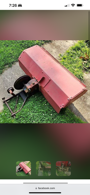

gretle_2.0 41 #1 Posted January 22, 2024 Hey guys I saw this post close to me and was wondering if this tiller would work for my 520H. Says it comes with center pulley and belt but I’m thinking I need more parts to fit it up in my tractor? 1 Share this post Link to post Share on other sites
rokon 64 #2 Posted January 22, 2024 It looks like the same one that fits on my 520h. The belt and center idler pulley are a nice bonus you don't have to look for. You do need the rear lift cable and rock shaft setup if your machine doesn't already have them to raise and lower the tiller. Oh, and the rear axle quicktach bracket, same one snowplow would mount to. 2 Share this post Link to post Share on other sites
kpinnc 19,006 #3 Posted January 22, 2024 14 minutes ago, rokon said: You do need the rear lift cable and rock shaft setup if your machine doesn't already have them to raise and lower the tiller. Oh, and the rear axle quicktach bracket, same one snowplow would mount to. Absolutely correct- and far easier to find than the tiller itself. I haven't used my tiller in years, and it will only get sold when my last tractor goes with it. While most Wheel Horse implements work well, the 36 rear tiller is truly a beast. It can do some serious work! 2 Share this post Link to post Share on other sites
c-series don 12,519 #4 Posted January 22, 2024 WheelHorsePartsandmore sells everything you need, they are a vendor here. Check the tines on the tiller if they come to a point they are worn and will not work well. 1 Share this post Link to post Share on other sites

gretle_2.0 41 #6 Posted January 22, 2024 Yeah just checked the tines from the pictures and they are definitely completely worn out :/ 1 Share this post Link to post Share on other sites

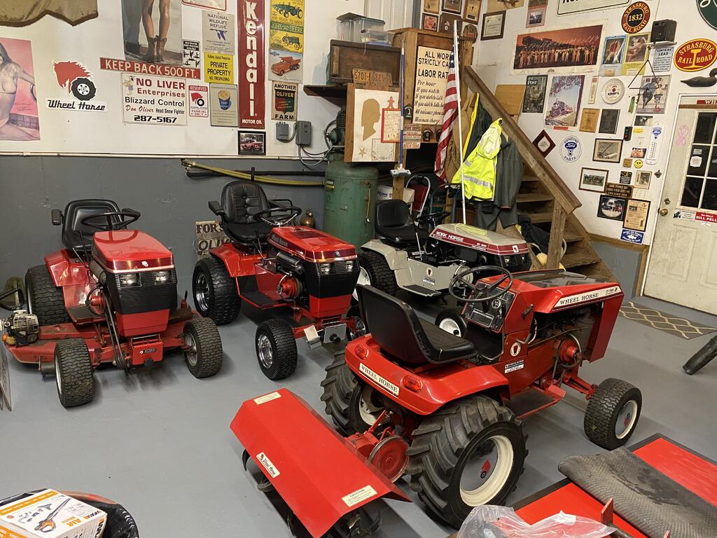

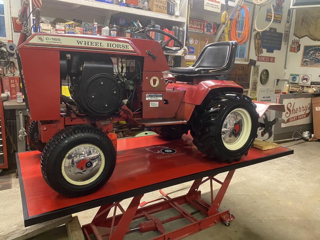

c-series don 12,519 #10 Posted January 22, 2024 That’s why I have a back up tiller tractor 😜😂 my C-165-Automatic! This tiller I bought used when I was 15 years old (almost 40 years ago) paid 100 dollars for it and it’s on its third set of tines. I am in the process of restoring another tiller for the 418-8. No idea why I have two rototillers and no garden?🤣 I only till 12 horseshoe pits once or twice a year for my fire department’s fundraiser. 1 5 Share this post Link to post Share on other sites
Brockport Bill 2,480 #11 Posted January 22, 2024 luvin the photos of your collection Don 2 1 Share this post Link to post Share on other sites

lynnmor 9,050 #13 Posted January 22, 2024 I searched for the tiller the OP was interested in and found it. I have never seen tiller blades worn so much, just straight blades remaining. I believe that A-Z Tractor was selling a blade kit for considerable money. I use a tiller on my 520H tractors and find it is pathetic because of the pushing of the hydro and the shallow depth of cut. To plant a garden, plow first and then till to break up the clods. YMMV. 1 Share this post Link to post Share on other sites
Bill D 3,168 #14 Posted January 22, 2024 14 hours ago, c-series don said: That’s why I have a back up tiller tractor 😜😂 my C-165-Automatic! This tiller I bought used when I was 15 years old (almost 40 years ago) paid 100 dollars for it and it’s on its third set of tines. I am in the process of restoring another tiller for the 418-8. No idea why I have two rototillers and no garden?🤣 I only till 12 horseshoe pits once or twice a year for my fire department’s fundraiser. Love the shop. What brand of air compressor is that? Looks like an older Champion. 1 Share this post Link to post Share on other sites
c-series don 12,519 #15 Posted January 22, 2024 Just now, Bill D said: Love the shop. What brand of air compressor is that? Looks like an older Champion. That sir is a Dayton Speedair that actually came from Rolle Bros. Which was the local Wheel Horse dealer, now long gone. 2 Share this post Link to post Share on other sites
Easton Rich 1,268 #16 Posted January 22, 2024 Don I love the chrome on the 400 series back there! 1 2 Share this post Link to post Share on other sites
c-series don 12,519 #17 Posted January 23, 2024 @Easton Rich That’s my 420-LSE, has 22 original hours on it and signed by Cecil Pond. I’d park it in my living room if I could!! But number one it won’t fit through the door and number two I like being married if you know what I mean!! 1 Share this post Link to post Share on other sites
