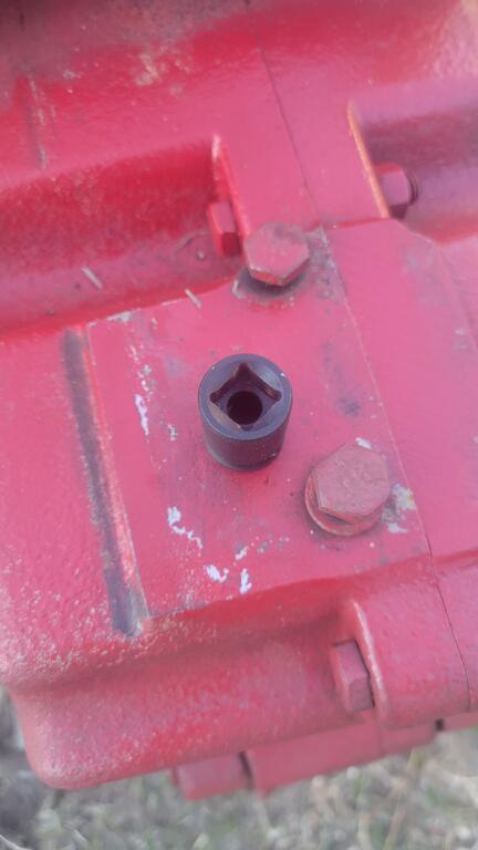

RED-Z06 2,718 #1 Posted January 21, 2024 A few years ago I had a customer mower, shaft driven deck...that had a gearbox with a female square pipe plug and it wasn't 1/4, 3/8, or 1/2"...the kit with male and female was cheap enough on ama zon, so i got it. While removing my 702 hubs today i was adjusting my vice grips and thought Hey Wait...sure enough i had one that fit. 5 1 Share this post Link to post Share on other sites
8ntruck 9,057 #2 Posted January 21, 2024 Probably much better than a 12 point socket. 3 Share this post Link to post Share on other sites
RED-Z06 2,718 #3 Posted January 21, 2024 1 minute ago, 8ntruck said: Probably much better than a 12 point socket. Its a good positive fit, no chance of slippage even on these old bolts 3 Share this post Link to post Share on other sites

squonk 47,419 #5 Posted January 21, 2024 8 point sockets. I have a complete set 4 Share this post Link to post Share on other sites

Tonytoro416 1,372 #11 Posted January 21, 2024 I have a few sets of 8 point and pipe plug sockets. Need both internal and external though. Work great 4 Share this post Link to post Share on other sites

pfrederi 20,874 #24 Posted January 22, 2024 If you are caught short remember that 12 pt sockets will work on the square heads. for example the 3/8 square head on hub set screws can use a 7/16 12 pt socket. 3 1 Share this post Link to post Share on other sites
