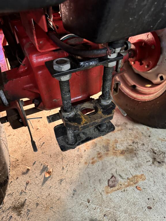

RKCrizzle 16 #1 Posted January 20, 2024 I'd like to replace this hitch with a more traditional tow hitch adapter that would better agomedate a weight box or an actual hitch adapter. I have a Big Tool Rack Yard Rack (picture attached) that attaches to a traditional hitch setup. Is removing this existing hitch going to hurt anything? Id also be interested to see different setups y'all are running. Thanks guys. 4 Share this post Link to post Share on other sites

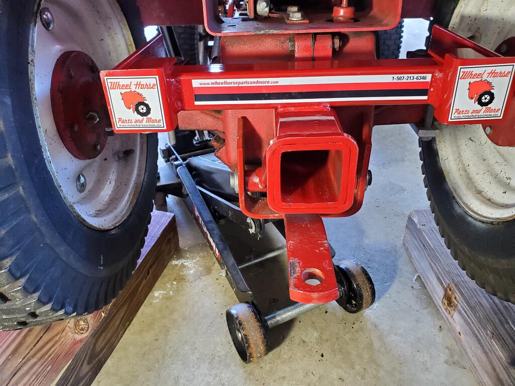

ebinmaine 80,912 #2 Posted January 20, 2024 That's a neat handy tool/stuff carrier. I don't imagine removing the existing hitch would do any harm but be VERY conscious of not getting any crud in the top bolt holes during removal. Those holes are directly open into the transmission. As to a new aftermarket hitch I'd recommend the one from Wheelhorsepartsandmore for the reasons of strength, ease, and efficiency of changeover. 7 Share this post Link to post Share on other sites

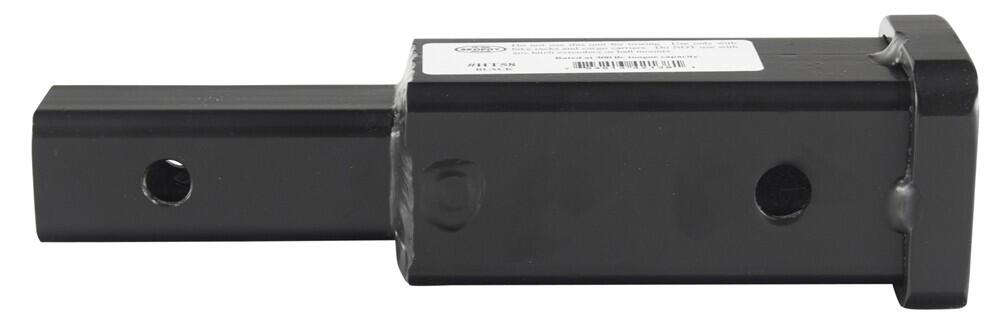

wallfish 20,658 #5 Posted January 20, 2024 Or, you could leave it and use it to pinch something like this into it. https://www.tractorsupply.com/tsc/product/curt-receiver-hitch-adapter-(2-in-shank-2-in-drop-7-500-lb)-45797 Or, there's lots of different other hitch adapters available. 2 Share this post Link to post Share on other sites
