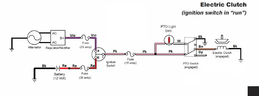

OoPEZoO 578 #4 Posted January 20, 2024 Correct......pretty much all safety related things kill the ignition, and this model does not disable the PTO on reversing. I've dug through the diagrams and can't come up with a safety switch scenario that could be causing the issue. It could easily be a connection issue somewhere. I did come up with the possibility of a weak battery, charging system, or loose battery connection that could cause it. Essentially, as soon as you start putting a load on the engine, the system voltage drops, and the electric PTO releases. The tractor starts easily, but we know that doesn't mean the battery isn't weak. I have zero history on its age or care, so its on my list to check out. I did toss a battery tender on it this evening to top it off as its been sitting for month+. I also messed with the PTO button itself and it seems to be working correctly and will reliably engage/disengage the PTO while the engine is off. I need to play with it some more, but I'm not keen on running the engine in the garage, and the weather isn't exactly ideal for outdoor troubleshooting. I'm already very much looking forward to stripping this tractor down in the spring and giving it a proper check out and cleaning. Share this post Link to post Share on other sites
gwest_ca-(File Mod) 11,875 #5 Posted January 20, 2024 This should take you to a thumbnail drawing of the wiring in color. Click on the fuzzy part of the link. 1 Share this post Link to post Share on other sites

JoeM 9,330 #8 Posted January 20, 2024 Your right not much there to go wrong. If the battery checks out take a closer look at these things maybe twice. Check charging voltage should be 13 with the clutch on. I have had some electrical issues with the connection to the ignition switch. Sometimes the plug will melt a bit. Also, make sure the 30 amp and 10 amp fuses are making up good. They I have found those melted and not making good contact. The solenoid plug in on the right side of the engine. check that connection as well as the ground. It hooks up at he base of the engine mounting bolt. Share this post Link to post Share on other sites

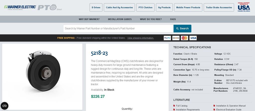

JoeM 9,330 #10 Posted January 20, 2024 Yeah that is an issue not being inside, especially when they get older. Do take a good look at that ignition sw and fuse connects knowing it has been left out. Hope this helped. Just a little bit more info. Here is the service manual for the clutch. It is a Warner 5218-23 (Toro Part #94-2190) p-1177-we Warner xi electric clutch manual.pdf Share this post Link to post Share on other sites
OoPEZoO 578 #11 Posted January 20, 2024 Ahh…sweet. I hadn’t dug that up yet. Thank you Share this post Link to post Share on other sites
