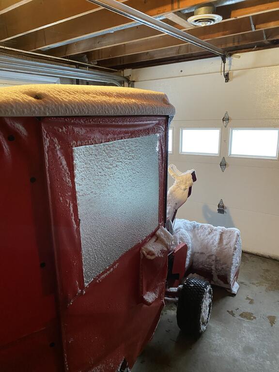

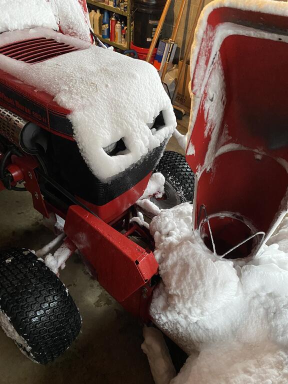

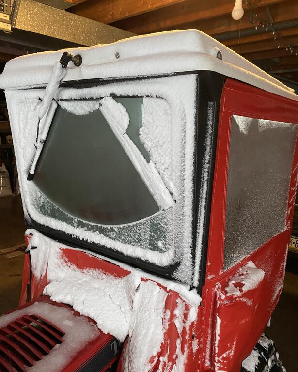

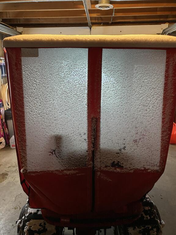

Jody14 12 #29 Posted February 4, 2024 On 1/19/2024 at 5:12 PM, lynnmor said: These photos will show you what to expect with a cab and LED headlights. As you can see the LEDs don't get hot enough to melt the snow and the only usable window in the cab is the wiped area of the glass windshield. I have no clue if I'm messaging on this site properly. I was wondering what model cab you have that has the glass windshield and windshield wiper. I think it's taking me just as long to figure out how to learn this page as it is learning about wheel horse tractors. 🤣 1 Share this post Link to post Share on other sites
JCM 11,419 #30 Posted February 4, 2024 The glass windshield and wiper is an option on the cabs. They were a bit pricey. The plastic windshield is a separate piece that uses velcro if I remember correctly. Remove that and install the glass one if it's still available. Don't think they produce those for the 3,4 and 500 series tractors anymore, but may still offer the glass/ wiper set up. @Jody14 1 Share this post Link to post Share on other sites

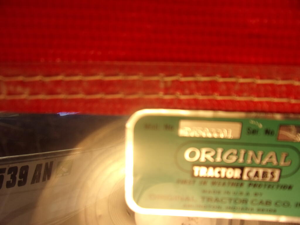

grinchsr 674 #31 Posted February 4, 2024 I have 2 cabs the newer one is model #79978 and the older one is #79943. They are both identical except for the door latches and one has a white roof and the other is black. One is on a 417 the other is on a 416. 2 Share this post Link to post Share on other sites

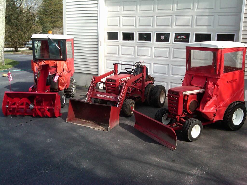

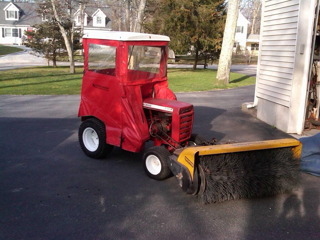

c-series don 12,519 #32 Posted February 4, 2024 I have two tractors with cabs. A 417-A and a C-141 8-Speed. I found the glass windshield lying in the woods behind a Ford New Holland dealer. Added a wiper, lights and heat. 2 2 Share this post Link to post Share on other sites

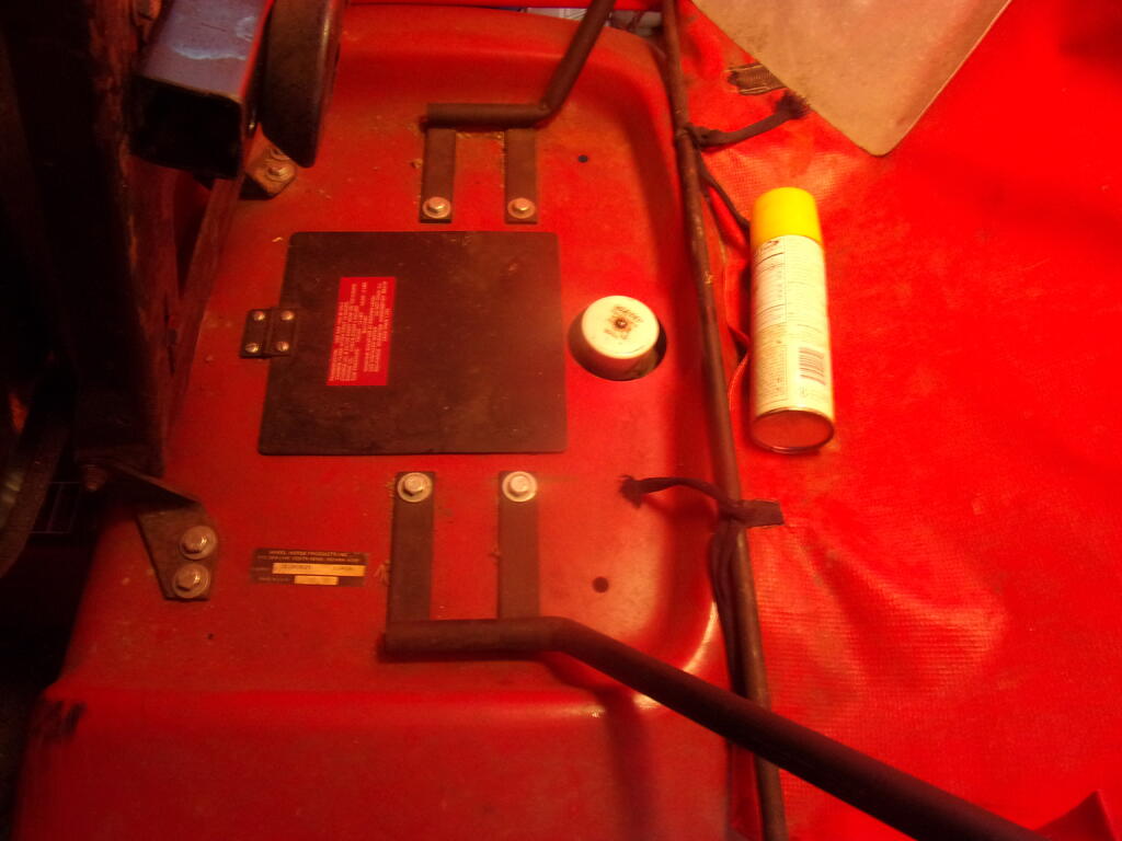

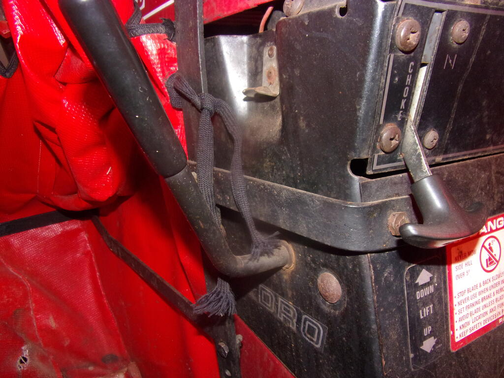

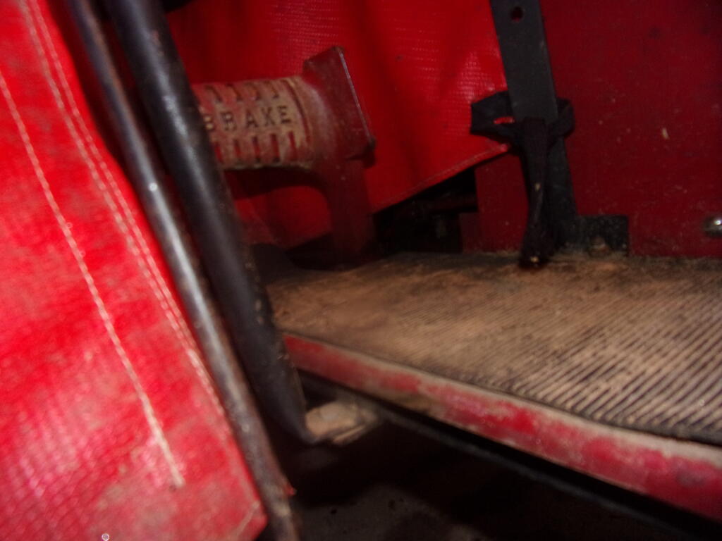

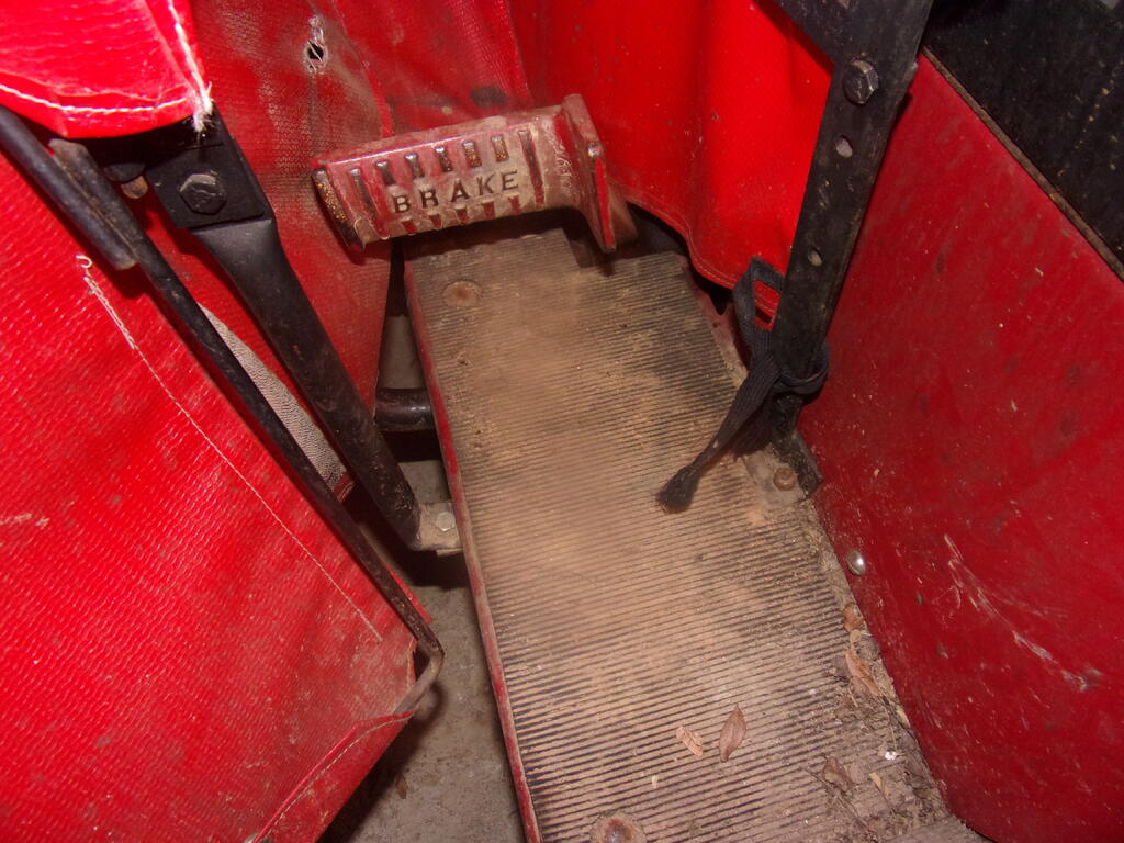

Ed Kennell 47,594 #33 Posted February 4, 2024 1 hour ago, Jody14 said: That would be fantastic. If it's no trouble if you can find what model number your cab is would be great also. My cab model number is P650CC01. Serial number is 378 Mine has the plastic windshield. Here are a few pics of the frame mounting . This is on my 520H tractor. 2 1 Share this post Link to post Share on other sites

Jody14 12 #35 Posted February 4, 2024 44 minutes ago, Ed Kennell said: My cab model number is P650CC01. Serial number is 378 Mine has the plastic windshield. Here are a few pics of the frame mounting . This is on my 520H tractor. Nice setup. I like the way yours mounts up. Mine isn't even close with the brackets on it. The model number on mine isn't even one I was sent brochures on by original cab. I am wondering if mine is even for a wheel horse. 1 Share this post Link to post Share on other sites

c-series don 12,519 #37 Posted February 4, 2024 @Jody14 I can get you a model number off the cab on my 417 if you would like. Jim’s pictures are the same cab. 3 Share this post Link to post Share on other sites
lynnmor 9,050 #38 Posted February 5, 2024 4 hours ago, Jody14 said: I have no clue if I'm messaging on this site properly. I was wondering what model cab you have that has the glass windshield and windshield wiper. I think it's taking me just as long to figure out how to learn this page as it is learning about wheel horse tractors. 🤣 I replied to your PM. 2 Share this post Link to post Share on other sites
