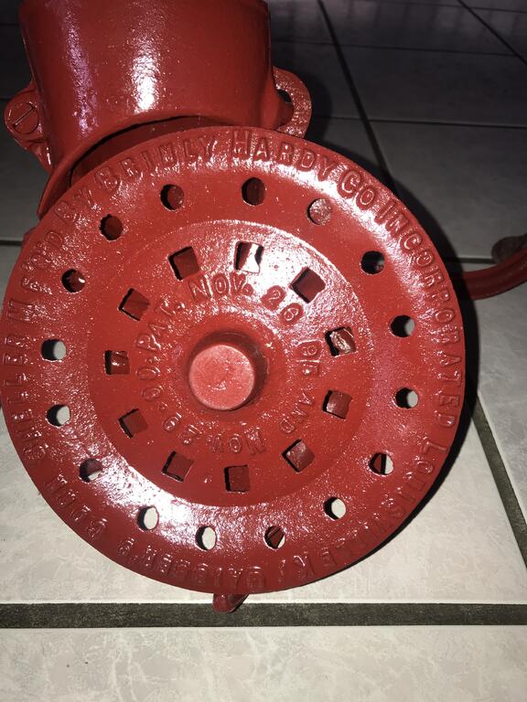

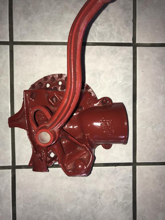

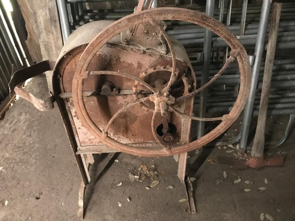

oliver2-44 11,272 #2 Posted January 16, 2024 (edited) On our farm there was the remains of a rotting/falling down log cabin corn crib. The corn crib had a lean too shed on one side that was part of a hog pen. Many years ago I pulled this IHC corn sheller out of it. It had a hand crank handle on the other side. The inner cogged looking wheel should have a old style round leather belt (like treadle sewing machines used) and it went down to that small lower pulley which is a blower that would blow dust out of the kernels as they fell. Although rusty, I was able to free it up with penetrating oil and it works as it should. It is missing a tray on the top that would help feed corn into the Sheller The IHC can still be faintly read on it. There was also this Red Chief hand sheller. It was rusted solid. A few years ago I freeded it up with a lot of heat from a rosebud torch. Then I went ahead and blasted and painted it since that ruined the rusty patina. The round wheel pictured below has this cast on it. Gaissler's Corn Sheller Mf'GD by Brinly Hardy Co Incorporated Louisville Kentucky PAT Nov 26 (18)98 and Nov 28 (18)88 This is the same Brinly Hardy Co that makes implements for our garden tractors today. In the 1920's there were four clapboard 2 room Share Cropper cabin's on the lower part of our farm, They were around a common well with a windmill. The log corn crib was a little ways from the 4 cabins. My mom says the land owner at that time owned roughly 500 acres and our farm was part of that. He leased the land out to those tenants to farm on shares. When Dad bought the farm in 1948, He moved those cabin's and put 2 of them together with a large room between them to make a 5 room house. It was lived in by hired help who worked with dad on the Grade A Dairy he had at that time. As a young teenager I helped dad sheetrock and rewire the inside of it to use as just a rent house. Hope I didn't get too far off you Sheller thread 953. Edited January 16, 2024 by oliver2-44 3 3 Share this post Link to post Share on other sites
953 nut 64,323 #3 Posted January 17, 2024 1 hour ago, oliver2-44 said: Hope I didn't get too far off you Sheller thread 953 This is exactly the type of interaction I had hoped this series of postings would generate. The small hand cranked corn sheller you have is much like one our tractor club would set up at shows and the county fair along with a hand cranked corn meal grinder. The little children had a ball shelling and grinding corn, we just had to watch to be sure on little fingers get caught in the gears. Good to know that the manufacturer of the sheller is still in business. 1 Share this post Link to post Share on other sites
