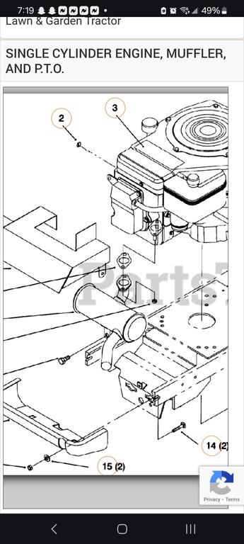

lanc 0 #1 Posted January 15, 2024 The horse is getting loud. Any muffler ideas that are a close fit for a 264h? Share this post Link to post Share on other sites
WHX?? 57,458 #2 Posted January 15, 2024 Sure it's a Kohler and not a Briggs? Pic of the engine nameplate would be a big help. Share this post Link to post Share on other sites
Achto 32,103 #3 Posted January 16, 2024 3 hours ago, WHX?? said: Sure it's a Kohler and not a Briggs? Should have a Kohler CV14S, 14hp vertical 1 Share this post Link to post Share on other sites
WHX?? 57,458 #4 Posted January 16, 2024 I came up with a 16 twin Vanguard Dan ??? Anyhoo @lanc if we can come up the with model and chase that down to a ipl and the CORRECT part number chances are good you'll find them all over. Be advised same engine might have been sold with many different muffs. 1 Share this post Link to post Share on other sites
RED-Z06 2,718 #5 Posted January 16, 2024 CV-14S is correct...and as Toro does, its a bespoke design for the 26X series.. And discontinued Toro 926862 2 Share this post Link to post Share on other sites
lanc 0 #6 Posted July 16, 2024 This is correct it is a Kohler cv14s. What is the common work around for the discontinued part? Share this post Link to post Share on other sites
RED-Z06 2,718 #7 Posted July 16, 2024 28 minutes ago, lanc said: This is correct it is a Kohler cv14s. What is the common work around for the discontinued part? No known workaround, how its mounted is pretty unique..i guess you could try to fab it out the side to a stack. Share this post Link to post Share on other sites
