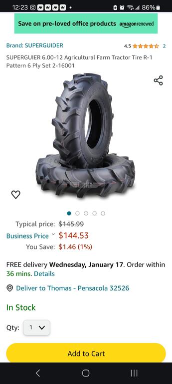

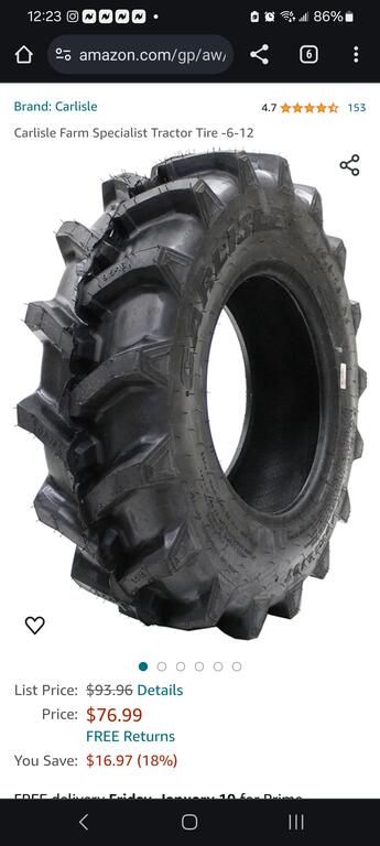

RED-Z06 2,718 #1 Posted January 14, 2024 I know 6.00-12 is about an inch taller than 6-12, and usually a bit thicker, im looking at Carlisle Tru-Power 6-12, Carlisle Farm Specialist R1 6-12, and an offbrand 6.00-12, i can get a pair of any of them around 150 so price is not a big deal. Anyone used these on a round hood, did they fit well? 1 Share this post Link to post Share on other sites

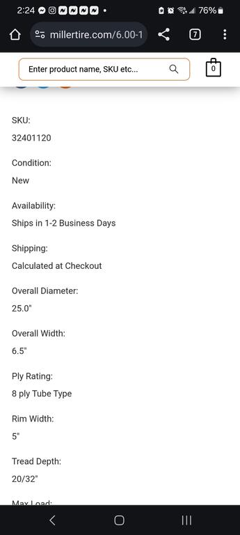

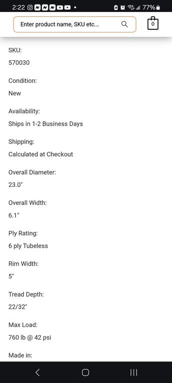

RED-Z06 2,718 #5 Posted January 14, 2024 6-12 specs at 23" to 23.3" across various brands. 6.00-12 specs at 24.5"-25" across brands. 2 Share this post Link to post Share on other sites
Handy Don 17,043 #6 Posted January 14, 2024 The 25” tires over the 23" would up your speed in each gear by ~8% . Hoo Hah! 2 2 Share this post Link to post Share on other sites
