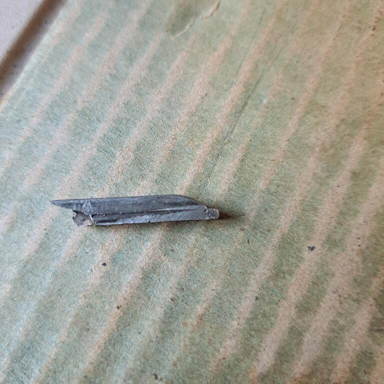

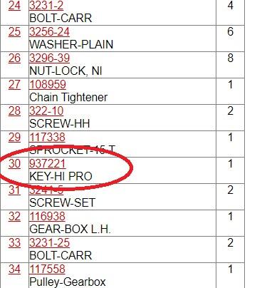

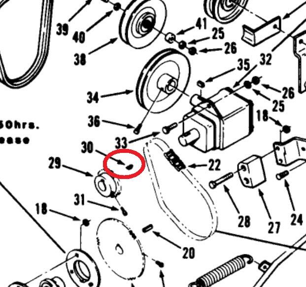

HorseFixer 2,015 #1 Posted January 14, 2024 (edited) Well it was fun while it lasted!! We finally got a Snow That was worth getting the Snow Chucker out and the fun lasted all of about 15 minutes. I was in the front of the drive and musta got close to some rocks I had along the front porch and I heard a rattle and noticed the blower NO WORKEY. After pulling it into the garage and taking the cover off. I discovered a Key part # 30 which Toro calls it 937221 KEY-HI PRO must have sheared cause MR. SPROKET spins freely on the GEARBOX Shaft when turning the belt. I came into get some coffee and to think about it a minute so OLE HORSEFIXER will get his GAME face on and see if i can go fix it. Has anyone had this problem before? I know there is a shearpin somewhere I just never have run into it. Anyway ARE WE HAVING FUN YET? ~Duke Edited January 14, 2024 by HorseFixer 2 Share this post Link to post Share on other sites

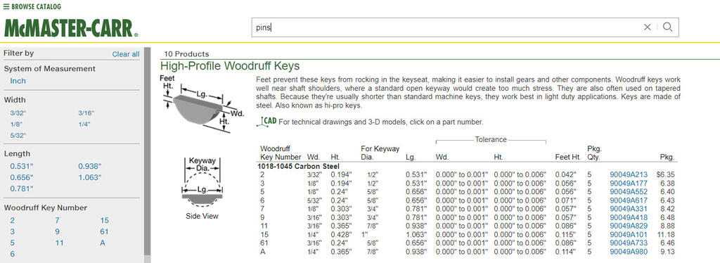

WHX?? 58,388 #2 Posted January 14, 2024 Yep been down this road. Well kinda ... when I went through my deuce that key was battered up good. I just replaced it then and there. Does yours have little ears on the end like this? That's what the hi-pro means. High profile. McMaster has them. I ground one out of key stock. 1 Share this post Link to post Share on other sites

wallfish 20,744 #5 Posted January 14, 2024 11 minutes ago, HorseFixer said: Yes it does mean HIGH PROFILE but Ole Hillbillys like me call them WOODRUFF KEYS The HP (high profile) on the woodruff key is the little extra flat on the top edges that extends past the curve. You can see it on the second illustration, the side view you posted for McMaster Carr. Also don't know if those metric ones you got will fit as tight but maybe file a bigger one down to cover both bases. 3 Share this post Link to post Share on other sites

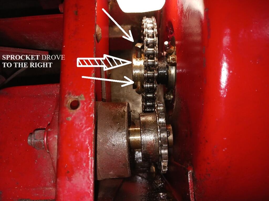

HorseFixer 2,015 #6 Posted January 15, 2024 (edited) Well I ended up having to remove the chain because the larger sprocket was out of alignment. After I loosened the square head bolts i drove the sprocket over to the right, to put it back in alignment. This all took way too much time prolly 8 hrs (after the STROKE I had 6 years ago, I aint as good as I once was, but I'm as good once as I ever was!) The MASTER LINK I had to take out took out had it had a TINY PIN that had a half moon on one end then had a TINY COTTER KEY to afix the pin. ( IT ALL WAS A REAL POOTA!) I finally finished up and chucked the drive. All went well after that with no further surprises. I found a Woodruff Key in that metric kit that fit like a glove. I think being the larger pulley was out of Alignment it tended to pull the smaller pulley over in that direction which MUCKED UP the Woodruff Key. ~Duke of SPROCKET ALIGNMENT Edited January 15, 2024 by HorseFixer 2 Share this post Link to post Share on other sites
