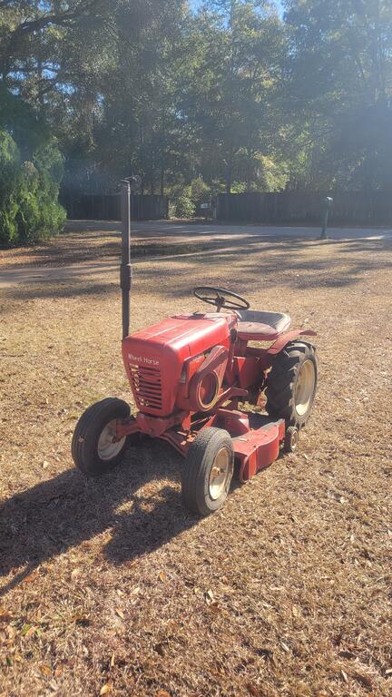

RED-Z06 2,720 #1 Posted January 14, 2024 My gears should be fine, my pulleys are fine, shafts should be fine...but im pretty sure my thrust bearings, spindle bearings, shaft bearings...are all bad. The deck actually somehow still operates but i can move the blades side to side, and theres a ton of lash...i found bits of thrust bearing under the covers. Is there a full service kit, or a walkthrough? Are blades even available? Are the gearboxes supposed to have grease or gear lube and somehow seal to the back plates and deck surface? Share this post Link to post Share on other sites
