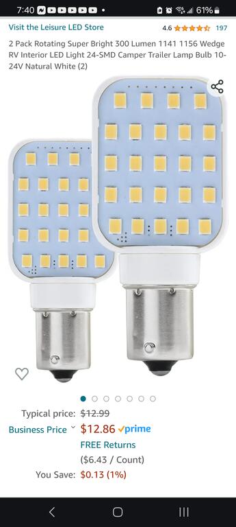

RED-Z06 2,718 #51 Posted January 18, 2024 I tried alot of leds in my C100 and most didnt work well, but these are great...been in for about 7 months and still working like new. No flickering either. I had to lightly sand the top edge to clear them into the housing but once in they have alot of room and you can swivel them in, straight or to the sides. 2 Share this post Link to post Share on other sites

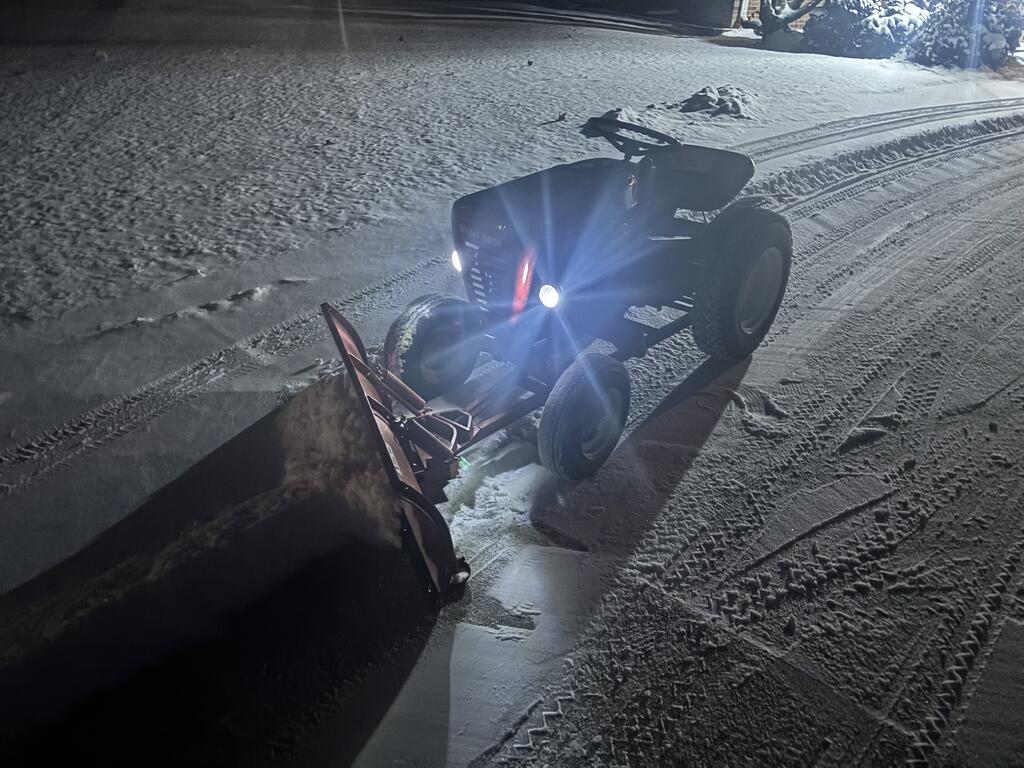

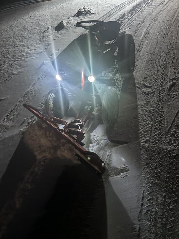

ebinmaine 80,080 #58 Posted January 19, 2024 5 hours ago, RED-Z06 said: If you ever want a headache look up how they explain that Kelvin temperature scale is derived from the color of a piece of Iron (black body radiator) heated up to a temperature equivalent to Kelvin scale and observing the color it emits. Its crap... Rule of thumb 2500-3700 orange to yellow 3800-4300 warm white 4400-5800- pure white 5900-6500 white with a hint of blue on the high side. 6600-10,000 gradually bluer until pure blue. I like a 4300-5000 The video of mine is a bit misleading. They appear whiter than reality. Likely due to phone camera. IIRC my fronts are 6K. Rears slightly lower. 1 Share this post Link to post Share on other sites

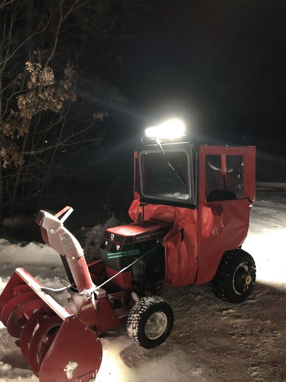

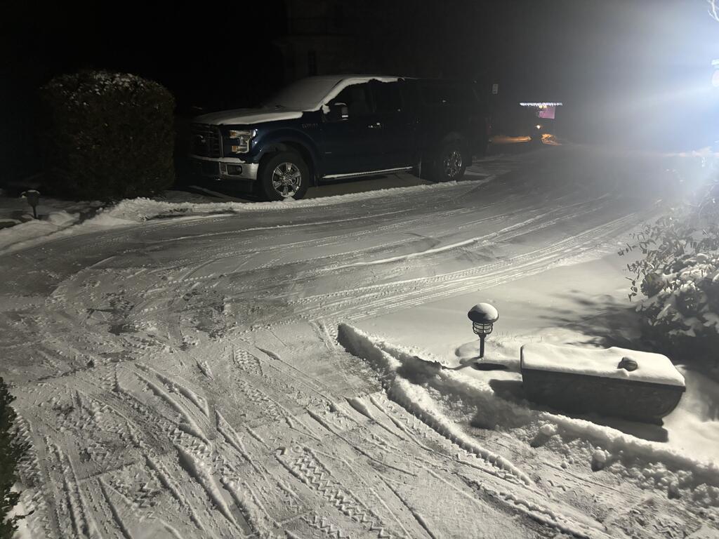

RJC1965 173 #65 Posted January 23, 2024 To update my 520H with the 2 stage snowblower. I was having the issue of it just shutting down and then after a bit it would run for awhile then shut off again this winter it got worse. Checked a few things out and replaced the ignition coil and ring under the fly wheel also new spark plug wires and a new fuel pump and lines as well. it’s doing great now about 1hr of blowing and never shut off well except when it ran out of gas. New lights work great and really like the new glass windshield and electric wiper. I shot a video that shows the different modes the light will do. They seem to work really good and light up the area as they should. It has one light bar in the front and 2 small light pods in the rear they all run off the same switch and have the six modes from bright white, flood mode , and strobe lights. IMG_4858.mov 2 Share this post Link to post Share on other sites
