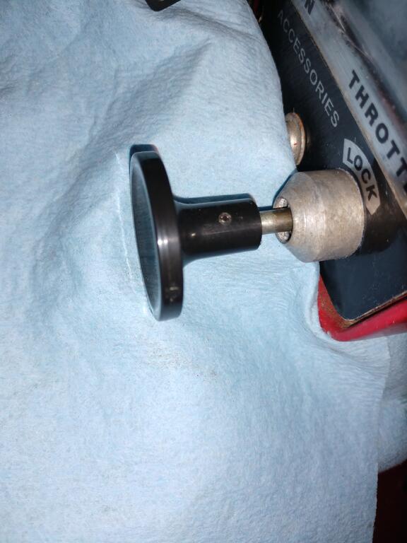

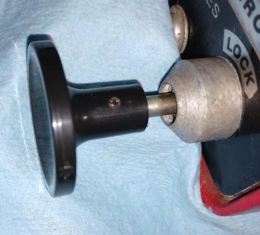

RED-Z06 2,718 #1 Posted January 12, 2024 (edited) Is there a correct replacement for these? Mine is non locking and i have to slip a piece of fuel line behind the knob to keep it full speed. I found a few locking cables but the knob isnt similar (doubt mine will come off), and the mount diameter seemed more in line with a farm tractor. Edit- closest i can find is B1-WH22 which is a locking style but with a different knob, 4ft long...ill try that one. Edited January 12, 2024 by RED-Z06 1 Share this post Link to post Share on other sites
kpinnc 18,756 #2 Posted January 12, 2024 (edited) Not sure if by "non-locking" you mean wrong cable or broken. If broken a good fix is to drill the handle and add a roll pin so the knob won't spin on the shaft. I've done a couple of mine this way and never again had trouble with them. Edited January 12, 2024 by kpinnc 2 Share this post Link to post Share on other sites
RED-Z06 2,718 #3 Posted January 12, 2024 57 minutes ago, kpinnc said: Not sure if by "non-locking" you mean wrong cable or broken. If broken a good fix is to drill the handle and add a roll pin so the knob won't spin on the shaft. I've done a couple of mine this way and never again had trouble with them. In 02 I took it to a WH dealer to wire it up and put a cable on..they put on a non-locking cable...its just a normal push pull cable. 2 Share this post Link to post Share on other sites
kpinnc 18,756 #4 Posted January 12, 2024 14 minutes ago, RED-Z06 said: In 02 I took it to a WH dealer to wire it up and put a cable on..they put on a non-locking cable...its just a normal push pull cable. Well that's sad. ...and somehow not surprising! But- when you get a new cable, put the roll pin in and make it a permanent fix! 1 Share this post Link to post Share on other sites

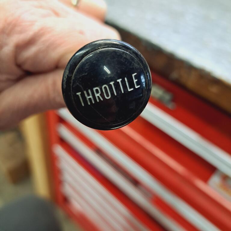

Achto 32,104 #6 Posted January 13, 2024 These cables have the original looking knobs and work absolutely awesome. I love the one that I have on my 701. You can literally pull the knob out, lock it and use the knob to push the tractor. The knob will not push in until you give it a 1/4 turn to unlock the ratchet mechanism. https://www.armyjeepparts.com/p-2637-throttle-cable-with-ratcheting-round-black-knob-cj2a-jeep-nos-wo-640669.aspx?network=g&device=c&keyword=&campaign=10021783397&adgroup=pla-298431537838&gad_source=1&gclid=CjwKCAiA44OtBhAOEiwAj4gpOcuC5OM2D3U9Y2rgjYDrqkS_Gztc7MtONxp0JmjOQqkl-rqB8L3fmBoCw3wQAvD_BwE Note: you will need to trim it to length. 3 1 1 Share this post Link to post Share on other sites

Achto 32,104 #9 Posted January 13, 2024 1 minute ago, WHX?? said: I thought you said these were NLA? You holding out on me? Did a search when I saw this post & they popped up again. 2 Share this post Link to post Share on other sites

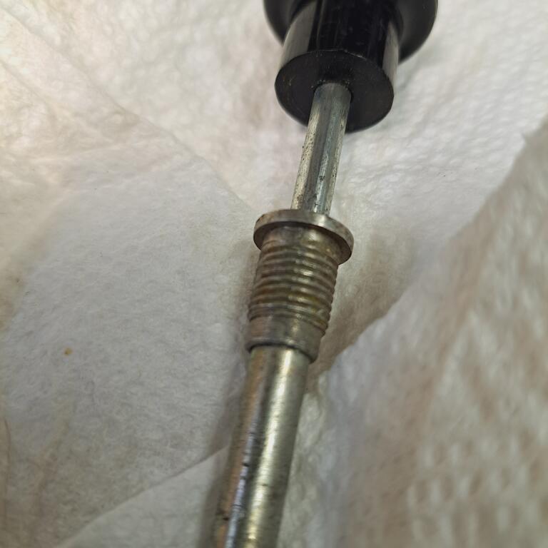

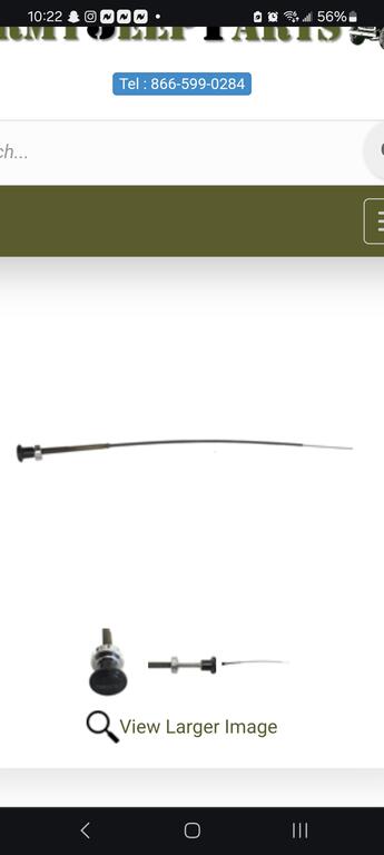

RED-Z06 2,718 #11 Posted January 13, 2024 (edited) 3 hours ago, Achto said: Did a search when I saw this post & they popped up again. I have a concern, the 3rd photo seems to show the full length being fairly short. Also...how do you add it to your cart to buy Edited January 13, 2024 by RED-Z06 1 Share this post Link to post Share on other sites

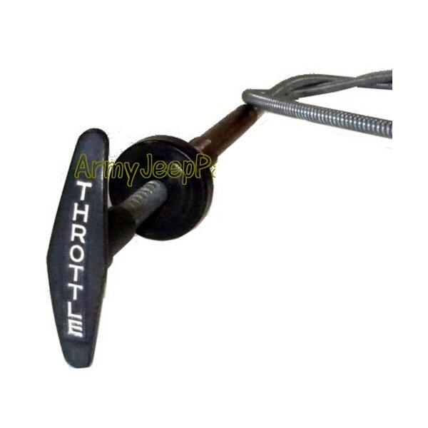

Treepep 1,147 #12 Posted January 13, 2024 12 hours ago, ri702bill said: The original throttle has a 2 pc brass split sleeve - twisting the throttle knob rotates the cable and "locks" it. Choke cable does not have that. Check online - a shop out of Tennessee sells repro WWII Jeep cables - they used a locking version too. That is what I have on my GT-14. It is a great improvement from the original. (no clue if that tractor came with a locking throttle) Mine did and it was terrible. A member directed me to the jeep cable. 2 Share this post Link to post Share on other sites
Treepep 1,147 #13 Posted January 13, 2024 I went with the "T" handle. Just my preference. I never enjoyed the twist lock. 3 Share this post Link to post Share on other sites
WHX?? 57,461 #14 Posted January 13, 2024 17 hours ago, RED-Z06 said: show the full length being fairly short. Also...how do you add it to your cart to buy That is a good question. they don't list the length and there is no cart. Guess one has to call to order. 1 Share this post Link to post Share on other sites

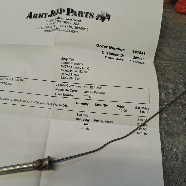

WHX?? 57,461 #16 Posted January 15, 2024 On 1/13/2024 at 4:13 PM, kpinnc said: I just use these. Not correct, but with the roll pin mod they work great. Ebay throttle cable What's the roll pin mod KP? Up date on the Jeep ones I called the place and found you can't order them because the NOS-ones are NLA and I would guess thats the one @Achto has. SOB got the last one.... The gal says they have one that is not NOS with the same part #. it does lock tho I guess. Iv'e peed away 16 bucks in worse ways so I ordered one and will see what shakes. https://www.armyjeepparts.com/p-3896-throttle-cable-round-black-knob-cj2a-jeep-nos-wo-640669.aspx Share this post Link to post Share on other sites
RED-Z06 2,718 #17 Posted January 15, 2024 34 minutes ago, WHX?? said: What's the roll pin mod KP? Up date on the Jeep ones I called the place and found you can't order them because the NOS-ones are NLA and I would guess thats the one @Achto has. SOB got the last one.... The gal says they have one that is not NOS with the same part #. it does lock tho I guess. Iv'e peed away 16 bucks in worse ways so I ordered one and will see what shakes. https://www.armyjeepparts.com/p-3896-throttle-cable-round-black-knob-cj2a-jeep-nos-wo-640669.aspx Definitely let us know, I saw that one but it never said locking. Share this post Link to post Share on other sites

kpinnc 18,756 #19 Posted January 16, 2024 7 hours ago, WHX?? said: What's the roll pin mod KP? I put a 1/8 roll pin in my twist lock throttle cables. Otherwise the plastic knob spins freely and makes the lock useless. No more vice grip throttle locks! 1 Share this post Link to post Share on other sites
WHX?? 57,461 #20 Posted January 19, 2024 On 1/15/2024 at 4:02 PM, RED-Z06 said: Definitely let us know, I saw that one but it never said locking. On 1/15/2024 at 5:25 PM, WHX?? said: She said it does... we'll see. Just got it today and must say mildly disappointed. Not even close to what Dan's is. Does not lock at all ... strait push pull. The wire was bent making it difficult to push pull. Maybe that's their stay where you want it feature? Pliers easily straitened it.. No nut for the mount so off to search the nut bins. The shoulder diameter is very small so an exact washer or exact hole size is going to be needed to mount. Not much for thread length so would be fun mounting in thicker dashes Over all length is 50" so more than enough for a round hood. Knob is early '60s period correct. This is the same one I order off fleabay awhile back for the 701 resto. All said and done I would go with the later '60s one KP piced unless it really really had to be close to original. Not sure if it will go on the 502 yet Share this post Link to post Share on other sites
RED-Z06 2,718 #21 Posted January 20, 2024 6 hours ago, WHX?? said: Just got it today and must say mildly disappointed. Not even close to what Dan's is. Does not lock at all ... strait push pull. The wire was bent making it difficult to push pull. Maybe that's their stay where you want it feature? Pliers easily straitened it.. No nut for the mount so off to search the nut bins. The shoulder diameter is very small so an exact washer or exact hole size is going to be needed to mount. Not much for thread length so would be fun mounting in thicker dashes Over all length is 50" so more than enough for a round hood. Knob is early '60s period correct. This is the same one I order off fleabay awhile back for the 701 resto. All said and done I would go with the later '60s one KP piced unless it really really had to be close to original. Not sure if it will go on the 502 yet Mine came today too. Its the large dished knob, very robust mount, with a nut. Definitely shortening it alot but the Z bender helps. 1 Share this post Link to post Share on other sites
WHX?? 57,461 #22 Posted January 20, 2024 8 hours ago, RED-Z06 said: the Z bender helps. Absolutely... for what little they are in the jungle everyone here should have one. 1 Share this post Link to post Share on other sites
