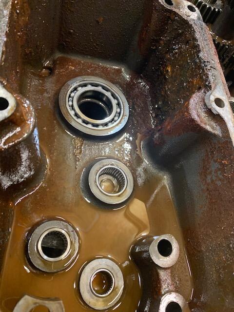

JoeM 10,316 #2 Posted January 11, 2024 (edited) just a little piece of what I know about water in 8 speeds If the oil is just discolored a DFR and reboot might be the ticket If there is a lot of water, chances are there is rust in the case. The manuals are not painted inside like the hydro trans, and the if they set wet, they will rust. If possible, need to see if you can see into the case with a pin light or cam to check closer for rust accumulation. It doesn't take much rust in the oil to ruin bearings. It is not to bad of a job, maybe three afternoons, to remove open and clean up the mess. Get a gasket, new seals and boot. might want to check around for some replacement parts might find some chewed up ones. stevasurus has some good trans instructional vids on RS if you need know how it is done. 8 speed case with rust inside the top of the case was rusted because the water ran into the shifter and across the top of the case. If you do get into the case make sure you take a very close look at the bearings for defects. After clean up with diesel and some elbow grease. Edited January 11, 2024 by JoeM 4 3 Share this post Link to post Share on other sites
Maxwell-8 4,371 #3 Posted January 11, 2024 2 hours ago, JoeM said: 8 speed case with rust inside the top of the case was rusted because the water ran into the shifter and across the top of the case. Often times condensation over the years will cause the top half to rust as well. When you don't drive your horse for long periods, the oil will drain down. Leaving the top half exposed for rust formation by the condensation. 3 Share this post Link to post Share on other sites

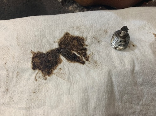

JoeM 10,316 #7 Posted January 11, 2024 1 hour ago, Ed Kennell said: You may have to do this several times until the drained fluid is clean. and if you can get a magnetic plug installed even better. I got these from McMaster 3 Share this post Link to post Share on other sites

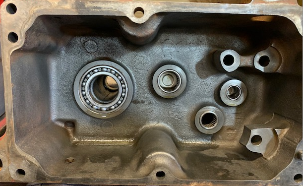

JoeM 10,316 #8 Posted January 11, 2024 4 hours ago, Maxwell-8 said: Looks like some spare parts laying in the oil? Share this post Link to post Share on other sites

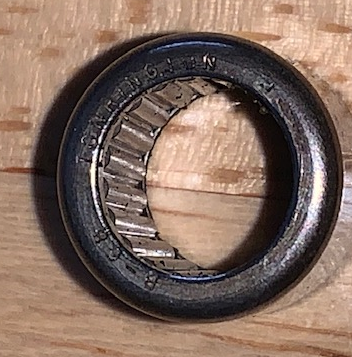

Maxwell-8 4,371 #9 Posted January 11, 2024 2 minutes ago, JoeM said: Looks like some spare parts laying in the oil? From my experience, the outer axle bearings tend to go out first. they see some heavy loads and when there is little oil in the case, they can run low on oil. Often taking out the inner axle bearings whit those needle rollers. 2 years ago, I rebuild 3 transmissions with this issue. 1 Share this post Link to post Share on other sites
