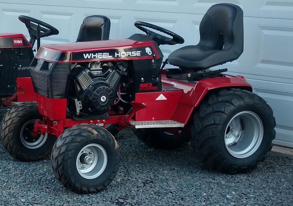

WHGuy413 2,859 #1 Posted January 10, 2024 (edited) My First wheel horse was the one I grew up on. I have tons of awesome memories on this tractor mowing with my grandfather (him on his 416H which I own now) and me on my dad’s 12 Automatic. We mowed 5 acres twice a week. When I moved into my house (my grandparents house) my dad gave me his 12 auto. I remember my dad tearing it apart and repainting it and adding the 18HP Briggs and Stratton Vanguard V-twin to it in our basement. He had red paint everywhere lol. I used it a ton around here but unfortunately it sat for the last 5 plus years. Well I finally got it into the garage a few weeks ago. I dug into the carb. Had to get a new gasket. Cleaned the fuel pump and changed out the fuel lines and filter. Unfortunately Alex and I couldn’t get the starter to work so pull start it was. So happy to have it running again. Now to steal front tires back from @WheelHorse_Kid and get it out and stretching its legs. It should start first or second pull now that the fuel system is primed. I also ran it for a while after it died at the end of the video and it throttles up and down perfectly fine. this is the tractor that started my crazy addiction. So glad it’s back to running. Edited January 10, 2024 by WHGuy413 9 17 Share this post Link to post Share on other sites

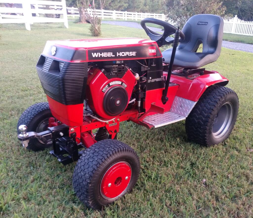

kpinnc 18,256 #2 Posted January 10, 2024 2 hours ago, WHGuy413 said: remember my dad tearing it apart and repainting it and adding the 18HP Briggs and Stratton Vanguard V-twin to it in our basement. Vanguards are great engines. At least the "small block" 12-23hp versions. I have a couple of those and they work very well. Glad to see you got her going again! 6 5 1 Share this post Link to post Share on other sites
Lee1977 7,637 #3 Posted January 10, 2024 (edited) I put a 16 Vanguard in my C-120 back in 1989 it has a 18 now. Bought the C-120 new. I have parts of the 16 Vanguard running in a 312-8. Good to see yours back running. Edited January 10, 2024 by Lee1977 8 3 2 Share this post Link to post Share on other sites
