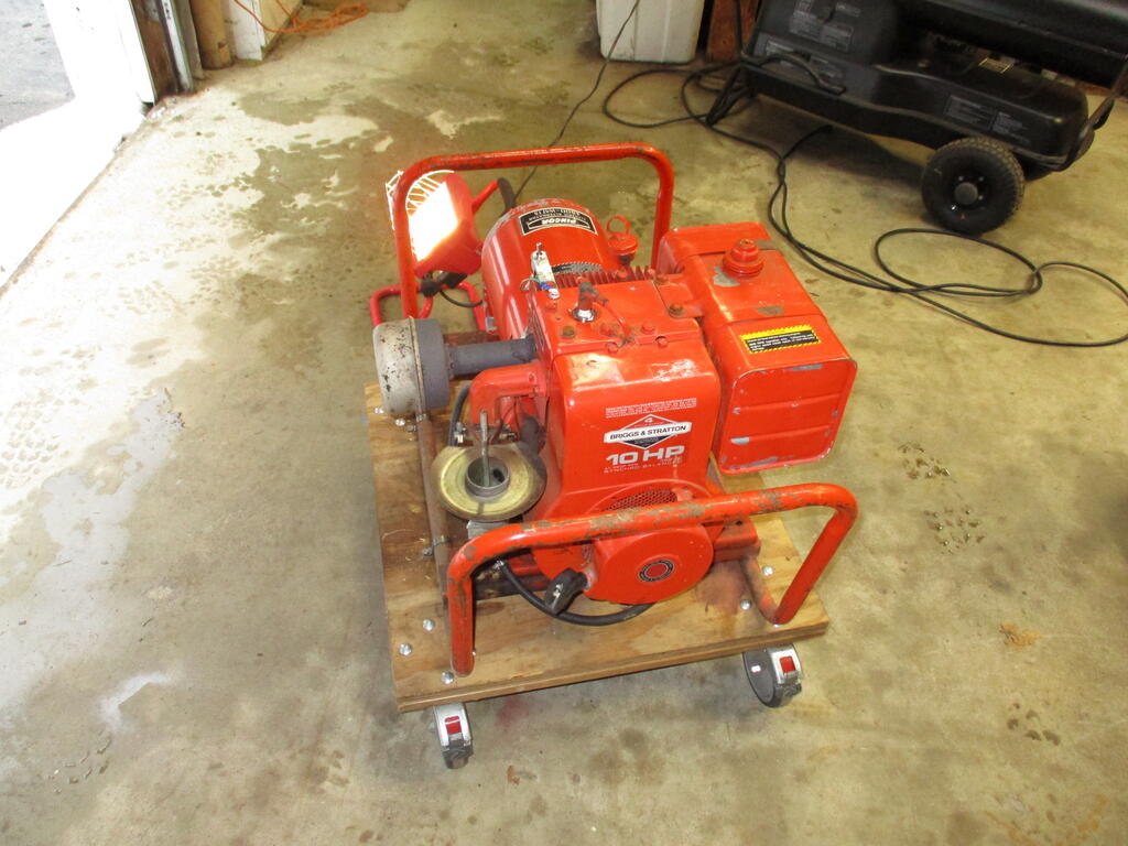

pfrederi 19,960 #1 Posted January 9, 2024 Had to put in a new plug and a toggle switch for kill. need to get an airfilter. Started on 3rd pull... (requires a serious tug) Sometimes you win at an auction Pincor 4500watt 4 13 Share this post Link to post Share on other sites
ri702bill 11,392 #2 Posted January 9, 2024 Good score there Paul... 10HP on a rope pull is a workout!! 2 Share this post Link to post Share on other sites

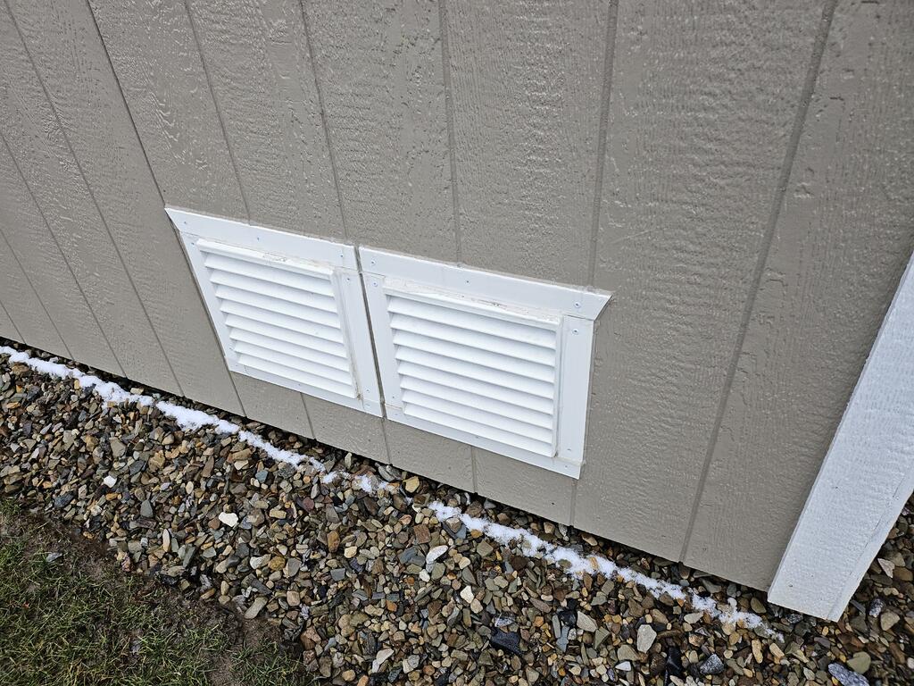

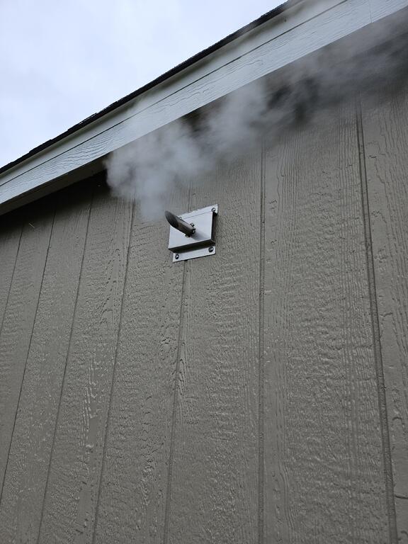

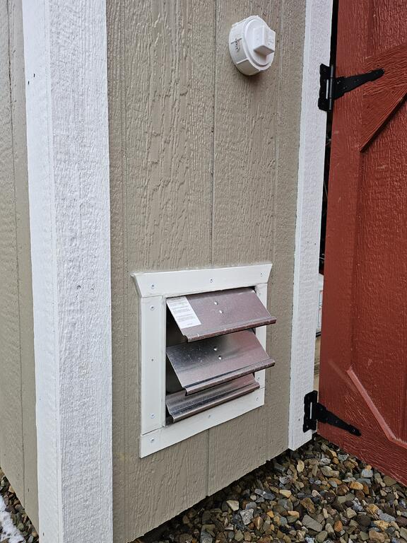

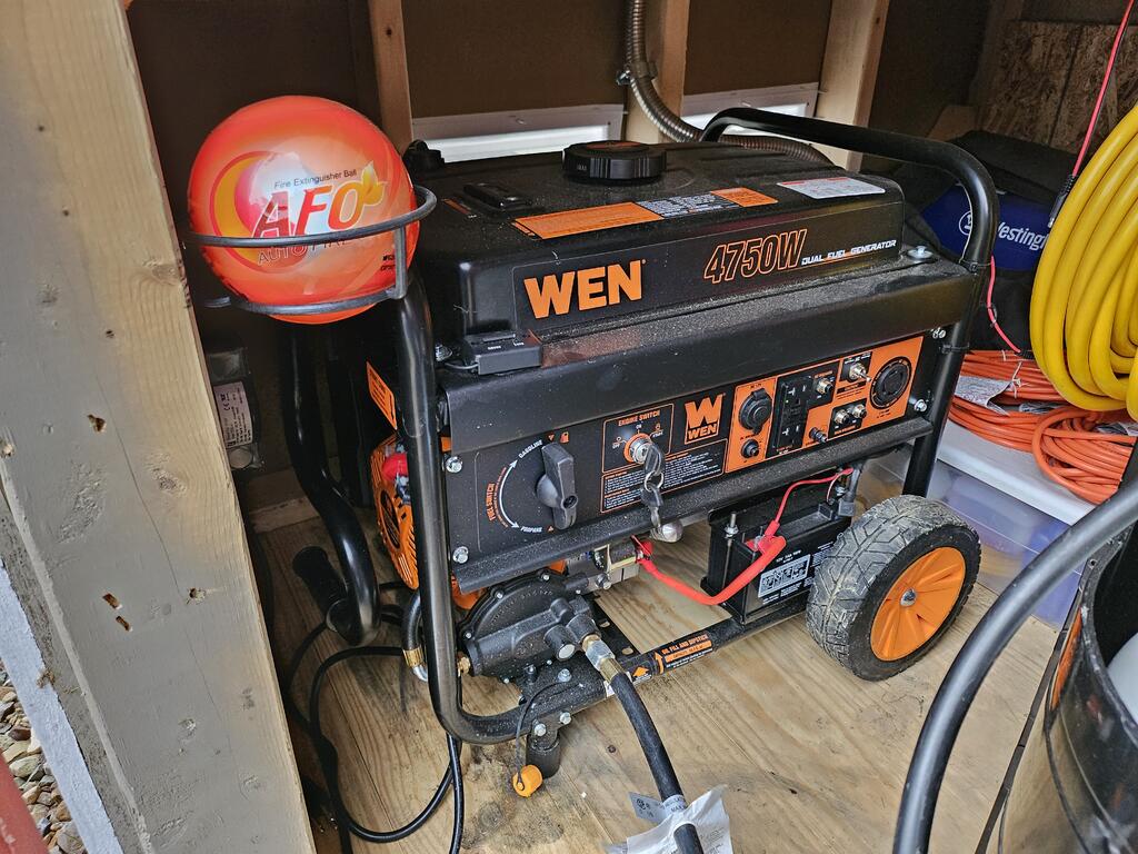

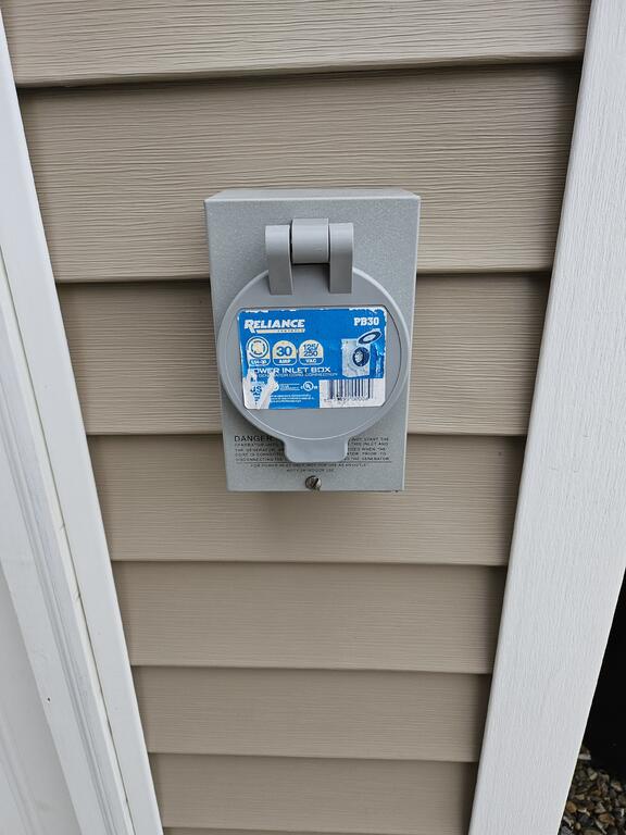

ML3 2,154 #4 Posted January 11, 2024 My generator setup. Stays in shed. Exhaust exits outside. Fresh air vents & attic fan to exhaust any potential fumes/heat. Just have to run power cord to 240v outlet installed on outside of house. Have an interlock installed on fuse box. Eventually, I'll go to an automated system. 3 2 Share this post Link to post Share on other sites
