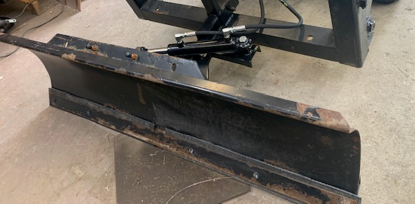

cod 135 #1 Posted January 6, 2024 Any consensus on a replacement edge for a snow plow? Hot roll, cold roll, 1/4", 3/8" thickness? Mine is getting worn and I believe it has already been flipped over. Another consideration would be to use rather heavy rubber mud flap, although I suspect it would wear out quickly. Any suggestions would be appreciated or a link to previous posts about this subject. Thanks! Share this post Link to post Share on other sites

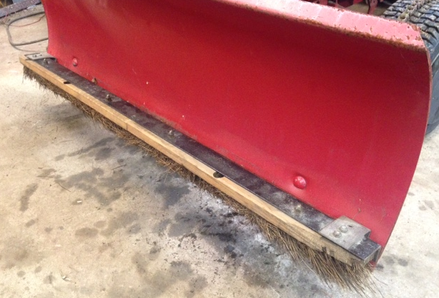

JoeM 10,092 #7 Posted January 7, 2024 I used an old piece of conveyor belting for a rubber edge and it is sandwiched between the metal blade edge and plow face. 3/8" stuff. lasts a long time. I actually tried this broom thing one year and it worked pretty good. A friend of mine gave it to me. 1 1 Share this post Link to post Share on other sites
