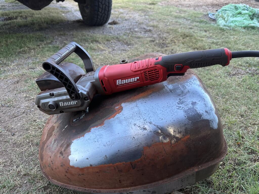

ClassicTractorProfessor 5,455 #1 Posted January 5, 2024 Any of you guys own this? I think it would be handy to have for stripping sheet metal parts on the tractors, and Courtney’s dad is building a Jeep so he could get some use out of it as well. Debating whether to pick one up tonight or order the Eastwood CountourSCT that’s on sale right now for $10 more, but would have to wait until the middle of the week to receive it. Share this post Link to post Share on other sites

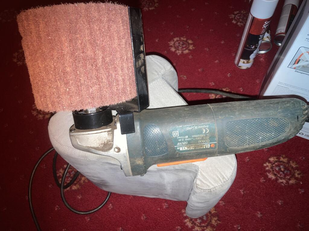

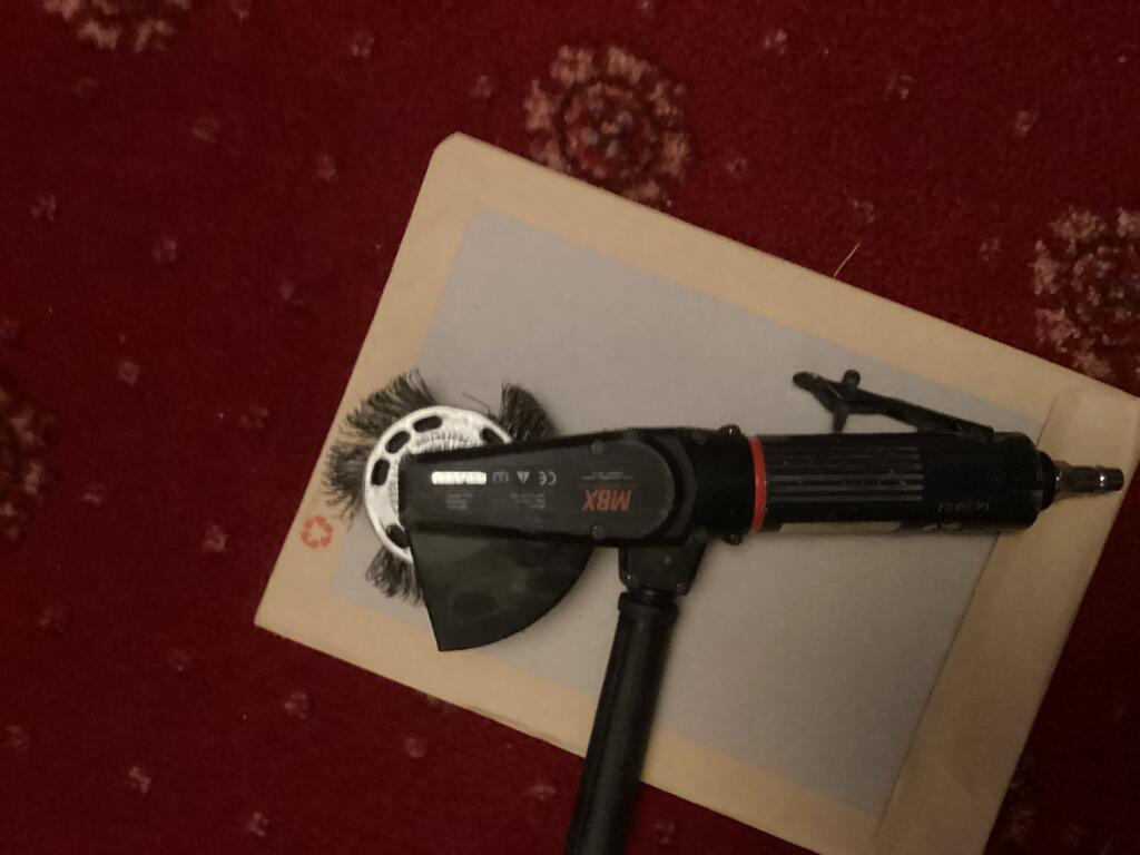

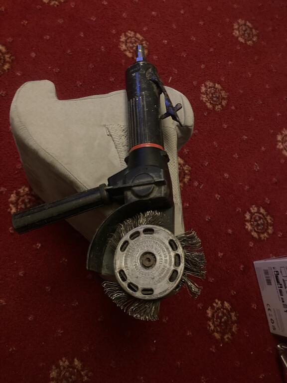

ranger 1,854 #6 Posted January 5, 2024 Have a look on the ‘bay’. You can get an attachment which uses the same sanding drums, but fits to an angle grinder. Share this post Link to post Share on other sites

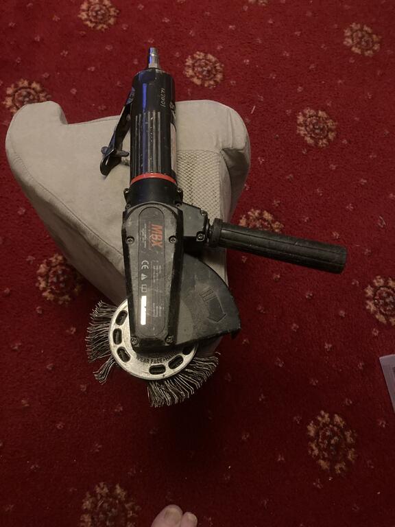

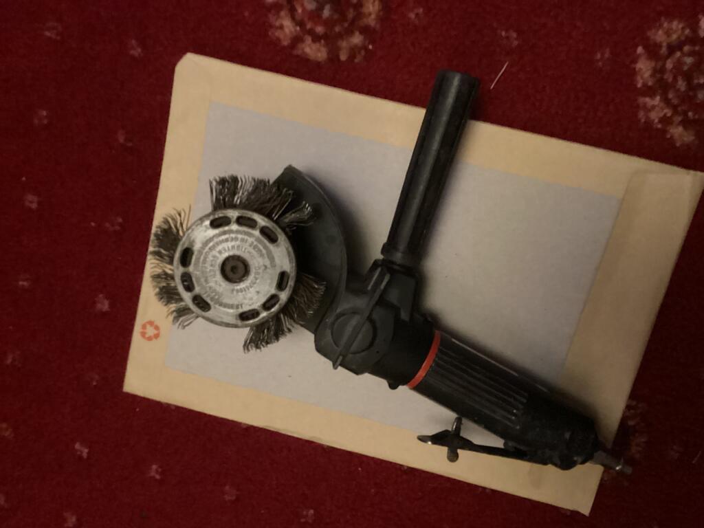

ranger 1,854 #14 Posted January 6, 2024 (edited) A few pics of the attachment for an angle grinder, and an air driven one I have: MBX 3500, that I think uses something like 18+ CFM to drive it? Listed as “Burnishing Tool Attachment “, on the bay, price around £25.00p, in the UK. Edited January 6, 2024 by ranger Share this post Link to post Share on other sites

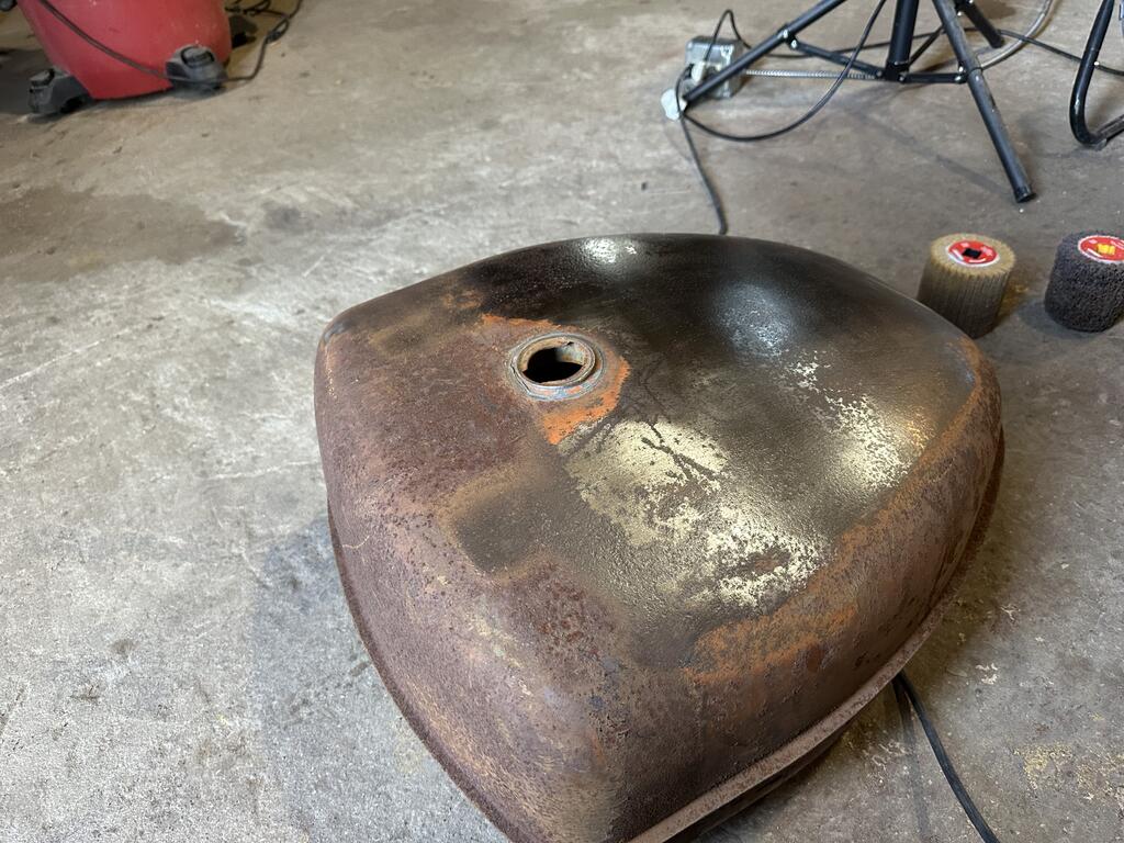

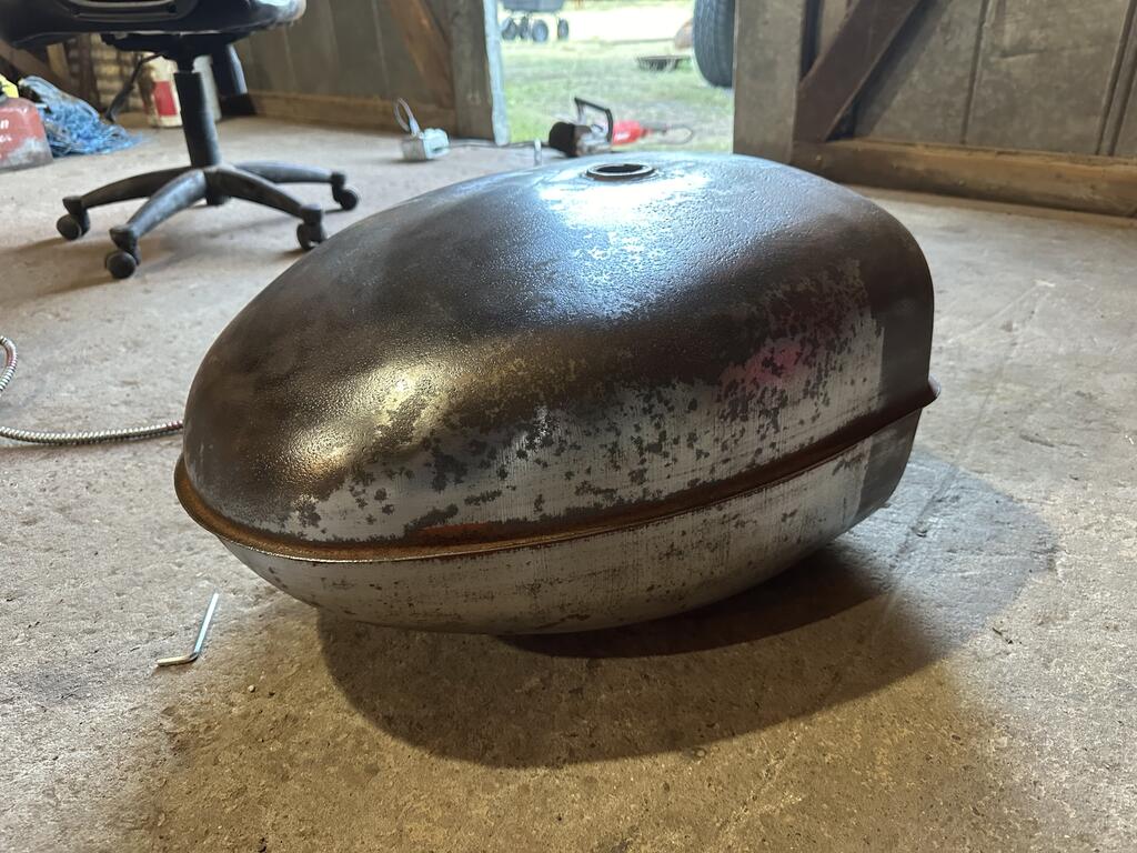

ClassicTractorProfessor 5,455 #16 Posted July 10, 2024 Wanted to give you all an update on this tool, I picked one up back in January but just recently got the chance to try it out much. As soon as we got it home Courtney’s dad latched on to it and put it through its paces on a Jeep tub he’s redoing. But I finally was able to pry it out of his hands and used it to strip the old paint and rust off of the fuel tank for the Allis WC. My personal opinion if a person does any amount of sheet metal work this is a must have tool. I used to strip paint and rust with a grinder and wire wheel and while those still have their place this did it so much faster and with less vibration. The drum selection for HF leaves a little to be desired, but the drums from Eastwood for their ContourSCT fit right on this tool. I bought the scale stripping drum from Eastwood and it made quick and easy work of removing the rust and scale from inside the rear rim on the WC 4 Share this post Link to post Share on other sites
