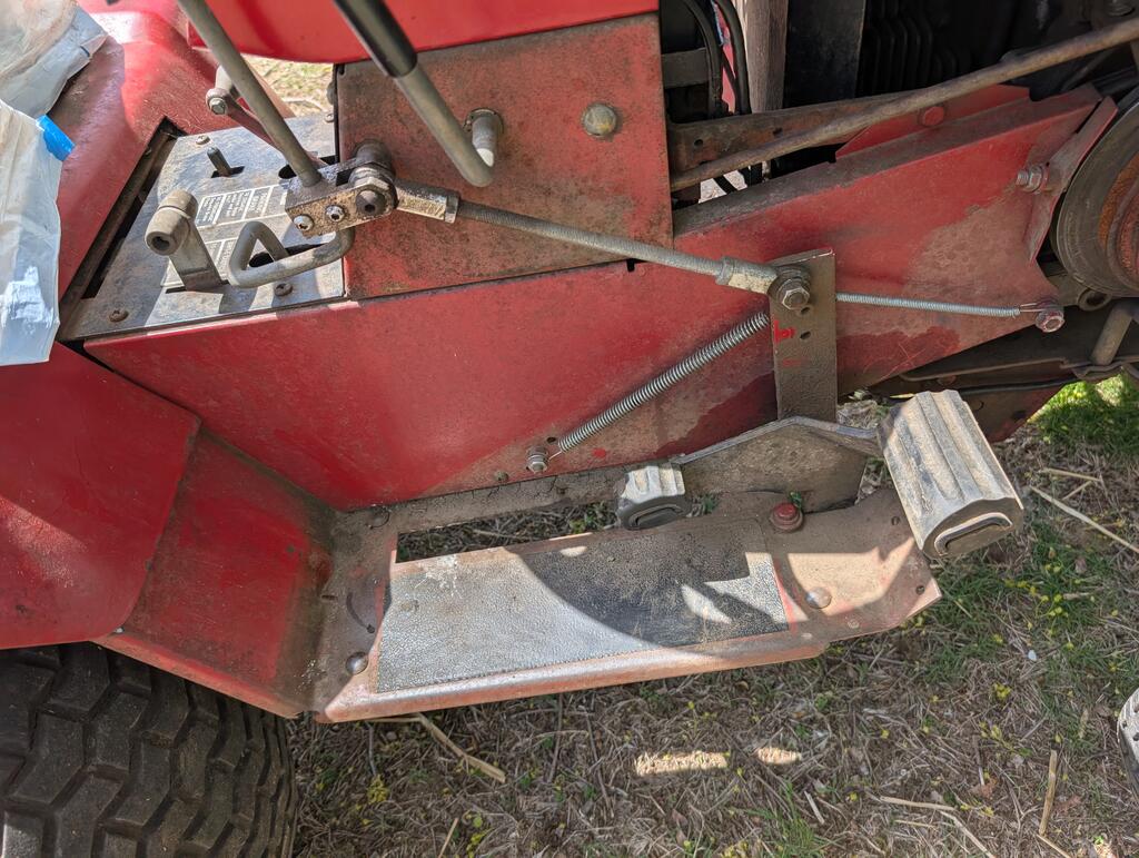

Bill D 3,099 #30 Posted April 29, 2025 On 1/12/2025 at 6:20 PM, midpack said: You can see it here, nothing fancy but it works great 😃 What is that pedal from? Any pictures of the linkage under that belt guard? Thanks. 1 Share this post Link to post Share on other sites
midpack 1,148 #31 Posted April 29, 2025 Pedal is off a 269(?) Wheel Horse. I had to run a 3/4" drill through the mount diameter IIRC. I can get a picture later. I'm in Maine right now but the tractor is in MA Share this post Link to post Share on other sites
Bill D 3,099 #32 Posted April 29, 2025 7 hours ago, midpack said: Pedal is off a 269(?) Wheel Horse. I had to run a 3/4" drill through the mount diameter IIRC. I can get a picture later. I'm in Maine right now but the tractor is in MA Thanks, much appreciated. Share this post Link to post Share on other sites
midpack 1,148 #33 Posted April 29, 2025 It's a little dirty but I've been using for around 5 years with the only adjustment being the back spring tension. I used a plate mounted to the rod attaching hole. It moves the drive lever front and back. The block on the lever was something I made when I was working Share this post Link to post Share on other sites
Bill D 3,099 #34 Posted April 29, 2025 3 minutes ago, midpack said: It's a little dirty but I've been using for around 5 years with the only adjustment being the back spring tension. I used a plate mounted to the rod attaching hole. It moves the drive lever front and back. The block on the lever was something I made when I was working I like that. I may have to buy one and try it. I'm always looking for hydro pedal ideas. Share this post Link to post Share on other sites
