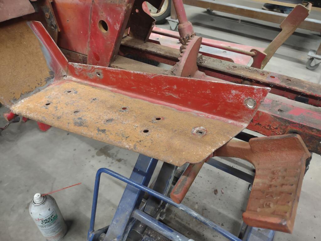

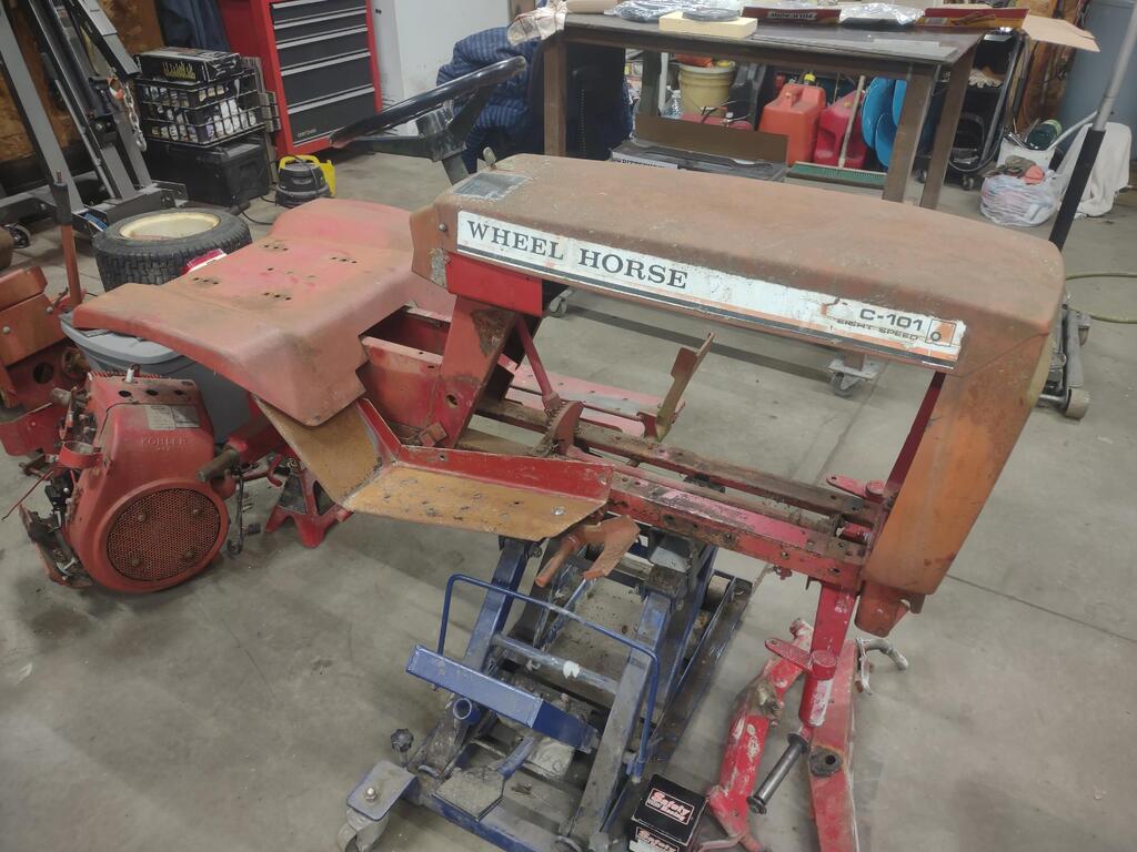

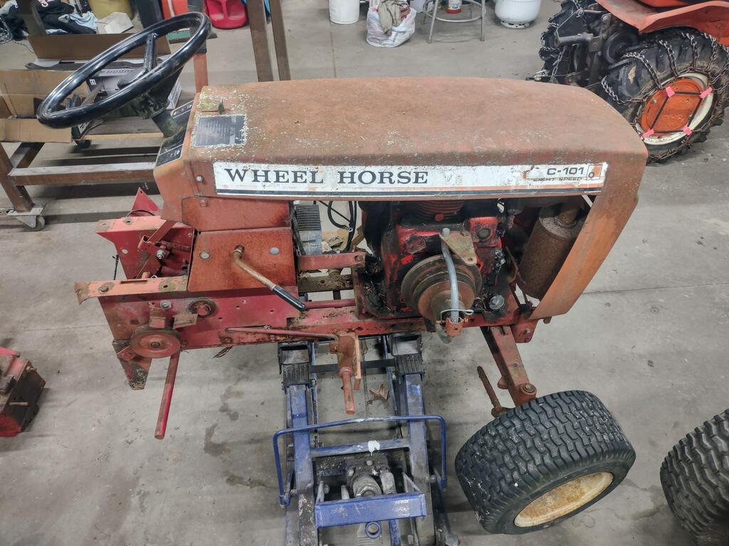

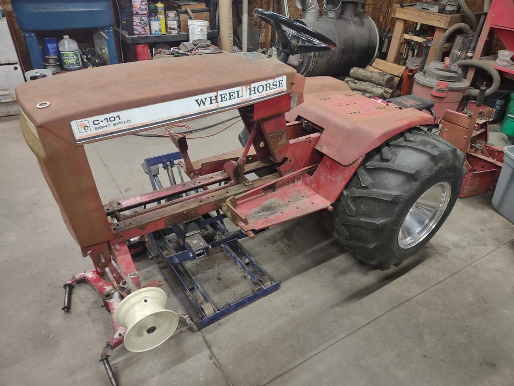

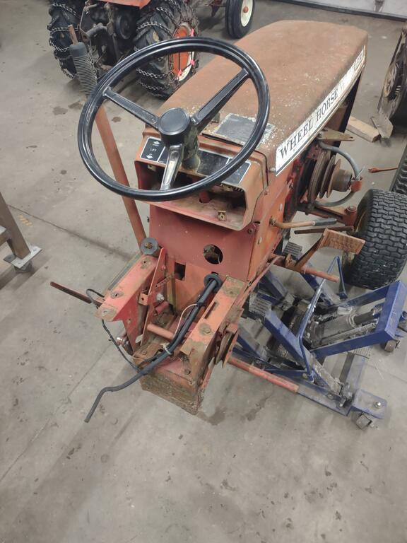

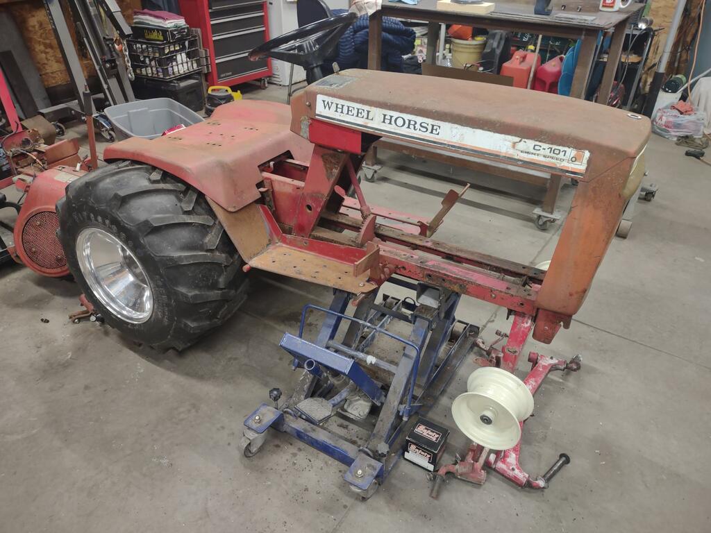

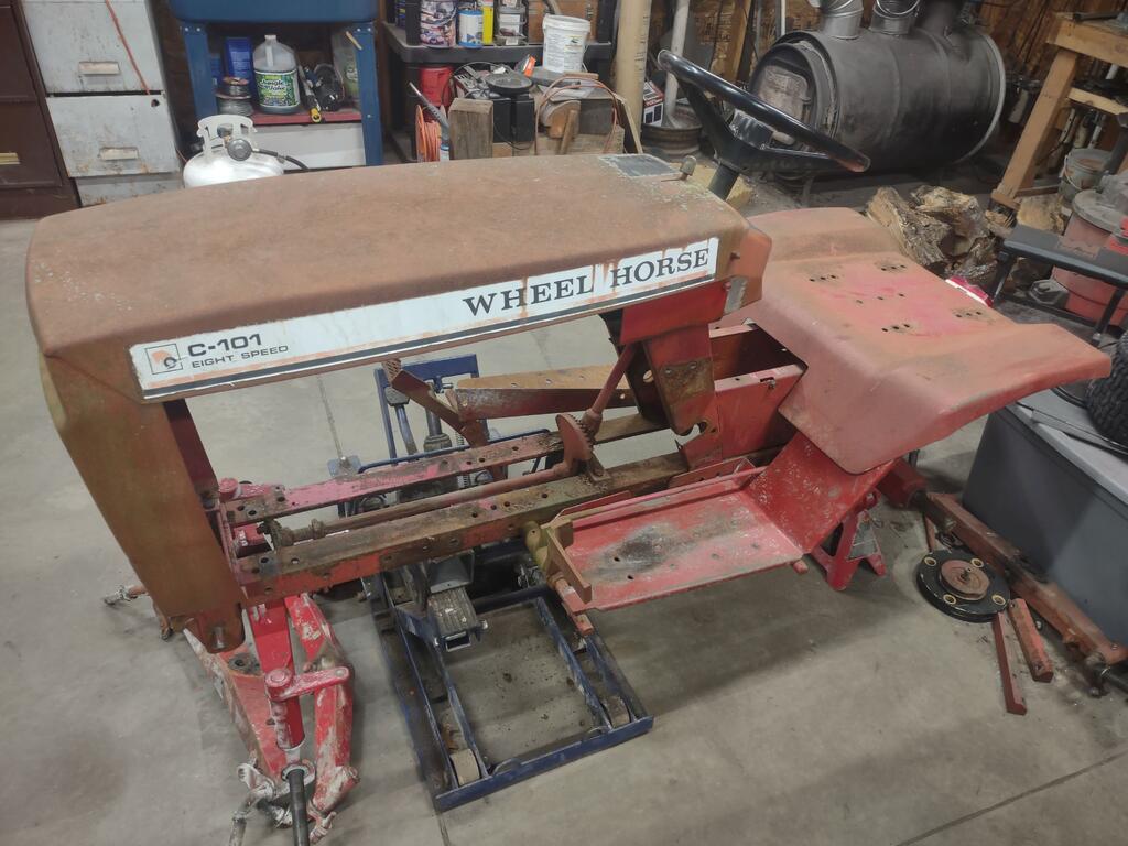

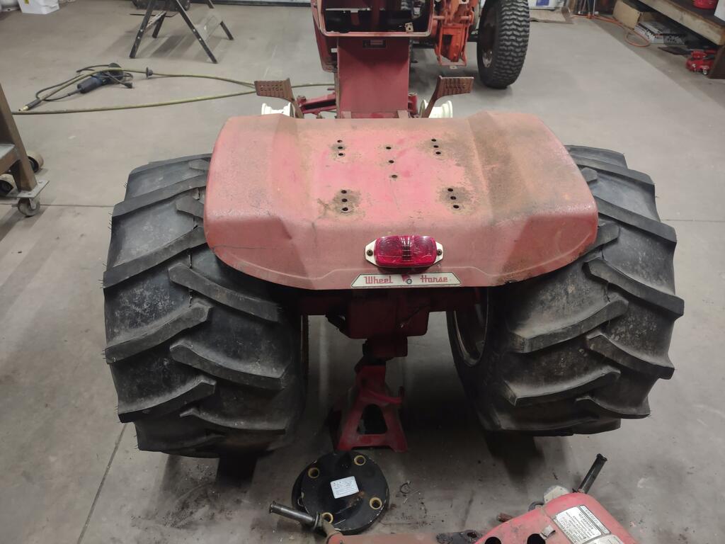

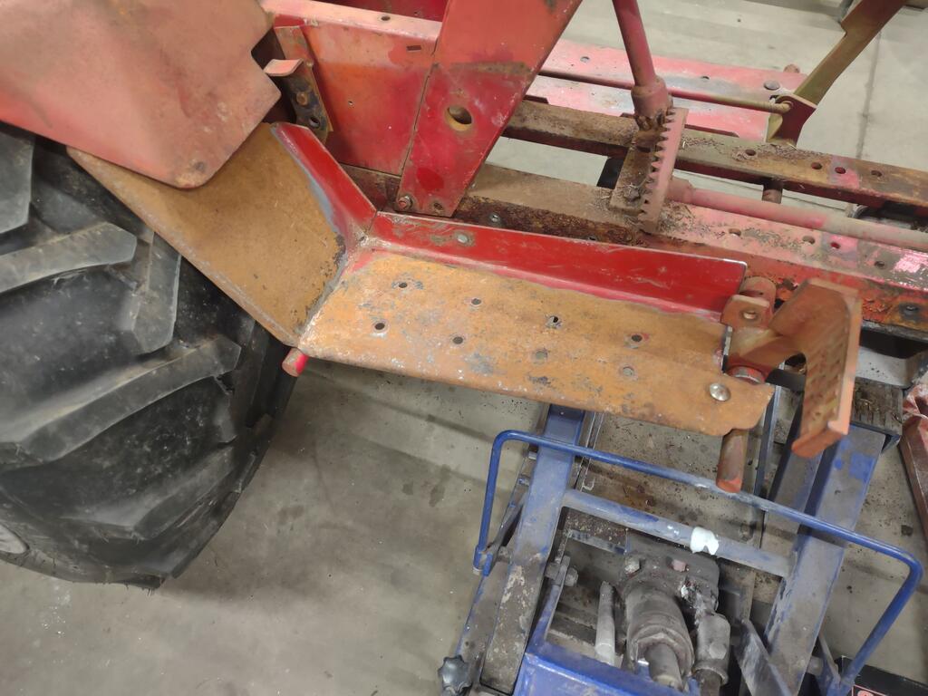

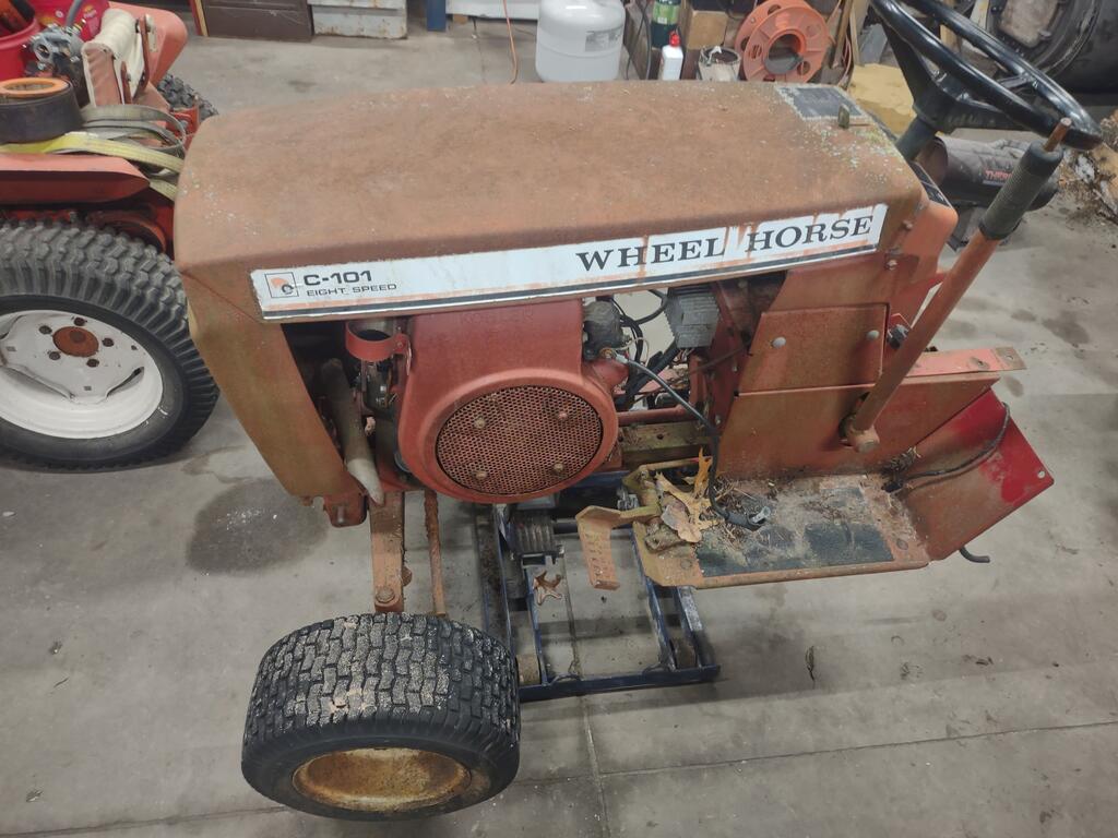

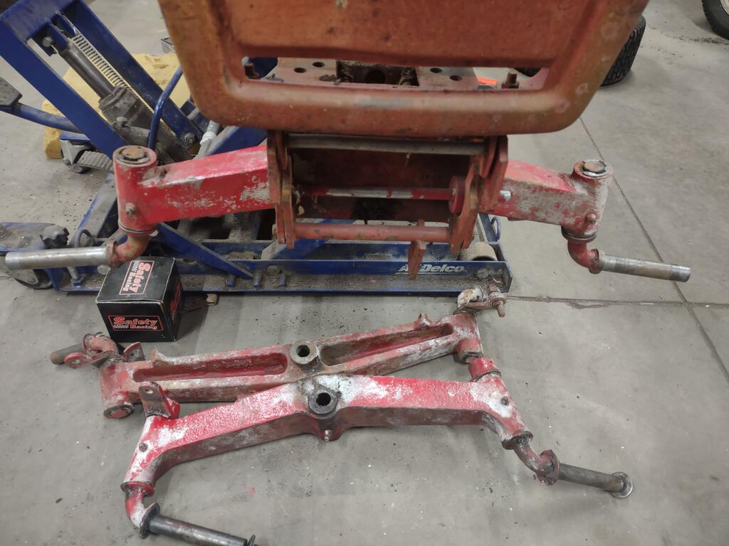

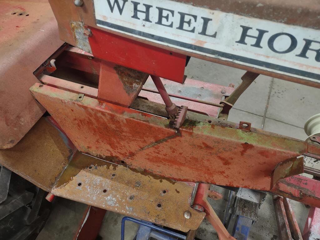

Achto 32,724 #1 Posted January 2, 2024 (edited) Once again the holiday's are behind us & my favorite time of year has come. Tractor building time !!!! Normally I'm posting my tractor build in the "Restoration, Modification & Custom" section but this years build is more fitting in this section. Last year during a local pull @WHX?? says "We need to build a puller". I kicked the idea around a bit and had pretty much decide NO due to the price of the rear wheels needed to be competitive. Then.... A friend of mine offered to let me borrow a set of rear wheels for one season if I was serious about building a puller. Well heck !! I guess I'll have a go at building a puller. Blahhh, Blahhh, Blahhh. I know you guys what to see some pictures. Took a wander out back to see what I had laying around ... and ... Welcome to ground zero. Not much to start with, but it's a start. A trip to Jim's storage shed help set me up with a 6 speed tranny & a bunch of other parts needed to cobble something together. Then a trip through my parts shed set me up with a few more things. First step - I wanted the front axle of the tractor to be narrower and hopefully a bit lower. First I tried a 633 front axle but was not exactly happy with it. Next I tried a Lawn Ranger front axle, this I liked but the spindle were too short for the 6" rims that I'm using. Grab some spindles out of another axle and life is good. I think this set up will look great. About 3 to 4" narrower and a bit lower. I do not want to run the rear fuel tank that the C-101 comes with because I wish for the rear tires to be as close together as possible plus I don't have the C-101 rear sheet metal parts any way. Removed the dash tower and replaced it with one from a 1257. Best news came when I closed the hood and it fell right in place with the ability to latch it. The running boards from the C-101 would not work at but I had a set from a Raider 12 that I figured would work. As you can see in the pics above the left board fit perfectly but the right side had some issues fitting with the brake peddle. BTW the brake peddle will be staying but will be used as a gas peddle instead. The tractor will require a dead man's throttle so the brake peddle will be modified for this purpose. A closer look at the running board fitment issue. After a bit of trimming the board lays where it should. Test fit the rear wheels to see if I would have any clearance issues. First issue, the center hole in the rim is not large enough to fit on the stock hubs. Compensation - 5/16" thick spacers to move the rim out a bit. On this note, I don't like the fact that the rim does not fit over the raised portion on the outside of the hub. One more thing that I don't like is that the bolt holes in the rims are 1/2", not 7/16". Worse yet the rim holes are not set up with tapered holes to use regular lug bolts or nuts. Thinking of turning the step down on the face of the hub to fit the hole in the aluminum rims and also tapping the holes out in the hub to 1/2"-20. With the wheels on, I see that I have some tight clearances that I will have to address. I have plenty of clearance on the inside for the tires, in fact they could even be a bit closer together if I wish. The last thing that I looked at today was a belt guard. I think that I can make the C-101 guard work with a little trimming. Will need to get the engine installed before I know for sure. I have some minor fitment issues to work through yet as well as more adventures I'm sure. Feel free to stop by & check out my progress and to see what I can build with "Poor Decisions and No Money". Edited January 2, 2024 by Achto 9 19 2 Share this post Link to post Share on other sites
