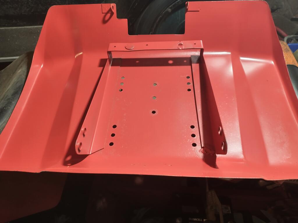

23 Reo 243 #1 Posted December 31, 2023 How do I modify an older fender pan so I can use it on a 1983 C series? 1 Share this post Link to post Share on other sites
squonk 48,429 #2 Posted December 31, 2023 The tractor is gone but I put a Commando seat pan on a C-160. Just took a little cutting with a cut off wheel. I think there's a pic on here somewhere. I'll see if I can find it. 1 Share this post Link to post Share on other sites
Sparky-(Admin) 26,898 #3 Posted December 31, 2023 You'll need a good sized hole saw for the fuel tank inlet….otherwise the mounting bolt pattern is the same. If you can find a fender pan off a 1978-1979 C series they already have the fuel tank inlet opening 2 Share this post Link to post Share on other sites
squonk 48,429 #4 Posted December 31, 2023 Didn't see that yours was an 80's vintage. For the curious I put the Commando pan on a 74 C-160 Hat to cut the side rails off of the pan and tack on the piece that goes across for the seat latch. 3 Share this post Link to post Share on other sites

23 Reo 243 #6 Posted December 31, 2023 The fender pan on my 1983 C-125 is in bad shape so I'm going to replace it with an older style pan. I've always liked the look of an older pan on a black hood. 1 Share this post Link to post Share on other sites
ebinmaine 81,283 #7 Posted December 31, 2023 25 minutes ago, 23 Reo said: The fender pan on my 1983 C-125 is in bad shape so I'm going to replace it with an older style pan. I've always liked the look of an older pan on a black hood. Understandable. I like the older looks better. 👌 Do you have a hole saw large enough to make the fuel filler hole? Share this post Link to post Share on other sites

23 Reo 243 #10 Posted December 31, 2023 I'll buy a hole saw at Harbor Freight. 1 Share this post Link to post Share on other sites
ebinmaine 81,283 #11 Posted December 31, 2023 1 minute ago, 23 Reo said: I'll buy a hole saw at Harbor Freight. Those wider metal hole saws can be grabby. If possible you'll want to use a drill press. Set up the seat pan in a big jig. Get it held TIGHT and STRAIGHT. If you don't have a drill press or way to jig the seat pan, go very slowly and hold on. 2 Share this post Link to post Share on other sites

Handy Don 17,735 #13 Posted December 31, 2023 19 minutes ago, ri702bill said: We were all laughing too hard... And another “Here, hold my beer...” perpetrator survives for another day. If I were to try this now, I’d likely put two or three smaller holes around the center point for the new hole about halfway between the center and the circumference of the hole. Then I’d tightly sandwich the seat pan with scrap plywood held together with bolts through those holes. The bolt heads should still clear the inside of the saw cup and the plywood will help keep the holesaw from tilting and grabbing and also give the pilot drill extra support. 2 1 Share this post Link to post Share on other sites

23 Reo 243 #15 Posted January 17, 2024 Just double checking before I cut. To modify my old style seat pan to put on my 1983 C-125 Black Hood I should remove all the mounts under the seat pan, drill holes for the gas cap and trans dip stick and also cut the front of the pan to clear the console. 1 Share this post Link to post Share on other sites
ebinmaine 81,283 #16 Posted January 17, 2024 6 minutes ago, 23 Reo said: double checking Seems reasonable. Perhaps make the cuts in stages? Check the work as it progresses. 1 Share this post Link to post Share on other sites

Roger R 473 #19 Posted January 19, 2024 Best way to cut your hole is to use a conduit KO punch. If you were close by I would say stop by, but you should be able to find a local Electrician who could get the job done in a matter of minutes. Start with a pilot hole, as large as you can with the bits on hand. To get an exact location, draw centering lines at 90 deg, extending beyond the OD of your required hole. The KO dies are calibrated and scored for exact location if necessary. Share this post Link to post Share on other sites
